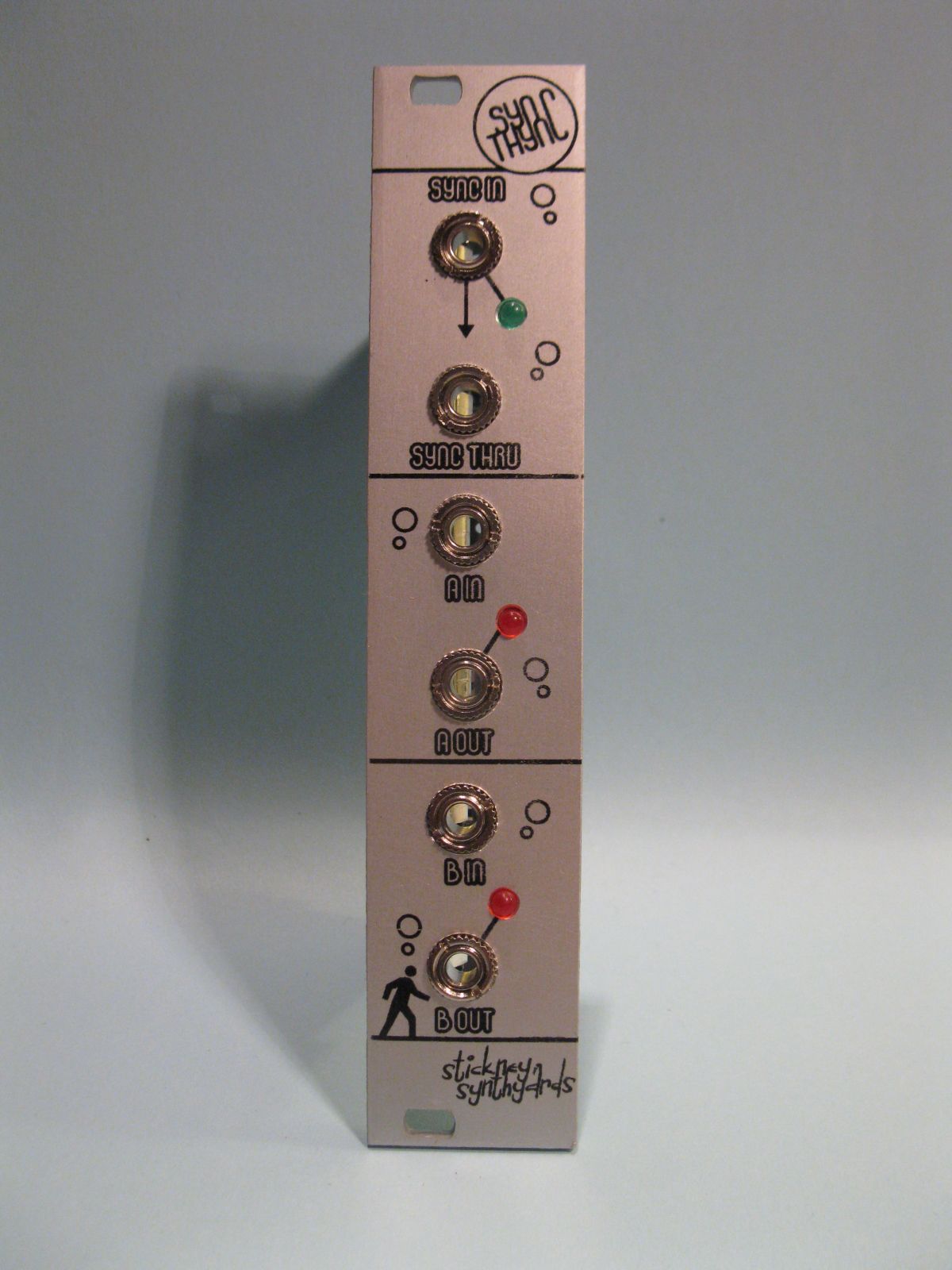

I made another eurorack module: The Sync Thync Euro Cool
ABOUT THE MAIN MODULE:
The Sync Thync Euro is a modified version of the original Sync Thync designed to be used as a euro-rack synth module. It's a bit of a cross between
a (1 bit) S&H and an AND gate and although its original purpose is to create interesting rhythms that are in sync with a master Clock, it can also
be used for other thyncs. When the SYNC INPUT goes high (> 0.6V) it samples whatever data is at the A/B INPUTS and this appears at the A/B OUTPUTS
as long as the SYNC INPUT is high. When the SYNC INPUT is low the A/B OUTPUTS are low aswell. Internally the module is digital and the A/B OUTPUTS
are 0/+5V gate signals, so it does not work as a standard analog sample and hold. However, there are comparators on all the inputs so any signal
can be used. A very simple patch to create interesting rhythms is to connect a Clock signal to the SYNC INPUT and connect LFO's to the A/B INPUTS.
The SYNC THRU OUTPUT is a buffered version of the SYNC INPUT (before the comparator). If for example you would plug a Clock signal into the SYNC
INPUT than a buffered version of this Clock signal is available on the SYNC THRU OUTPUT to control other modules.
There is a LINK connector available on the main board which is useful when more than one Sync Thync are used. SYNC THRU is the buffered version of
the SYNC INPUT (same as the SYNC THRU OUTPUT) and SYNC IN is normalized to the SYNC INPUT jack. If you put more than one Sync Thync behind a single
panel and connect SYNC THRU of the first to SYNC IN of the next (and so on) you can control them all with a single Sync signal. There is a GND pin
available in case you want to use shielded wire for this (only connect shielding to 1 side). There are also pads on the board to link power thru so
you'd still only need 1 power cable.
There are 3 mounting holes (2 on the main board, 1 on the expander board) that can be used to secure the PCB to a bracket or panel if you want to
use it for another (not euro-rack) synth format [*].

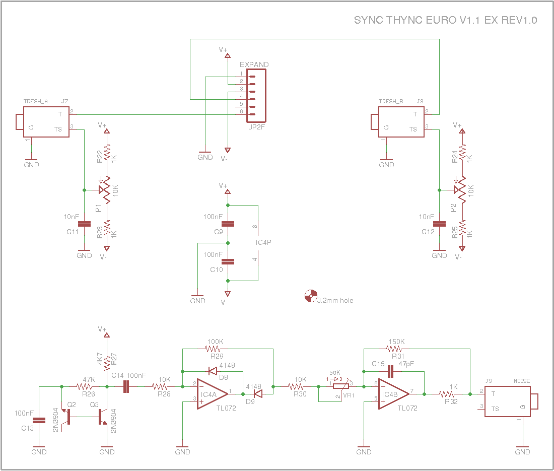

ABOUT THE EXPANDER:
The (optional) Sync Thync Euro Expander board adds adjustable (voltage controlled) TRESHOLD CONTROLS for the A/B INPUT comparators and it also has
a NOISE generator. This NOISE generator can be used as a random source for the A/B INPUTS and adjusting the treshold level will set the probability.
Of course the expander board requires a larger front panel so you don't have to use it and the Sync Thync will work fine without it.[**]
When nothing is connected to the A/B INPUTS the control voltage for the comparators is normalized to +2.5V. Without the expander board this will
cause the A/B outputs to be low/high in sync with the SYNC INPUT. If the expander is used then the A/B OUTPUTS can also be turned on/off by adjusting
the treshold levels. An external gate signal works well for this but it will work inverted. (gate high = outputs low, gate low = outputs in sync)
[**] If you don't use the expander board you will have to bridge TA with TC and TB with TC on the main PCB. You could use a pin header with some
jumpers or simply solder in some wires. (you could probably even bridge it with a solder blob although I don't recommend it). If you do use the
expander board you can leave out R21 and D7.
ABOUT THE CIRCUIT:
Both the 'S&H' and 'AND' function are created with a flip flop (IC1). The CLK input is used as the trigger for the 'S&H' and a low to high
transition on this input samples the D input and places it on the Q output. The trigger signal is derived from the SYNC INPUT and turned
into a short pulse by C8 and R11. For the 'AND' function the reset pin is used which is controlled by Q1. This transistor inverts the SYNC INPUT
signal so when the SYNC INPUT is low (< 0.6V) the flip flops get reset and the outputs are low.
The NOISE generator uses a reversed biased transistor (Q2) to create white noise and the signal is amplified by U4a and U4b. U4a also rectifies it
to create a positive only signal on the NOISE OUTPUT [***]. The amplitude can be adjusted with VR1. Note that a higher amplitude will give a larger
treshold range when the NOISE generator is connected to the A/B INPUTS.

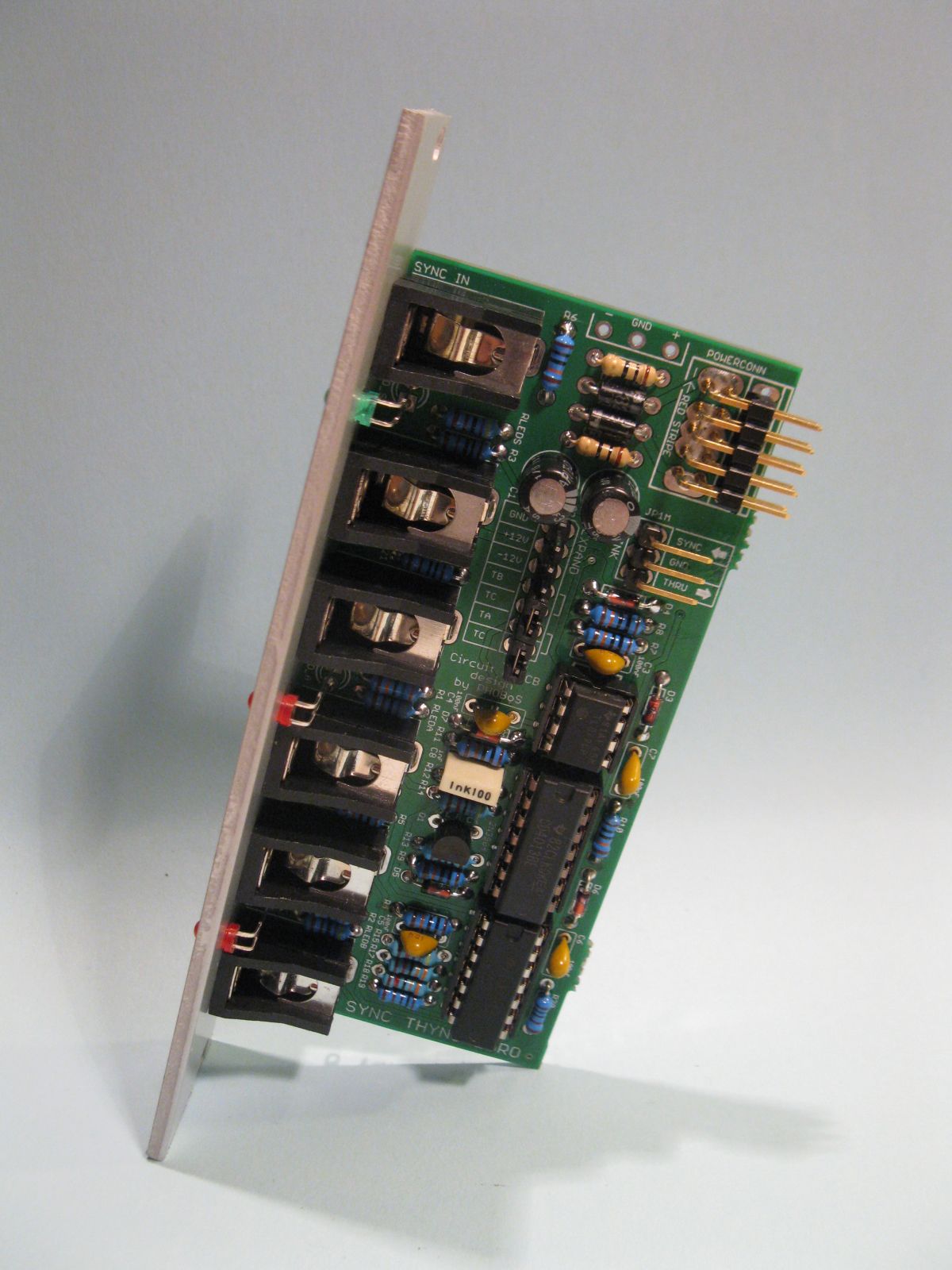

I haven't tested the expander yet (worked on breadboard) as I don't have the right pots so I just made a standard version and that works great.
I used a 4HP panel but I think it should just fit behind a 3HP (is that even a standard size ?). Note that if you use an angled connector for the
power (like I did) it should not be soldered flush with the PCB else the connector won't fit, this is something I'll change if I'd do another run
of PCBs. I might also replace the noise source with treshold control for the Sync input but I'm not sure about that yet.
