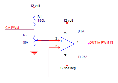

Anyone have experience?
Maybe a little late, but I ordered three AS3340 from Electric Druid and built three vco's with them based on the Memory Moog schematics.
All three oscillators have a CV and potmeter to the PWM input (see figure below).
Instead of using the auto-tune input I put a potmeter of 50k for fine tuning and one of the three 1 V/O inputs I placed a 50k potmeter between 12 volt and GND for coarse setting of the output frequency.
Also added a three position switch to two of the oscillators for soft/hard syncing (10NF to one of the inputs on pin 6 or 9).
For the third oscillator I added a switch which sets a capacitor of 10NF parallel to CF for LFO purposes.
Added for CV of PWM
