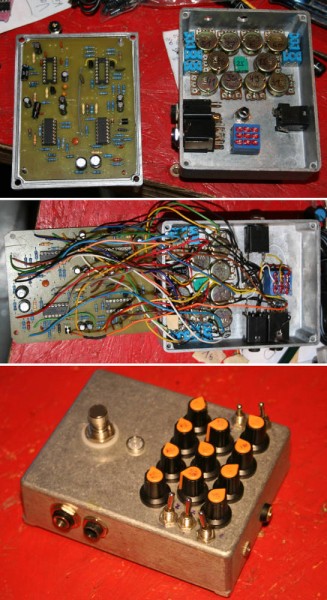

Oh daaaaamn, I finally figured it out!
In case anyone is still reading:
I rebuilt the VCF circuit on a breadboard and... it still didn't work. So I started checking for bad components. Since the semiconductors were very cheap components ordered from china, I swapped the LM13700 for another one I had built into a Ross Phaser pedal - no change.
Then I swapped the JFETs for a pair of original 2N5457 and it started oscillating!!
Long story short - support your local electronics supply store Wink
Beware of these ridiculously inexpensive MPF102 on ebay, apparently they're fakes:
https://www.ebay.co.uk/itm/263562163728
Attached are three pictures of the thing as I built it. I managed to cram everything into a 12x9cm enclosure to make a guitar stompbox out of it... no millimeter wasted there.
I also re-routed the PCB a bit to make it one-sided (for easier etching, I hate making double-sided PCBs) and made it a bit smaller to fit the enclosure.
I also added an expression pedal input to be able to alter delay time with a foot pedal I happened to have around.
It's such a fun device to play around with!

P.S.: In case you may wonder - I omitted the second CV input and the Line/Mic switch, as I'm sure I'd never have used them.
