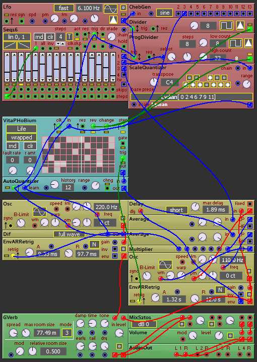

Here is an example patch maybe illustrating the previous remarks a bit (click on it to get a larger version). It uses three games of life, two running at audio rates for drone like sounds and the other one changing stuff and making a bit of percussion (one percussion thing being a modulation of the reverb time of a reverb circuit set to a small room size, the other uses noise burst driven trough a third-filter).
Edit: added a five minute audio recording from it.
Edit : added "click on it ..."
Game of lif patch example

Nice tune pho :-)

PostPosted: Fri May 03, 2019 1:38 pm    Post subject: Reply with quote  Mark this post and the followings unread
Aand then there is some .. ahum .. life Cool
[edit: there is an audio track below the image]
The red modules make a sequence for the the highest pitched osc (left column yellow), and some control signals for the life thingie (blue-green-ish).
The life thingie gets post quantized by the notes learned from the sequence, and it then controls the lower pitched osc (right column yellow).
Then some reverb and leveling (green).
The red progdivider makes the life thingie readout turn direction from time to time.
The low notes can go three times as fast as the high sequenced notes (red ChebGen module does the rate multiplication).
So I can now go on reading what ideas PHOBoS had added Laughing

PostPosted: Fri May 03, 2019 4:39 pm    Post subject: Reply with quote  Mark this post and the followings unread
sounds like that's working Very Happy
I have a feature with multiplications of 2 (1x,2x,4x,8x,16x,..) or actually they are divisions. The multiplication factor is picked
at random and the range can be adjusted with a knob. So depending on the setting of the knob it will pick from [1x] (fully CCW),
[1x, 2x], [1x, 2x, 4x] etc..
ChebGen made me think of Chebyshev which made me think that multiplication could be made frequency dependend.
