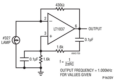

PostPosted: Fri May 17, 2019 9:22 pm    Post subject: Reply with quote  Mark this post and the followings unread
Ty for the comments, also for the link. I used to be in such a hurry that I would not take the time to follow links and actually listen to the music of my friends. That was a mistake.
I enjoyed Howard's music well enough to call it inspiring because with only two oscillators a lot of different sounds were created. I was thinking of a similar idea. Take a look at the schematic of the Wien Bridge Oscillator (attached).
My plan is to lift up the ground terminals on the inverting and non-inverting sides and connect outputs from other oscillators in some creative way. Ideas for how to do so are forming now.
At the moment I have built an LM386 oscillator driving a small breadboard-friendly speaker, tested and working by mimicking a switch's "click" noise from silent to full volume, USB power input, and just beginning on the oscillators by creating a virtual ground.
Lets cross our fingers and hope for good luck!

PostPosted: Wed Jun 26, 2019 3:57 am    Post subject: Reply with quote  Mark this post and the followings unread
It's a lamp, yes. I'm not sure if it's neon or incandescent or whatever else a lamp can be. I got it from Digi-Key. I'm not sure if it's the right lamp for the job and some kids claim to have damaged half of my stock of 10 lamps including this one. The kids are pranksters. Grrr but not that much!
This lamp reads 100 Ohms when off. I heard it mentioned that sometimes the lamp glowed and other times it did not glow in this application, dependent on the setup. Or it can glow below the visible threshold in daylight and room lighting.
The way it works is the lamp has a positive temperature coefficient meaning that when it heats up it gets higher in resistance. So what happens is the amp starts out with harmonics in it's spectrum then the lamp warms up from all the signal applied to it and this causes the gain of the lamp to lower then the reverse happens, etc. (or the other way around, anyway it stabilizes). This creates a clean sine wave.
When I play with it I see signs of this happening by tuning the lamp so that harmonics exist up and down the AM dial. Then when I tune the feedback resistor (I make it a 10k Ohm pot) I notice the effect. In no case do I not notice the feedback. I think this is because the trimmer pots I am using are 10k Ohms and the resistor is 100 Ohms, so I plan to use a smaller resistor parallel with the pot to get more sensitivity. That or get a 1k Ohm or 100 Ohm pot.
Anyway, it's really fun to play with and the goal is worth the effort. Stay tuned!

I just wanted to make note of the purpose here and good intentions at this point. I made an LM386 circuit with a speaker and it worked pretty well. I could adjust amplitude and hear it well. It required lots of breadboard space and a big rat's nest of wires (I used jumpers instead of the neat freak technique). This worked out OK.
Then we have the simple opamp voltage follower driving a 3.5mm or 1/2 inch jack (or both for widest possible compatibility). That's OK too.
Then I got to thinking and it occurred to me that If I used an AM/FM radio as the output device, then I get hearing quality output from the board into speaker(s), headphone jack output also, and all manner of adjustments if purchased such as filtering, on/off button, volume control, etc. This I called the Mr. Microphone approach after the early 1980's product.
So basically I'm planning to try the Mr. Microphone approach! This is good for the final circuit and also for test and design because it should be easy to tap a signal on the board with a voltage follower driving some simple circuit adjustment and get both test signals and final output signal as required.

Have you tried connecting the GND to actually earth ?
Not sure if that would make much of a difference and it's not very practical but maybe worth a try.
Also came across this which actually looks more like FM to me.

Maybe not a 'real ground' but things could improve from using a metal plate connected to the circuit ground. A guy at work recently stressed on using ground planes ... sooo ... anyways .. I found http://www.csgnetwork.com/antennagpcalc.html when googling for: minimum ground plane size
