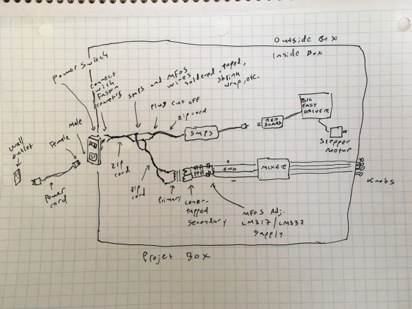

Thank you both again! I agree that building a SMPS is not a good idea. But I think a see a Plan taking shape, based on your advice. It involves using the SMPS I am currently using.
1. Build the MFOS Wall Wart Power Supply
2. Buy one of these or similar: https://www.amazon.com/dp/B01C7OE868/?coliid=I195ASGHQ2L9FM&colid=1F32SLWJVP2SL&psc=1&ref_=lv_ov_lig_dp_it
3. Buy one of these or similar: https://www.amazon.com/dp/B078N95379/?coliid=I17W0LLVXHB1YE&colid=1F32SLWJVP2SL&psc=1&ref_=lv_ov_lig_dp_it
4. Cut the single "prong head" off the "cable leader" in step 2. Separate the wires.
5. Mount the switch from step 3 to my project case.
6. Solder the exposed wires from where the prong head was to the switch, so the two sockets are inside my case.
7. Mount the MFOS WWPS and the store-bought SMPS that I am currently using into my project case, ensuring adequate ventilation.
8. Plug the MFOS WWPS and the SMPS into the "cable leader" receptacles.
9. Use one of these to connect between the switch socket and the wall: https://www.amazon.com/dp/B00FBA1UHG/?coliid=I32UQ4G42YP3S1&colid=1F32SLWJVP2SL&psc=1&ref_=lv_ov_lig_dp_it
I am a bit nervous about steps 4 and 6, but is this the general idea?
Posts: 24382
Audio files: 296
PostPosted: Sun Aug 18, 2019 8:31 am    Post subject: Reply with quote  Mark this post and the followings unread
Genral idea will work.
add step 10 (or a little earlier better :-) ):
re 4. and 6. and so, use shrink wrap tubing over the solder connections of the mains wires, and make it so that the mains wires can't move anywhere even when a single failure occurs (like a not-so-good solder connection comming loose, or the device falling down from some height, stuff like that) - tie wraps may work well for that.
add step 11:
In the hand drawn schematic above, on the secondary sides of the supplies: connect '-' of PSU1 to 'GND' of PSU2 close to the PSU's (or otherwise they'll either float with regard to each other or there will be a ground connection anyway trough other connection not drawn but in a less defined way).
Posts: 5783
Audio files: 708
PostPosted: Sun Aug 18, 2019 10:49 am    Post subject: Reply with quote  Mark this post and the followings unread
step 6: I'd use (insulated) faston/crimp connectors instead of soldering which is what those switches are designed for. Soldering directly to the
switch requires quite a bit of heat which could potentially damage it (depends a bit on the quality). You could also solder to those connectors
instead of crimping on the wires, but it can be a bit tricky.
step 8: not exactly sure how you are planning to do that. Those aren't mains sockets. I mean voltage wise yes but you can't plug something
like a wallwart in them. There might be cables for that purpose available though.
and yes, make sure everything is properly secured.

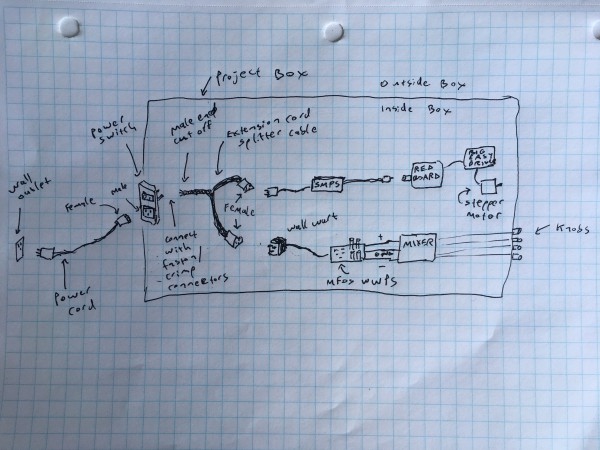

Hey PHOBoS,
Maybe I misunderstood... I thought step 8 was essentially the crux of your suggestion.
Rather than have two power cords dangling off the back of my project, mount a mini split extension cord inside the project box. Wire one end to a switch, and plug both the MFOS wall wart bipolar power supply and the store-bought SMPS in to the female ends of the split extension cord (inside the box).
I have attached a drawing, which I hope makes sense.
If this isn't what you meant please let me know. If it is, then I have an additional idea I'll run by you.
 Filesize:  2.38 MB
 Viewed:  321 Time(s)

PostPosted: Tue Aug 20, 2019 5:07 am    Post subject: Reply with quote  Mark this post and the followings unread
It's not that the idea is bad but I highly doubt you will be able to find a wallwart with a 'IEC-320' connector.
I think what you'd need is a 'nema 5-15' connector which looks a bit similar but is something else.
There are probably splitter cables for those, let's see,..
this should work https://www.amazon.com/Pro-Techgroup-Premium-14AWG-Outlet-Splitter/dp/B002MGT72C
at least if that is indeed the type of mains connector you use.
nice drawing btw Very Happy

However.... I did want to see if this simplification would work. I have attached another drawing.
This plan would use the MFOS Adj. LM317/LM337 power supply: http://musicfromouterspace.com/forums.html?MAINTAB=SYNTHDIY&PROJARG=POWERSUPPLY2009/POWERSUPPLY2009.php&VPW=2358&VPH=1053
Here are the steps:
1. Build the MFOS Adj. LM317/LM337 power supply.
2. Cut the plug off the store-bought SMPS.
3. Solder zip cord to the primary of the MFOS supply.
4. Solder the positive and ground of the SMPS supply and the MFOS supply together.
5. Connect the junctions of the MFOS and SMPS to zip cord. Tape and shrink tube everything.
6. Connect the zip cord to switch using faston / crimp connectors. Tape and shrink tube.
This is a bit more challenging, but it is essentially the same as the previous plan but with fewer parts, correct? Is this closer to how things are usually done when one project has multiple power requirements?
Thanks for your help!

LM317/LM337 supply with an actual center-tapped transformer is an improvement over the standard wallwart supply
but does require you to wire up a transformer. A toroidal type might be the safest to use and easy to mount with the
correct hardware.
Only connect the GND together, at least if you want the mixer to be connected in some way to the stepper circuit otherwise
you don't need to connect anything together.
For the rest that should all work.
Thanks PHOBoS.... the stepper and the mixer do not need to interact. I just want them to turn on together. Don't both grounds and both hot wires need to connect at the back of the switch? I was thinking I would solder the grounds together and put a faston crimp on the resulting joined wires to connect to the switch. Then do the same for the hot wires. Maybe you are saying I can just put the two ground wires in one faston connector and the two hot wires in another faston connector, and not solder them at all? Just attach the two faston crimps to the switch?
Speaking of the switch, many of these inlet modules come with a 5A fuse. Will that be enough headroom considering the stepper wants 3 or 4 amps, and my SMPS is 12V, 5A? https://www.amazon.com/gp/product/B073QTNF9F/ref=ppx_yo_dt_b_search_asin_title?ie=UTF8&psc=1
Could I swap out the fuse in the switch for maybe a 6A or 8A? https://www.amazon.com/Ginsco-110pcs-5x20mm-Quick-Assorted/dp/B01CEB6B1Y/ref=sr_1_27?keywords=10A+fuse+20+x+5&qid=1566914219&s=gateway&sr=8-27
Or find a switch with a 10A fuse?
I am moving ahead with the simpler / safer method of the splitter cable and wall wart power supply, but I'd like to understand the points above for the next iteration. Thank you!
ah I think it's just a confusion because of terminology. Seems like you are talking about the mains side in which case you have a live and a neutral
connection. And an earth but you only need to connect that to any metal parts that could be touched (if there are any). At least your SMPS doesn't
appear to have a connection for earth. So yes, the neutral wires are connected together and to the mains input connector, and the live wires are
connected together and to the switch. Unless it is a double pole switch, which I doubt, then you can switch both live and neutral.
The fuse is probably even too large. The current you are talking about is on the secondary side, the current on the primary side will be much lower.
What stays the same is the power (Watts) although it's of course not 100% efficient so it will need more power than it puts out (in electricity).
If the SMPS is rated for 5A that's a total power of 5A x 12V = 60Watts. Since you seem to be in the US I assume the mains voltage is 120V so
60Watts / 120V = 0.5A. Of course 12V happens to be 1/10th of 120V so the current is also 1/10th. It's not completely accurate as you are not
dealing with a purely resistive load but it gives you an estimate. A 630mA fuse might just do it, you are not using it for its full 5A anyway. There could
be an inrush current that is too high for it so I would at least use a slow blow type fuse.

[quote="PHOBoS"]
Oddly enough this particular switch does say it's a DPST: https://www.amazon.com/gp/product/B078N95379/ref=ox_sc_act_title_3?smid=AVKVKSQRPUCTR&psc=1
Does that change things? Will these instructions work? https://www.instructables.com/id/Wire-Up-a-Fused-AC-Male-Power-Socket/
I just wasn't sure what to do with the green ground connection between the load and the switch.
Posts: 5783
Audio files: 708
PostPosted: Wed Aug 28, 2019 8:49 am    Post subject: Reply with quote  Mark this post and the followings unread
ah I see, great. I was actually expecting the switch to be 'pre-wired' just like the fuse is, but this makes it more versatile.
Yes, those instructions are correct.
