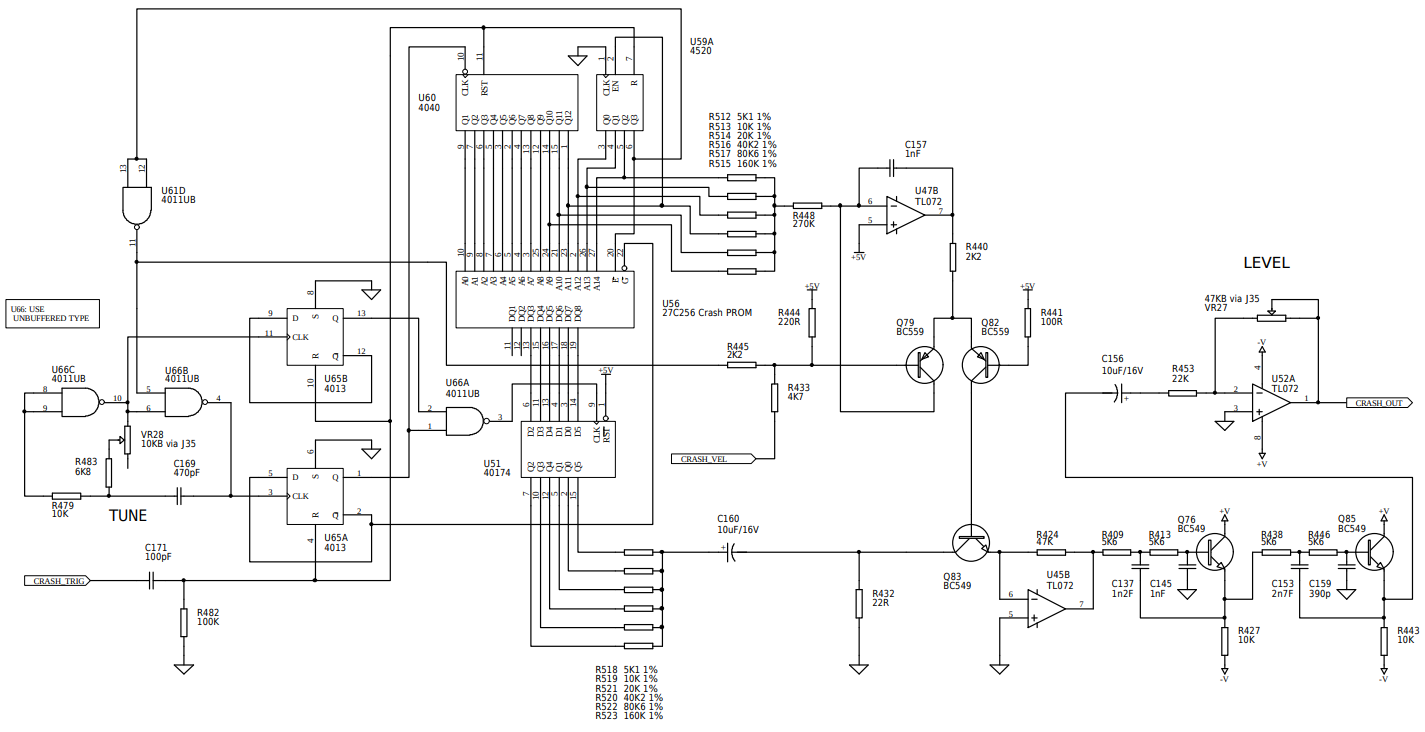

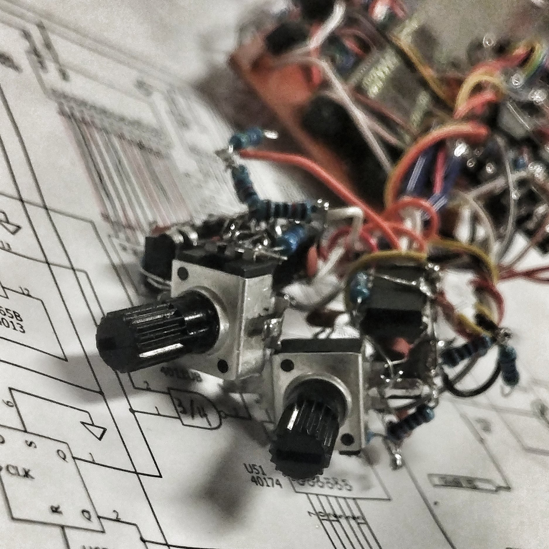

I'm undertaking the daunting task of building the three TR909 sampled voices using a blend of protoboard and point to point. It's a daunting task.
The schematics I'm using are here -- thank you very much, Trevor!!!
Questions:
What is the "CRASH VEL" input? A CV, I assume, but what voltage range?
Do all the ICs get +5V and ground, except the op amps which get +/-15?
Other question, on the rhetorical tip: am I completely insane?!!!???!?!?

An artsy shot of two of the clock generators
That would be my guess, yes. (Q76, Q85 also seem to be connected to +/- 15V)
The velocity voltages are constructed on the midi board and the diagram is somewhat the same as the schematic parts for the actual crash voltage: a 40174 with a number of resistors forming a dac, so it’s safe to assume that these cv’es go from 0 volt to about 13.5 volt (the max. output voltage is typ. 13.5 volt for a TL074 powered from +-15 volt)

Trevor Page, the creator of the 9090 project and very attentive manager of the 9090 Facebook group, says that the VEL INP is a CV from 0 to 5V, which makes sense -- it's going into a part of the circuit that's running on five volts.

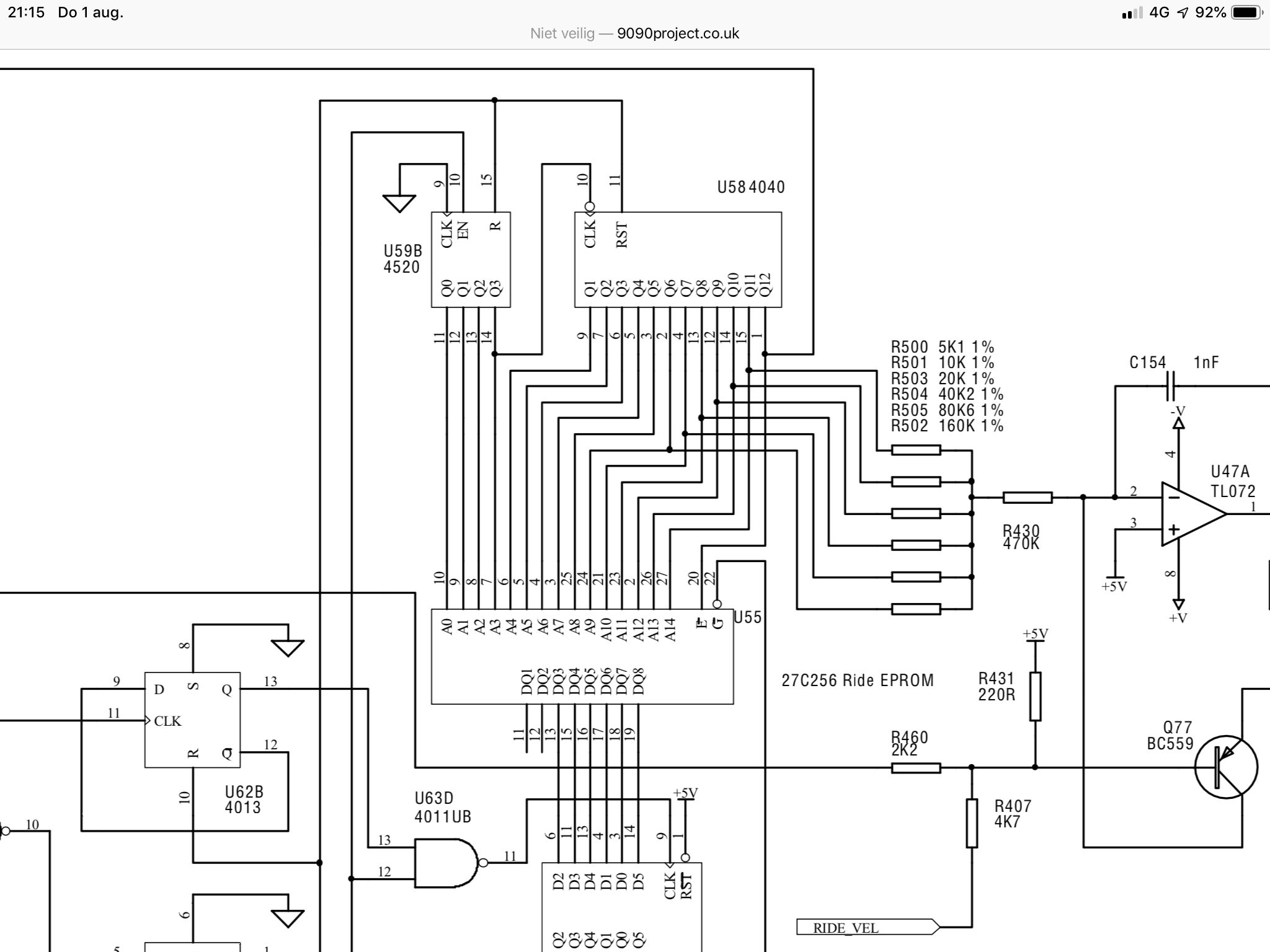

I just keep wondering why the address generation for the (e)proms of the crash and ride modules is different thinking
And why R448 is different from R430 (270k vs 470k)

It might have to do with the PCB layout, I think it is functionally the same.
Not sure if the resistors just control the level but maybe one sound is much shorter (decay)
as the other so by making it louder they'll sound about the same.

I bet it's because the 4520 is a dual four-bit counter, so the crash and ride voices use that one IC. I thought about using just one for my pair of voices, but I don't have plans for all my 4520s (cheaper from AE in lots of 10!!!), so I just used a fresh one in each voice build.
The ride sounds just fine with the 270K resistor for the envelope generator... I have a trimmers to adjust the sound levels of the two voices (one volume knob to save panel space) so if it's a level issue, it'll work out.
That makes total sence, should be it.
Maybe it’s just a minor error made by the designer or person who made the schematics, anyway you have sorted it thumb up
