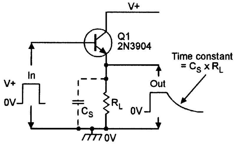

I think I misunderstood--you'd configure it like this image--with a square wave input to a transistor, then using an RC circuit, convert the square wave to a (more or less) triangle wave.

If you just want a buffer you would leave the capacitor out and you would get an output waveform identical to the input.
Adding the capacitor in gives the decaying edge which might be something interesting for a drone box.

Just a quick note... the triangle out will be lower in volume than the square. The triangle stretches in voltage only to where the 40106 flips, ie the lowest point of your triangle will be ~1/3rd of the supply voltage and the highest ~2/3rds. If you want the triangle to be at the same output level, you'll need a bit of amplification, not just a buffer.

Even amplifying the triangle wave to full peak voltage it is still going to be lower volume than the square wave (it has less area under the curve). Because you want the square wave at full volume for logic operations most people seem to ignore the difference and compensate for it in the mixer settings.

Yes, sorry, I should have phrased that differently. If you want at least a somewhat similar peak to peak voltage, you'd need to amplify the triangle. I.ve amplified mine as I'm personally trying to make sure the output of any given module can be run into the input of any given module and have it still "work" (CMOS doesn't like non-square/pulse inputs, so "work" is subjective). If you'll use it solely for audio or don't mind the limited swing, a buffer is fine.
