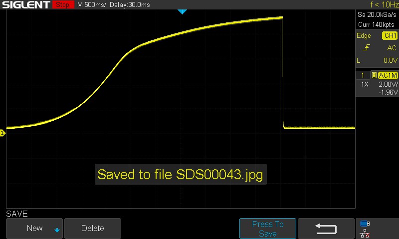

My ADSR is misbehaving and the main issue I have is that even at Attack in the min position on the 1Meg Pot, the actual attack is way too long, so I cannot get a short attack at all.
Initially, I tested with a Sequencer sending Gate to it and thought it wasn't working at all.
However, on testing tonight with the Gate push button, I noticed that it was actually working to some degree and that's a relief, but the attack takes time to go to max amplitude. Hence I wasn't able to hear the ADSR working on a fast sequence when sending a Gate to the input.
I checked Release and that seems to be working well. You can see the min Release in the attached pic, and it the sound does linger on when I increase it. I am not so sure about Decay and Sustain working properly.
Any idea where I should start looking to troubleshoot the attack issue?
Power checked all right at +/- 12V.
Long Attack.

could you post a link to the corresponding schematic?

It's the Yusynth ADSR, the latest version.

Diode D3 connected in the right direction?

Hi Grumble. Yep, Diode D3 checked out all right, black stripe on top.
I chose the 'fast' ADSR configuration for mine. Jumper wires are set accordingly.

Where did you measure the signal shown in your picture?
You should measure it at the output of U2a at pin 1, because if you measure it over the capacitor that is responsible for the rise and decay time of your adsr (C4a) you have a resistor of probably 1Mohm in parallel with this capacitor (the probe impedance)

Simply at the Output.
Will make another one at the chip out as you recommended. Thanks.

Did you put a CMOS 7555?
I had similar issues till I realized I used a simple N555

Check for a solder bridge near D3. Also, does the attack vary with different settings of decay and release? Also, how does the position of fast vs slow work? Check the polarity on C4a.

IIRC, it's a CMOS 555, from the set I ordered to build the Thomas Henry VCO-555 which requires one. Will double-check just in case.

Very helpful pointers, @kkissinger, will check all these.
