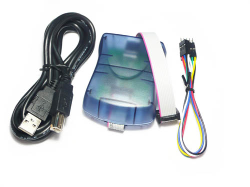

Posts: 1320
PostPosted: Thu Dec 24, 2020 9:18 am    Post subject: Reply with quote  Mark this post and the followings unread
do you get some kind of error message or does it just try to upload and then nothing happens and it keeps stuck on uploading ?
I've had that before but I think my solution was just to switch from windows to linux or the other way around. I guess that's not very helpful.
I’ve had this problem many times, didn’t bother with bootloading but turned to using Atmel studio using an external programmer avr isp2
 Filesize:  44.6 KB
 Viewed:  6149 Time(s)
my synth
