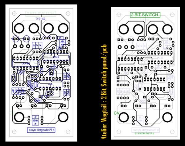

PostPosted: Sat Mar 05, 2022 7:20 pm    Post subject: Reply with quote  Mark this post and the followings unread
I did a 2 bit switch with a CD4532, TL074 and a DG409 in my 100mm standard.
Passes 4>1 or 1>4 under the control of a 4532 without clocking.
Something nice about unclocked LED indication!

piedwagtail
Joined: Apr 15, 2006
Posts: 297
Location: shoreditch
PostPosted: Sun Mar 06, 2022 9:44 am    Post subject: Reply with quote  Mark this post and the followings unread
as mentioned R
