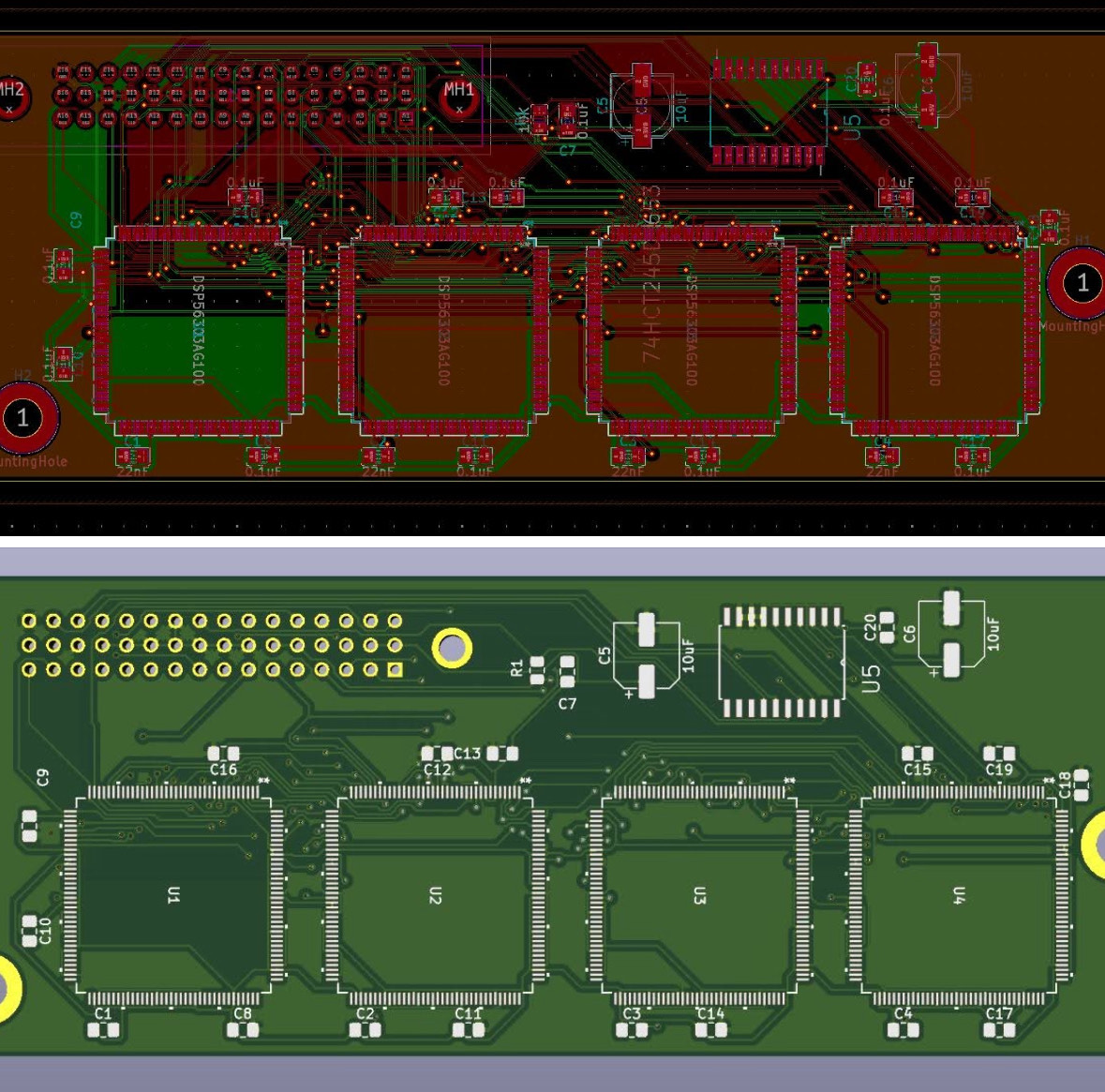

All,
I read about this in the G1 Nord Modular Facebook Group (there are several
G1 & G2 groups on Facebook).

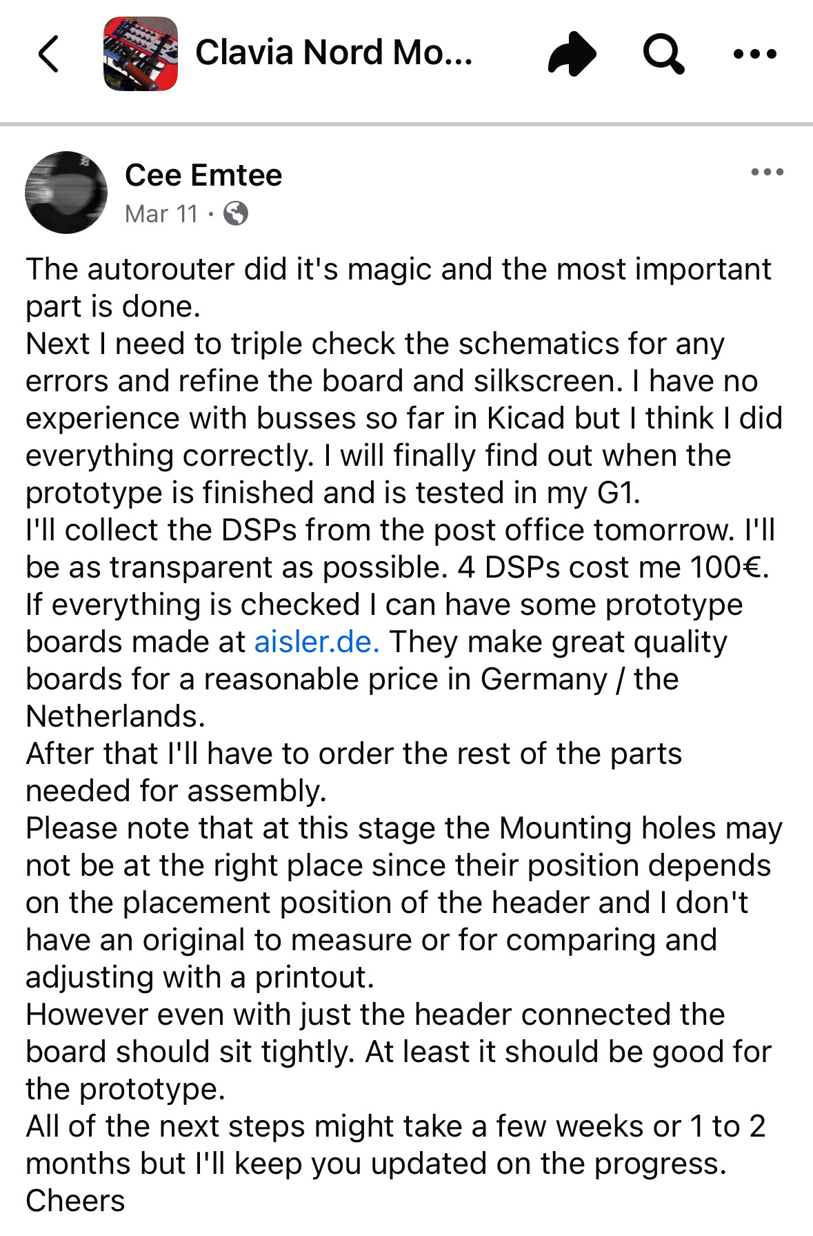

Everything I know about this board and its creator are in the attached screenshots.
Given that the creator said 4 DSPs cost him 100E at the time of his posting (the costs could always change), that should tell you that the finished product could be at least that much. Additional parts are needed as are fab & assembly costs, not to mention shipping.
I am not associated with this project in any way, I'm just relaying the information. If you have ANY QUESTIONS, join that Facebook group and message the creator directly.
Facebook posting about G1 expansion board - not the author/creator's name. If you have any questions contact
that person.
 Filesize:  461.33 KB
 Viewed:  161 Time(s)
PCB front/back
