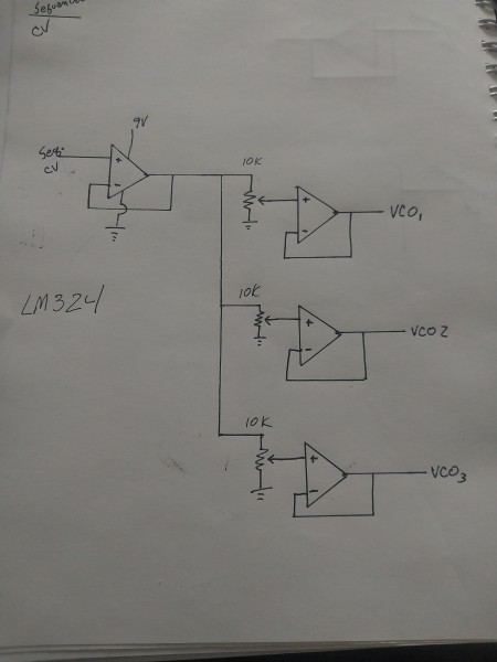

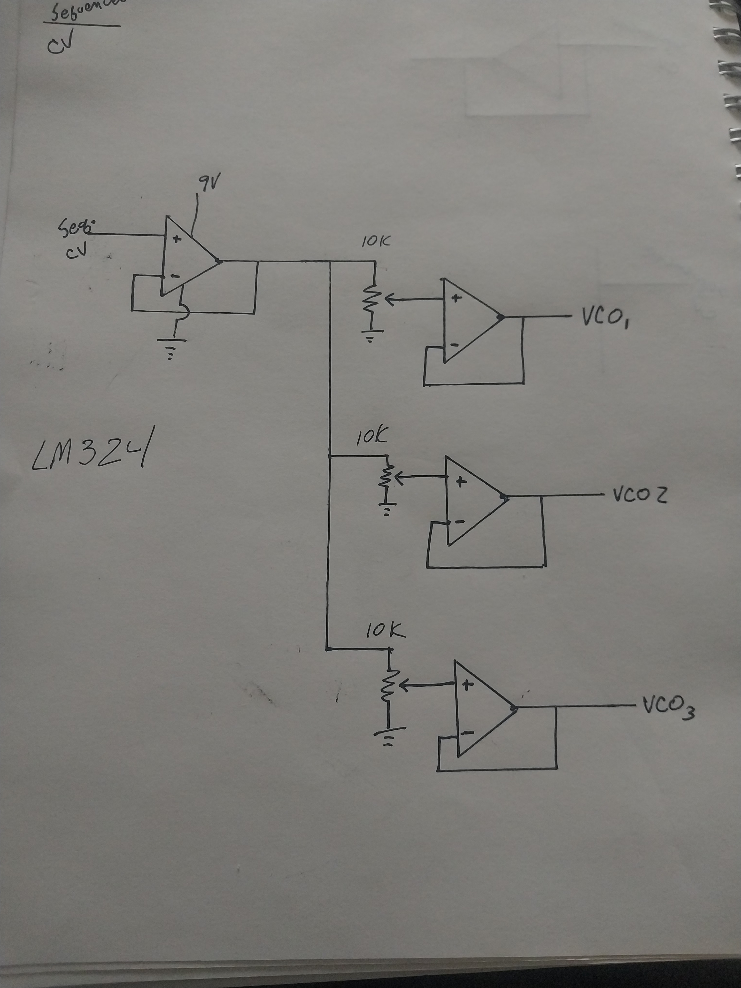

I've spent the past weeks building a kind of drone-synth. It has 3 555 based and 3 4046 based VCOs. The device is set up with the VCOs switchabe, so that 3 of them feed 3 NAND gates. The individual oscillators all work, and the wiring so far seems good (ie, selector switches for 555/4046).
I'm trying to figure out a way to take my sequencer output and use it to drive all 3 VCO inputs. While I was digging around for answers, I stumbled upon a schematic for a Synthrotek Sequence 8. It boasts 3 CV outputs, each with limiter pots, so each CV can be different. They used a TLV274, but it was configured like my crude drawing here.
I was wondering if I could use the same trick, but with an LM324 quad op amp. Use 1 non-inverting input to drive 3 non-inverting inputs (all set up as unity gain)? It seems to me it should work alright.
The Synthrotek schematic had the limiter pots in front of the op amp stages (as in my drawing), but I was curious why they are in front of, and not after, the op-amp stages.

PostPosted: Mon Apr 14, 2025 1:07 pm    Post subject: Reply with quote  Mark this post and the followings unread
yep, that should work.

PostPosted: Mon Apr 14, 2025 1:49 pm    Post subject: Reply with quote  Mark this post and the followings unread
Dr. K wrote:
Any thoughts as to why the limiter pots are placed before the op-amps rather than after?
I think that it is so that those pots don't interfere with whatever they are connected to. The opamps are acting as a buffer to isolate that part of the circuit from the next part.

PostPosted: Mon Apr 14, 2025 1:54 pm    Post subject: Reply with quote  Mark this post and the followings unread
Ah, I see. the first op-amp stage isolates the sequencer from the everything down stream. Then the voltage modifications are made with the pots, and the next op amp stage isolates all down stream oscillators.

PostPosted: Mon Apr 14, 2025 8:11 pm    Post subject: Reply with quote  Mark this post and the followings unread
Yes - that is exactly what is happening in that schematic.

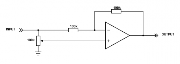

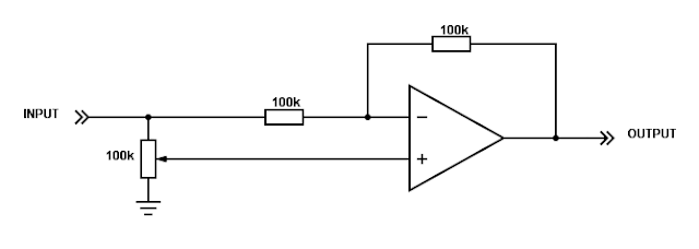

PostPosted: Fri Apr 18, 2025 4:06 am    Post subject: Reply with quote  Mark this post and the followings unread
For the right three opamps I'd use three attennuverters so you can have a volume setting and invert the signal with the same potentiometer

PostPosted: Sun Apr 20, 2025 5:08 am    Post subject: Reply with quote  Mark this post and the followings unread
Thank you for the schematic. I'm trying to study up and learn op-amp circuits. Can you tell me what the benefit of using the inverting input would be?
It also brings up another question. I've seen op-amp circuits set up for unity gain that didn't use resistors in the input or feedback (ie, wired with R~0), or also with resistors of the same value. Why are they sometimes used and sometimes not?
thanks again for the idea.
Posts: 1320
PostPosted: Sun Apr 20, 2025 11:55 am    Post subject: Reply with quote  Mark this post and the followings unread
If you go here:
https://www.falstad.com/circuit/circuitjs.html
You can build circuits and test them out, so you can play with resistor values etc.
That said: The attennuverter is a very smart circuit, with the potmeter you can change the gain from -1x to 1x using this circuit:
https://tinyurl.com/22gn53yd
Why do some unity gain circuits use resistors and others not:
If you have a circuit where the source is connected to the + input and the -input is connected to the output, then the load as seen from the source is very high impedance, as high as the datasheet says (not seldom >100Megohm) but not all opamps are good in unity gain connected this way...
Check this out:
http://sim.okawa-denshi.jp/en/opampkeisan.htm
But you are low in component count, thus cheaper.
So if they use a circuit where from the -input of the opamp there are two resistors with the same value connected to the output and the other to gnd, there the source is connected to the +input of the opamp and also the input impedance seen from the source is very high.
Sometimes there is also a resistor connected between the source and the +input to compensate for temperature variations and keep the common mode rejection ratio (CMRR) high.
Another benefit connecting the opamp in unity gain this way is that you can place a capacitor in parallel with the resistor going from -input to output thus creating a filter (high cut-off).
And.... the gain is 2x
If you change position of the gnd and source, you have unity gain, but the signal is inverted... I wonder... is this still unity gain??
