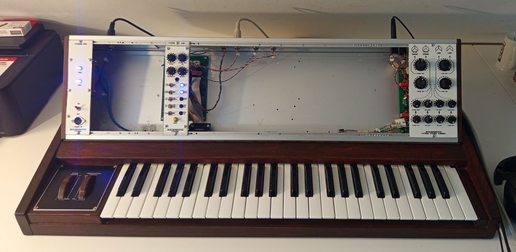

Hello everyone,
after completion of my Oberheim SEM Clone activities I started with a keyboard synthesizer project, the TyCoon, a Synton Syrinx inspired synthesizer.
The first idea was to build a clone, but then I decided to keep the Syrinx architecture just in general, but with some enhancements, gadgets and additional stuff.
Not knowing how far I will come with that, I will show the steps and achievements of analysing the original, the famous Synton Syrinx, the specials and technical details and how far I got in cloning and reverse engineering them.
Part 1 that I completed was the keyboard interface. And that was already a point where I deviated from the Syrinx: See Build Pictures 2025 for details.

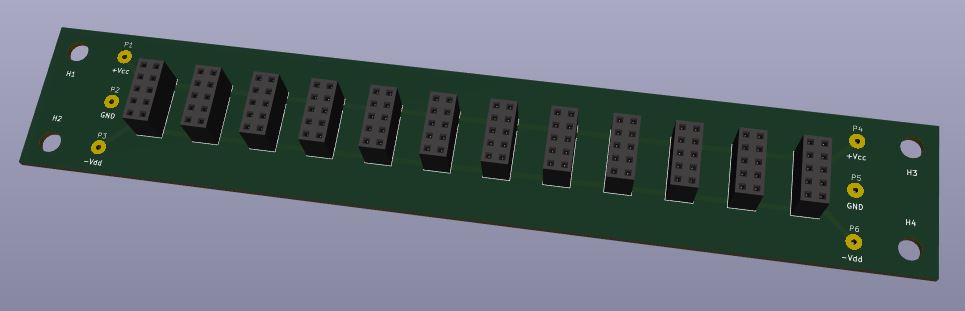

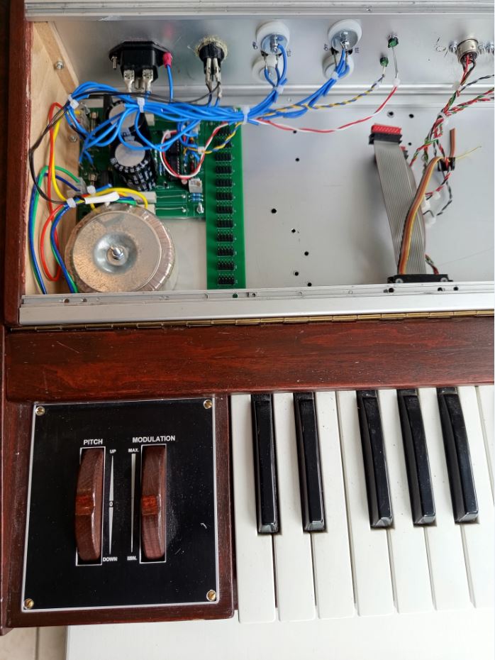

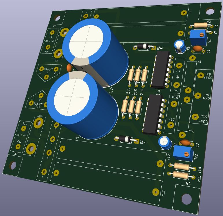

I decided to replace the power distributor of the external power supply by a real PSU, old school, with a toroidal transformer and two ua723 regulators pimped with 2n3055 transistors.
Regulator
Power Terminals
