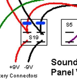

All right i got my SL together last night and manged to get some good sound s out of it althought there is still a bit of tinkering ahead of me...
I am confused about the connections on S19 (power switch) from the look of the wiring diagram it looks like all 6 pins are wired with 2 of them bridged together... Could someone clarify what connections go where? The way I have it wired it is always on regardless of switch position...
Also is the SL suppose to generat audio on it's own or does it require a CV and Gate to generate audio? I hooked up a Roland MC4 sequencer to the gate and OSC1 cv input and not much happened...
Anyway appreciate some input on the switch wiring....
Hi and welcome cosmosuave
just ignore the upper pins (marked blue). use only four pins of six
and you will figure out how it is.
hope tihs helps
daniel
