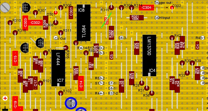

Here it is.
I haven't built it yet, but I have double checked it.
The pic of the whole board is too big so I've just included the new bits in the corner. No original parts, links or cuts have been changed. The designators are as per Ray's schematic +300. I'd like to update the whole layout later, but this is for people who have already made the original.
Be extra careful to find all the new cuts. Note also the 3 weird jumpers. 2 are diagonal, one of which goes into the same hole as a lead on one of the MPF102s. The other crosses over one of the new diodes. The third is on the back of the board.
Please let me know how successful it is to implement. I might add it to mine as well just to use up the space (and everyone needs an extra S&H)
Have fun.
Andrew

PostPosted: Sun Oct 23, 2005 10:42 pm    Post subject: Reply with quote  Mark this post and the followings unread
Here's the cutting guide.

PostPosted: Mon Oct 24, 2005 12:36 am    Post subject: Reply with quote  Mark this post and the followings unread
Unkle-K, yr a genius :D
Many, many thanks! I'll be studying this more closely today (while at Uni).
Tom
