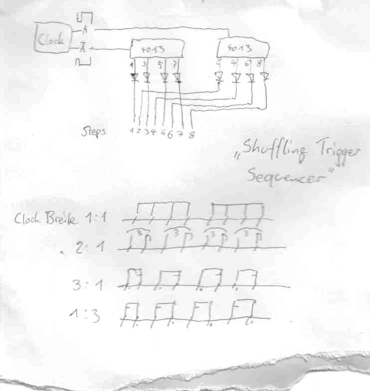

Frank has made a nice stepsequencer and has included a stripboardlayout. He´s a good guy! (I read the other thread and thought to open one especially about the 4017 sequencer.
I had this idea once to clock two trigger sequencers, one with the positive ,one with the negative edge (inverter) of a pulsewave. by changing the pulsewidth you could change the swing of the sequence. I guess this only works with the 4017 setup as a trigger sequencer, giving short pulses, otherwise the two would overlap.
But the big question is: How can i get a steady pulse from my midi-clock device to become a variable pulsewave (with maybe half the freq)?

I would probably put it through a divider (flip-flop) and then into a one-shot which had a variable length (555 timer). A one-shot is also known as a monostable multivibrator.

I thought of that. But the output pulse would than have a fixed length. Changing the speed of the Clock would result in changing the pulsewidth.
At fast speeds the timing poti (scaling) would have to be set in the lowest range, at slow speeds it might not be abel to give a long enough pulse even if you turn the controll to the far right.
I´m imagining a circuit that aplies variable pulthwidth at any incomming clock signal. I´m shure that the output will have to ba at half speed, as no circuit can look ahead at what is going to happen. It must be possible somhow. Aren´t there comercial Drummachines with Swingcontroll?
hey what about a 'fixed' integrator with clocked reset to a comparator? at high frequencies [resetting faster] the amplitude at reset would be lower than it would be at low frequencies.. i.e. less or more time that the comparator is high [or low or whatever].
this is one solution perhaps?

There's also a variation on the 555 astable/monostable circuit which charges through one diode/resistor and discharges through another diode/resistor. This way you get complete control of the duty cycle and you can also add an overall frequency pot.
I´m afraid i don´t understand - at all. my knowlege in electronic basiscs is limitded like lenny kravitz´s voice. (in his case i like it).
I recently build my clockprocessor that can controll all my modules and add swingfeel. I used the aproach i first thought of, a 4047 monostable vibrator is beeing triggered by the clock. A pot and a cab define the pulsewidth. The 4047 brings it own inverted output, so i just have to form q and q- into short pulses and or them together. the oring is done in each device (sequencers, s/h, etc) via swiches and diodes (use a pulldown r) so that i can have downbats, offs or both. This is always followed by on divide by 1-10 (4017) which makes it realy interessting. Works.
There still is the problem with changing the clock speed.
2 things about that:
1. If i realy want to use a modulated clock this thing is useless (in the meaning of fixed swing feel- results may be interesting anyhow).
2. more often the clockspeed will not be modulated. for different ranges i can swith in different cabs, so one pot gives controll over very short to very long delay.
The nice thing in reality is what i thought would be the problem of this method. (´s often like that, isn´t it). When the pulsewidth of the 4047 gets longer than the clock you get a divide by kind of thing. this resullts in one long note (more than one beat) and a short one. This gives you the typical samba pattern for example.
