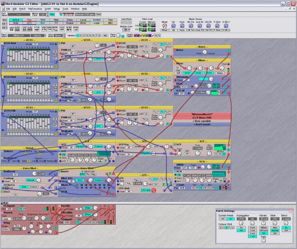

MMG2 ("MemoryMooG2") is an attempt at emulating Moog's classic polysynth Memorymoog.
Background
I got tired of constant worries about my old analog equipment breaking down. The noise from my Memorymoog's internal fan was irritating. However, there were a few of my own patches that I wanted to keep. So a few years ago I started looking for a Memorymoog replacement. First I bought an Alesis Andromeda. That is a woderful synth in it's own right, but it can not replace a Memorymoog. The Andromeda has just 2 VCOs per voice. The keyboard mode "Legato" is somewhat broken and causes audible artifacts. I was able to recreate most of my Memorymoog patches on the Andromeda, but I was not satisfied with the sound. Later I bought a Creamware Minimax ASB. This is also a wonderful synth with powerful sound. By design it does not reproduce all aspects of the Memorymoog's architecture. Thus it is also unable to recreate my Memorymoog sounds. Finally I turned to the Nord Modular G2 Engine that I had already owned for some time. I read the Memorymoog schematics, patched equivalent "circuits" on G2 and tuned the patch by comparing with my real Memorymoog. Step by step the G2 patch came closer to sounding just like the Memorymoog. When close enough, I recreated my favourite Memorymoog patches on the G2.
About MMG2
By adding distortion/overdrive modules both before and after the G2 Classic filter, the main character of the Memorymoog is captured. Even at high resonance settings the G2 sounds remarkably authentic. The only situation where the difference between original and MMG2 is obvious is when the filter is controlled by a very fast envelope. Then the Memorymoog has a "woody" character to it's sound that is absent on the G2.
VCF Keyboard Tracking on the Memorymoog is controlled by two switches ("1/3" and "2/3"). Initially I replicated this structure in MMG2. When recreating patches with MMG2, I found that sometimes I had to adjust the tracking amounts slightly to get the most accurate reproduction of the original sound. Later I changed the Keyboard Tracking control from two switches to a single continuous control. "1/3" corresponds to 16.4, "2/3" to 33.6 and "3/3" to 50.
A few facilities are missing from MMG2:
    * No oscillator sync. I'm not a big fan of sync sounds, so to reduce patch load sync was omitted.
    * No simultaneous waveforms. The Memorymoog VCOs offer sawtooth, pulse and triangle wave simultaneously. Reproduction of this facility on the G2 would have a high patch load cost. Very few of my favourite patches actually use simultaneous waveforms. Therefore, in order to reduce patch load MMG2 offers just a single waveform selection for each oscillator.
    * Envelope Keyboard follow is not implemented. It is easy to add a keyboard morph to the timed envelope segments. To make this controllable by a single on-off switch is a bit harder. Keeping patch load down seems more important, so envelope keyboard follow is omitted from MMG2.
    * Envelope Unconditional Contour is comparable to Keyboard follow in that I don't know how to implement it in an easily switchable way and at the same time inexpensively. Therefore Unconditional Contour remains unimplemented.
    * No Unison mode. Once again, I'm simply not that interested in this facility, so I haven't bothered to implement it. I suppose it is possible to add a Unison building block to the FX area, if you really want Unison.
The future
For me MMG2 sounds close enough to a Memorymoog. Consequently I recently sold my Memorymoog. Now I can enjoy my old Moog patches without worrying about when the synth will break down. I'm already working on a similar emulation project for Oberheim Matrix-6. It is not quite finished yet, but it will hopefully be during 2007.
MMG2 parameter mapping. The controls for Voice Modulation are mapped to the Effect section. Glide, Pitch Bend Depth and Octave Shift are adjusted in the Patch Settings window.

MMG2 module layout. The pinkish-grey modules are the user adjustable parts of the patch, whereas the blue modules are preset internal parts of the patch and should not be changed.

PostPosted: Fri Feb 02, 2007 9:55 pm    Post subject: Reply with quote  Mark this post and the followings unread
Welcome, and well done! At first I was wondering why you used sequencers instead of clocked random modules to generate the quasi-random pitch fluctuations for making the oscs sound more analog but then I realized that the sequencers consume less DSP than the random module, and the difference was juuuuust enough to keep the DSP usage below 50% and keep the polyphony high. Quite clever!

PostPosted: Tue Feb 06, 2007 2:20 am    Post subject: Reply with quote  Mark this post and the followings unread
My choice of modules for "pseudo-analogue" detuning is quite intentional. MMG2 has evolved through many stages. I tried using clocked random modules, but didn't think they added anything desirable to the sound. By observing G2 oscillator waveforms on oscilloscope, I get the impression that the oscillators by themself have a very slight pitch drift.
In monophonic patches I want the oscillator detuning to be predictable. Note that the sequencer modules have random settings except for stage 1, which is set to 0 in all sequencers. Thus a monophonic patch will always sound as originally programmed. To add some "analogueness" the keyboard tracking of oscillator 2 and 3 is not quite 100 %.
Polyphonic patches, on the other hand, gain from a slight detuning between voices. Due to patch load reasons the voice detuning sequencer for oscillator 3 also controls filter frequency. If you turn the oscillators off, enable noise, set noise level to 1, increase filter resonance to 100, disable filter envelope and tune filter frequency to the audible frequency range, you can hear how the voices in a polyphonic patch have different filter frequency. The detuning amount was modelled after my own, not recently calibrated, Memorymoog.
