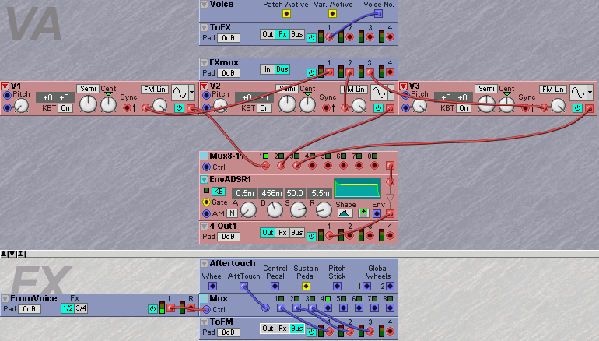

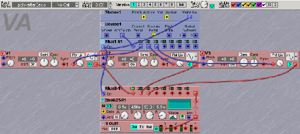

I started thinking about polyphonic key pressure recently, and how it is a wonderfully expressive thing to be able to hold a chord in the left hand, and play vibrato notes in the right hand.
I don't have a MIDI controller keyboard with poly pressure; but an idea hit me that I could, with a bit of tinkering, create a patch whereby the user has control over which voice the aftertouch affects. The aftertouch will still be monophonic, but the patch may be polyphonic.
The default behaviour of atertouch set up to modulate pitch is that playing a chord in the left hand whilst simultaneously adding expression with aftertouch to additional notes causes ALL notes (including the notes of the chord) to move in parallel.
The simplest way to avoid this is to create a "keyboard split"; the lower area with a polyphonic chord patch (which does not use aftertouch to modulate pitch), and a monophonic patch _with_ aftertouch pitch in the upper area.
Another, more sophisticated way (and the way I'm having problems with) is to dynamically route aftertouch messages to the most recent voice in a polyphonic patch.
I use OS v1.40 with an unexpanded G2 Engine.
The blue MUX unit near the top is supposed to make sure that the aftertouch message is routed only to the most recently activated voice.
Unfortunately the result is that all three oscillators receive the aftertouch messages. Try playing the patch and you'll see that using aftertouch results in all oscillators moving pitch in parallel.
The cause of this problem (I think) is that I'm trying to mix monophonic and polyphonic behaviour in the same patch: There are actually three DSP instances of the MUX, operating in parallel.
When one voice is on - only one aftertouch message is routed to one oscillator. When a second voice switches on the first MUX+oscillator pair are still connected, so aftertouch messages move both oscillators in parallel.
I tried moving the MUX to the monophonic FX area...
...but the multiple instances of the Status module providing the Voice Number value mix together and the monophonic area is permanently receiving a value of 12 (values 0, 4, and 8 in the separate polyphonic instances are adding up to make 12).
I'm wondering if any guys who experiment with the G2 in unusual ways can think of a workaround for this problem?

When in your first patch you would leave out v2 and v3 you would only have the after touch on the FM input of one voice.
The way you routed it after touch for voice one goes to V1, for voice two to V2 etc. You do not need to throw three oscillators in as the voice mechanism already makes three out of each one you placed.
Still, in the one oscillator setup, the after touch would not affect the last voice played but an arbitrary one, as the key allocation is sort of arbitrary over the voices (depending on the playing history).
Maybe there would be a trick using the monophonic kbd input and a s&h to get the voice nr of last voice played ... hard to check here at work though ... and even at home as I don't have a keyboard Very Happy
