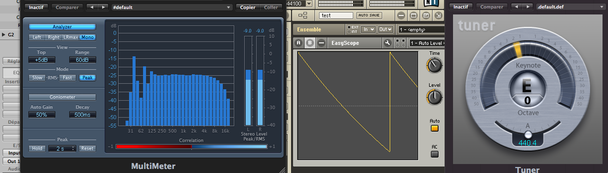

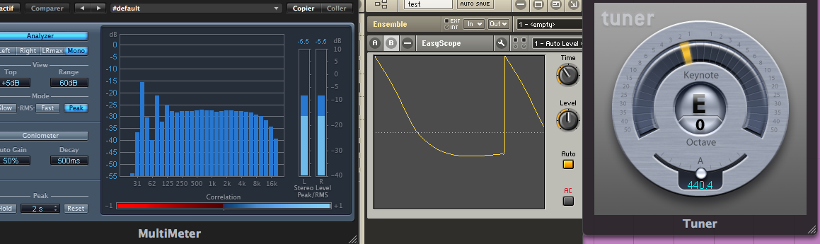

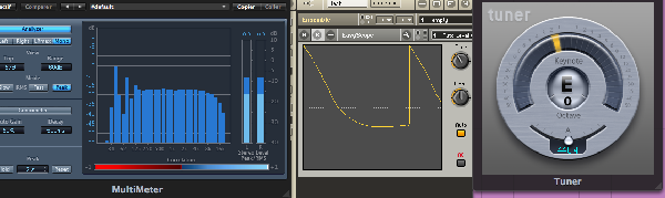

I did several tests with a minimoog. The sound of the saw was my first preoccupation. The oscilloscope shows a perfect saw for the G2, and a rounded one for the Minimoog, especially in it negative side. I tested the lowest note the tuner recognized, E 32'. The sound is a little bit different to my ears.
This what I did to imitate the saw of the mini, listening, looking to the oscilloscope and a multimeter:
1. I tried to tune perfectly the Minimoog to the G2 and to get the same volume.
2. I reversed the wave of the G2 since it is in the opposite phase, to compare easier the shape. (why did clavia change the sense of the saw since the G1?)
3. I tried to change the waveform with a shaper and FM. The best results were when the transformation is dynamically synced to the waveform. FM changed the evolution of the wave under 0, and the shaper rounded especially the negative side too. It is gradually modulated by the saw (before it is reversed). And I tried a overdrive that shapes the wave in a good way (visually...).
I cannot say the result is perfect, since it still lacks a little bit of high frequencies to match to the Minimoog saw, but it is nearest than the pure saw of the G2. I'll appreciate if anybody get a solution to get closer.
Here are the pictures of the analyzes and the patch. Variation is the pure saw, and 2 is transformed.

Thanks Xav,
The waveforms certainly look similar if not the same. I found similar differences in the waveform when I studied my waldorf pulse's Saw/Squ waves etc vs the G2 (which is pratically perfect). Although the effect appeared to have a bias to the note played. In other words higher notes produced more accurate waveforms than lower ones, (could this be to do with the saturation into the filter perhaps?). In order to try emulate this I tried placing EQs on the outputs of the Oscs but with limited success.
Anyway I look forward to testing this patch out when I am back at home.

xav:
What software are you using to provide the oscilloscope & spectrum analysis?
thanks
Keith
Keith M in AZ
BobTheDog
Joined: Feb 28, 2005
Posts: 4044
Audio files: 32
G2 patch files: 15
PostPosted: Sat Sep 13, 2008 11:10 am    Post subject: Reply with quote  Mark this post and the followings unread
Looks like The MultiMeter and tuner in Logic and NI Reaktor doing the scope

Sorry for the delay. Yes, Bob The Dog is right; Logic, Reaktor. But the shape is only useful to monitor what I'm doing. The best tool to see the differences was the spectrum display (especially RME's one).
