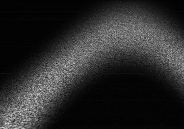

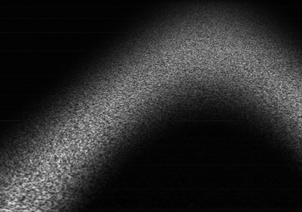

that´s how the result looks with photosounder :
 Filesize:  40.76 KB
 Viewed:  10172 Time(s)

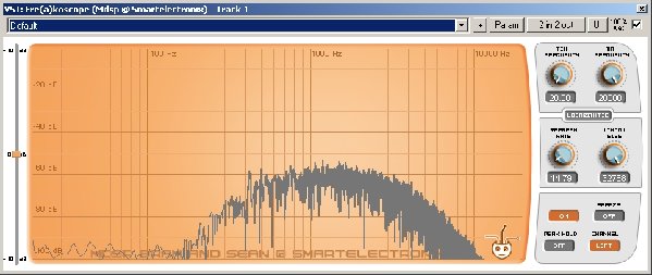

that´s how it looks under ReAper with RecordMonitoring activated and a freeware VST osciloscope as a track FX :
freeware vst-osciloscope: http://sonictransfer.com/free-vstau-oscilloscope.shtml
 Filesize:  152.71 KB
 Viewed:  560 Time(s)

FaschingsPrinz

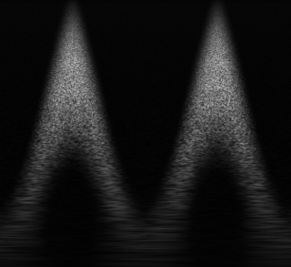

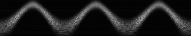

Yesterdays version was done for the G2-demo only.
Due to the fact that low frequencies where louder then higher frequencies, I did add a volume-compensation.
Now operable from the G2
 Filesize:  272.7 KB
 Viewed:  602 Time(s)
 Filesize:  53.45 KB
 Viewed:  610 Time(s)
