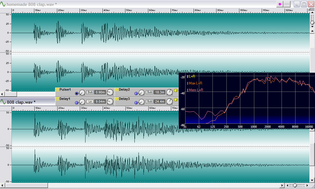

Hello again. I've been busy since my last post! I spent ages adjusting the various parameters on the 909 clap patch attached above, comparing it to my Drumstations 808 clap, but couldn't get it sounding at all right! I needed to add a few pairs of HP and LP filters to get more presice control, which gave me a slight improvement. I decided to get technical and record the two claps into Wavelab, so that I could compare them visually. It was a good idea, because straight away, I could see that the initial delayed claps were out of time and when I had adjusted the times accordingly, I heard a definite improvement... Curiously, the actual delay times don't match the G2 parameter values (see attached pic).
After adding a quieter, third noise tail I am now pretty close to the 808 sound (listen to attached example: 4 G2 claps, 4 Drumstation claps, 4 G2 claps, 4 Drumstation claps).
I have noticed a few things. Firstly the drumstation claps sound more smooth and seem to have more power in the mid to low-mid region despite the spectrum analyser readouts being very similar down to just under 250 Hz (see pic: pink trace - Drumstation, orange trace - G2). Then there is that mysterious bump from 0 - 250 Hz (from the Drumstation), which may account for the extra 'weight'. I couldn't reproduce it with noise. Lastly, the Wavelab '808 clap' (Drumstation) audio waveform clearly shows a few extra peaks after the tail sound comes in on the 4th delay. It is probably simple, but I wasn't really sure how to add some more....
So... I'm hoping that now I've laid it all out so clearly for you all, that some modular genius may be able to finish it off correctly??
Any ideas anyone?
G2 - homemade 808 clap - Orange trace
Drumstation - 808 clap - Pink trace
 Filesize:  186.26 KB
 Viewed:  25200 Time(s)

That patch sounds pretty damn close hey. I don't know how much more tweaking you'd want to do to get it exact - you've already got that sound on your drumstation! The main difference I can hear is that each clap is different on the G2. Depending on your style of music, you may want to sample a bunch of them and save the best ones to use.

Yeah, I spotted the fact that each sounds different, etc.... it's a shame there isn't a kind of sync in option on the noise module, although if I were desperate, I might be able to do this using FM on a synced osc module with noise as it's source.
I don't want to exactly reproduce the Drumstation to use (as you said.. I already have it), but I do want to exactly reproduce it as a starting point to tweak from. You see, the drumstation 808 clap only has level and tune parameters, but I would like to get the beginning the same, but with longer tails or whatever.
Can you hear that the Drumstation clap sounds 'sharper', more well defined, etc? Can anyone get the attached patch any closer? Fingers crossed.

The bit that I'm most interested in is the attack portion, or the first few dozen milliseconds... the bit that transforms the noise from more of a snare sound to that of a clap... the 'crack'.
I agree that I have come quite close and maybe all it will take is to add a few more delays after the tail starts. I'll give it a go sooner or later when I have some time to experiment. I still feel that the provided Drumstation clap sounds better although I'm not sure how - there's definately more lo-mid to it, yet it also sounds sharper. I couldn't achieve this by simply altering the filters.

Hmmm, try running another envelope on the 1st and 3rd clap. Use an ADSR, and set your attack time very low and the sustain about half to 3/4 to get an extra sharp transient on top of the decay one that's already running. From the look of the waveforms that's the main difference, the initial crack of the first and 3rd clap has a sharp attack.
This could have something to do with the 808's noise though. Analogue noise tends to be more chaotic, so you'll get a bit more space between the loud and soft bits at times, instead of the even distribution of freqency/dynamics of digital noise. This might be why the 808 waveform has spikes in the tail, because of the noise's flucuations. So the inital crack of the 1st and 3rd claps might have just caught a high fluctuation....
Maybe I'm just being anal, but I do like my sounds to sound as I like them to sound!
Rob Hordijk posted quite some elelents that try to get some behaviour of analog circuits into the G2... The harmonik distortion patches he did might help to change the tonal colour in the direction you want it to be.
The circuits in a drummaschine contain very simple build env´s there are DC offsets and unlinaritys in the components that cause distortions that shift the wave form and therefore its tonal content.
You also might try to build your own noisegenerators with the trigered random moduls or the patterngenerators...i am not sure why your noise source is changing colour in such significant ways that your clapsounds differ... The 808 has just a noise source that runs free as the G2´s...
maybe you ve to much lowend content in your noise resulting in different dc offsets in the moment the env´s are triggering. some lowcutting allways helps in analog simulations..
I dont think that the 808 clap has much below 100 Herz....
Or you can lowcutt the noise and add some fundamentels with resetable oscs...
I ve a look when i can test the patch....
I however appreciate to have a 808 clap for the G2...thanks for your research...
