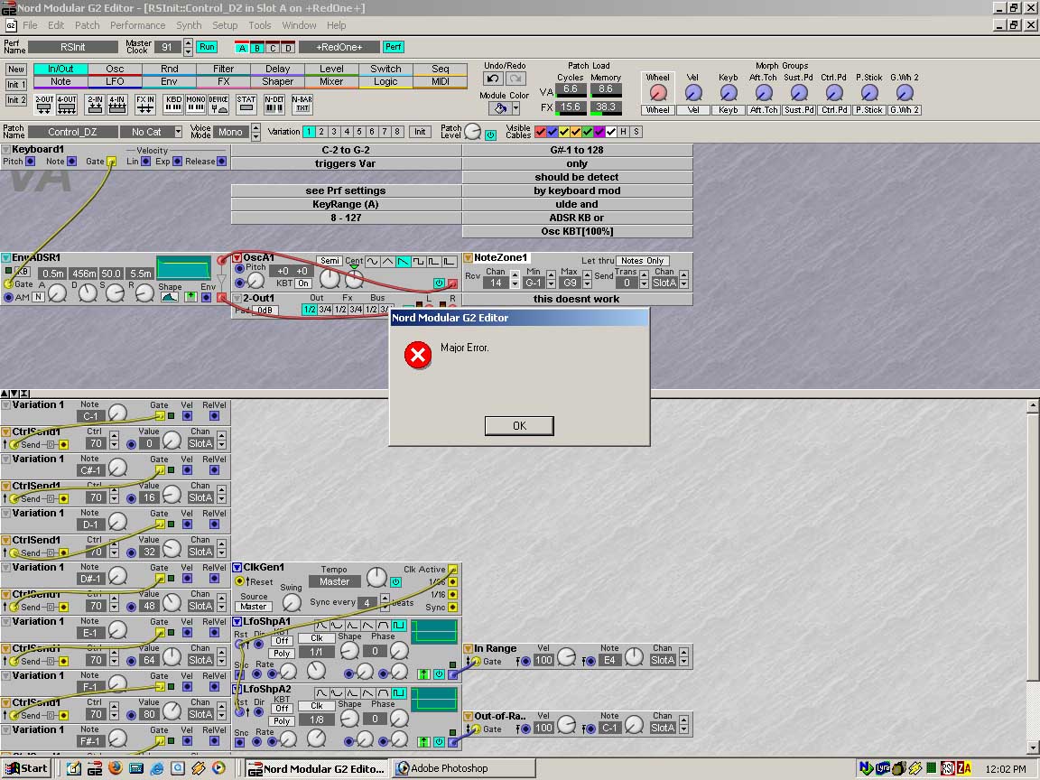

My prolbem I have all these pretty much ready patches (that I did before I got the RS) which I wish to reuse with minimal modifications. These patches rely on note # for transposition and variation changes (typically tweaked live by me) ...
Now I wish to use the RS as a controller for both transposition and variation changes ... The limitation in the RS's grid mode (to note # only) forced this solution ...
but this solution is far from perfect, as I discovered once I turned to osc Keyb pitch tracking to On and the ADSR kb on as well ... even though the performance mode tells slot A to ignore anything below g#-1, it's still affecting anything with KB or KeyB and the Kybaord module keeps ignoring this rule .. I'm going to log this as a bug to Clavia ...

Here's the prf2 which is causing all sorts of grief... I wish to isolate the 1st 8 notes of the slot A for variation changes and the rest of Slot A for playing the slots (via keyboard or remotely) ... no cross-triggers from the other "zone" which is what is happening , can you help (Kassen your feedback is very welcome here)
Even after adding a NoteZone module I had issues (see jpg - "Major Error" after adding a note zone module and setting the setting as you see in the jpg -- I use local on fyi).
Oh happy day (as I may no longer need to be a s/w developer but a UI designer soon!!!),

The variation changes on this slot (A) do work ok (thanks for Copy Select to Variation 1 to 8 ), and yes, I've triggered them from other slots this way also.
The major error looks like some feedback issue, I'll try putting that into another slot.
There is a specific need for me to use the 1st 8 notes of the MIDI channel for variation switching and the rest for playing (just because a single rs7000 track sends out on only 1 channel midi channel in grid mode), as this will require small changes to my patches (this is the major thing). This prf is meant to be a starting point for converting my existing patches (and new ones).
I'm sure I'll find a way (if keyzone doesn't work for me, I'll try the window switch module next) ... worst case, I'll have to work without variation changes being triggered remotely, but manually which is what I already do ... yes, I could write a Max patch to do this, but I want to be portable (with no laptop), just 2 g2's an rs7000 and some other gear ... like my avatar (except papa nord is replaced with an rs7k)
I probably won't get a chance to figure this out until later today ... if someone else does, lemme know ..

I wouldn't get rid of just the zone module. I'd get rid of all signals that don't explicidly use a cable. This means zone one, all hard keybard => envelope and pitch => osc links. I'd use a cable everywhere and use conditional switches on all cables. Only open the gate when the pitch is in the right range AND there's a gate. This way you avoid ambiguity and conflicts.
Perhaps it isn't nesicary to mention it but this way you can't send a note and a variation change at the same time and if you try so the note priority will either cut or delay either the change or the note, depending on relative note length and note priority
