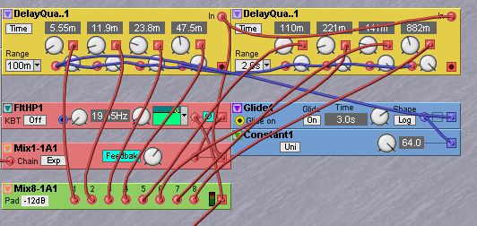

see this thread for a discussion of the 'zipper noise' in the delay lines...
http://electro-music.com/forum/topic-7937.html
since the 8 tap doesn't have a mod input it's not feasible to apply the 'smoothness' tweak directly to that module, even via a MIDI control send/constant knob/glide combination, but i wonder if doing so with two Quad Delays and a constant knob/glide module will do the trick. sweep the constant value knob.
see the pic
*uh, what the hell? if you click on that pic (i have no idea where that came from) you'll see the one i actually uploaded of the patch i'm talking about... WEIRD!!
