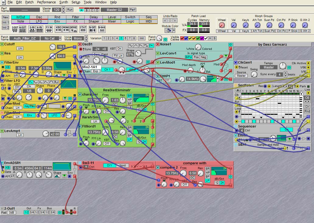

PostPosted: Thu May 28, 2009 10:41 am    Post subject: Reply with quote  Mark this post and the followings unread
One of the simplest things to get a more authentic (I hate to use the word "analogue" anymore) feel of the G2 filters is to turn gain compensation (GC) off. You get a more satisfying tactile feedback (pun? Laughing) when tweaking resonance, and the filter also performs more authentically when it sweeps over harmonics, as there isn't any of that artificial-sounding GC-compression going on. Obviously you then have to be more careful with overloading the circuits. But that's one basic thing that makes alot of difference IMHO. They should have left GC off as a default IMO. YMMV.
Tim, I wholeheartedly agree about this point. I have barely used GC, only for bleeps and spacy sounds, but not for bass or pads ... I am so used to to overdriven filter sound, it in fact I have become used to it.
Having said that, I'd be curious about how we could keep GC off, having a conistent input going into the filter, with no distortion at high resonance settings?
Perhaps if I put a Band reject filter before it .. and fade between a normal and bandpassed signal if the resonance is high ... hmmm
I just went off and patched this all and attached the patch (which works in the demo too).
I noticed that playing with the resonance of the bandpass either dulls the low pass's resonance or makes it bigger, whereas if I turn the xfade mod (essentially deciding how much bandpass I want to use gives you more spikes and essentially distorts the resonance) ...
I'm pretty happy with the results ...
I also added some dithering when the osc is near it's peak (this may be wrong) ...
Your thoughts?
/Dasz
