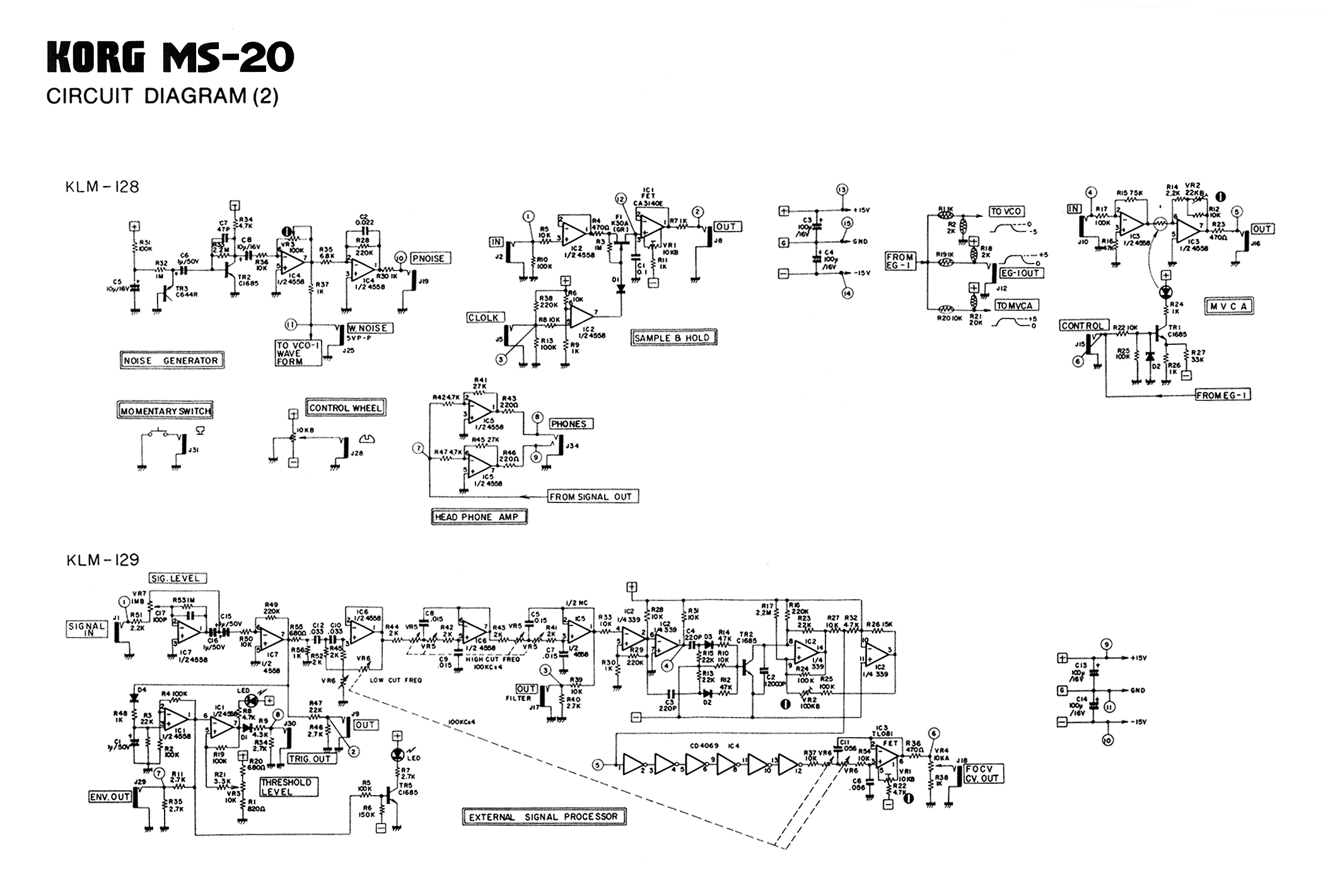

I don't know if there's a schematic out there for the Korg X-11 "guitar synth" but parts of it might prove interesting/useful.
I've heard that some folks have had luck using simple, monophonic tones with the Korg MS20's External Signal Processor, but that it takes work to get it to produce useful results under particular conditions:
http://www.synthdiy.com/show/file/?id=1690

it sure has a lot of opamps in a row!!
i printed it out...lots of people have being saying its useful.

You're talking about the MS-20 Processor, right? I think those are schmitt triggers or some kind of CMOS stages, not op-amps.

we are both right, there are opamps AND cmos inverters. at least that was what i saw at first glance. i need to take some time this week to study that AND what you posted. thanks btw
