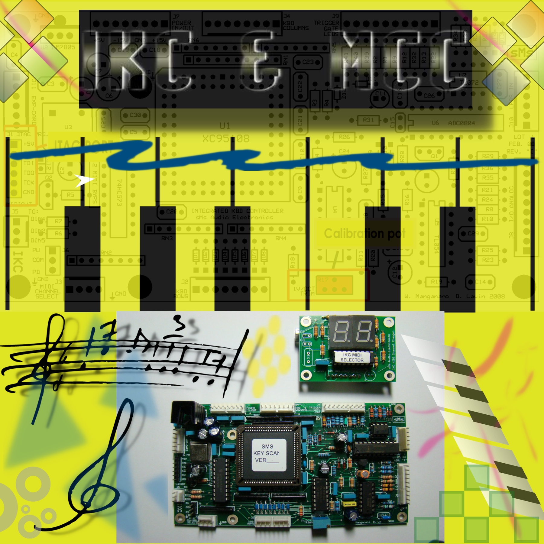

After months of development, Dan “Antman” Lavin and I, Bill Manganaro, finally present the “Integrated Keyboard Controller” or better known as IKC to the members electro-music and the DIY sub-forum “Microcontrollers and Programmable Logic. The IKC is a project that fellow forum members can build and use as their “master” keyboard that interfaces with their voltage controlled modular synthesizer systems and/or MIDI sound modules. The project originally started as a challenge by Scott Stites to design a PCB layout for the Thomas Henry “Digital Keyboard”. This link below takes you there.
http://electro-music.com/forum/topic-17815.html
That thread then ended up linking to this thread as the original thread began to take a turn towards the “IKC” project. I took the challenge of making a printed circuit board for this project a bit further than expected as I realized, although the original design is very good, I thought it could be “modernized” or built upon by integrating or streamlining many of its digital sections into a single chip while at the same time, adding to it extended analog functionality, use of larger keyboards (up to 5 octaves), and some basic MIDI interfacing. This is where the “integrated” part of the name came from. I also realized two other things. The first being that the DIY synthesizer community really needed a more “full featured” analog keyboard controller design with multiple analog modulation sources and include basic MIDI capability. The other thing I realized was that I wanted to present a project that utilized the technology of using programmable logic in the design in the IKC. Yes, I could have coded the design in assembler, BASIC, or “C” or some other high level language and left the job to a microcontroller but did not want to do this.
Briefly, programmable logic design uses highly integrated standardized logic IC’s with general purpose digital building blocks, advanced interconnect matrixes, and large amounts of digital I/O. The user then defines its functions through a design entry process utilizing special integrated development software package. I used Xilinx “Webpack ISE”, available totally for FREE.
http://www.xilinx.com/
The design is then synthesized and sized fit the target chip, an XC95108 for this design, using the software’s device fitter. A programming file is generated that represents the finished design (a JEDEC file). This file is then programmed or “flashed” into a chip using a JTAG downloader cable you can get for about $25.00 USD.
http://www.renaelectronics.com/index.html
http://www.xilinx.com/products/devkits/HW-USB-II-G.htm
http://www.xilinx.com/support/documentation/xc9500.htm
This approach replaces the technique of using many discreet hardwired “building block” logic IC’s such as the ubiquitous “CD4000” or “74xx00” series we all come to know and love. I would guess that a great many of us, like myself, started designing some of our first logic circuits using these logic families then started moving into the 8-bit microprocessor arena and started mixing the two technologies. Partitioning what was coded in the processor and what became hardware then became the challenge. Using programmable logic was the methodology used for designing the IKC core digital logic and is a common practice in the industry today. I used a mix of “Very High Speed Integrated Ciruit Hardware Description Language” or “VHDL” and “Schematics” for the IKC design entry process and made circuit design changes as easy as changing code or a schematic then re-synthesizing and flashing onto the chip in circuit. Here is a good explanation and history of VHDL.
http://en.wikipedia.org/wiki/VHDL
What follows is a brief description of the IKC. The full, comprehensive, documentation on how to build and apply the IKC attached to this message and is entitled “IKC Build and Engineering Drawings”. An excerpt from this document follows:
“The Integrated Keyboard Controller (IKC) is a low cost, high quality, circuit board that can be used as the main functional building block that allows you to build a custom music synthesizer keyboard. The project was inspired by the Thomas Henry digital keyboard project that appeared in one of his early books entitled “Build a Better Music Synthesizer”. Bill Manganaro and Dan Lavin jointly developed the IKC. Bill handled the electronic design and programming duties while Dan did the PC board layout and some of the analog design. Dan was also very helpful in ideas for the design and for that I thank him very much. The IKC can support up to five octaves and will control both your analog and digital music synthesis equipment either simultaneously or separately. It incorporates all the circuits necessary to scan up to a five octave, 61 key matrix, and outputs a tunable 1V/Oct standard control voltage, trigger, gate, and has basic MIDI functionality. The IKC can be paired with the recommended MIDI Channel Changer (MCC) that interfaces directly with the IKC. The MCC is a small form factor circuit board containing four bits of MIDI channel selection logic and two 0.5” high, blue, seven segment LED displays for MIDI channel indication.”
The project also comes at the same time Scott Stites, analog synthesizer extraordinaire and master of the furry breadboard, is developing the “Appendage” versatile Ribbon Controller. The link to the ribbon controller is shown below. I have had the pleasure of working with Scott over the last several weeks on the project designing the PCB layout of this project.
http://electro-music.com/forum/topic-28138.html
I believe that the months ahead will be popular ones for performance controllers appearing on our forum. The “IKC/MCC” and the “Appendage Ribbon Controller” will be perfect together as they can be integrated into one unit or used on their own. We also hope it will inspire others to develop, or continue to develop, their own performance controllers such as this wind controller designed by Ian Fritz.
http://home.comcast.net/~ijfritz/sos_over.htm
There are many fantastic sound generating and sound modifying (VC filters, LFO’s, ADSR’s, etc…) modules out there that have been developed and presented right here on this very forum, these cpntrollers are a perfect match to take control of them and use them expressively to their fullest potential with this and other new contributions to our forum. I believe the “soldering musician” is very alive and all this activity on our forum, and others, are proof of that.
In addition to the IKC build documentation, an IKC price sheet is also attached so that you may consider purchasing your IKC supplies directly from sMs Audio Electronics, a quick view of those prices are shown below but suggest looking at the descriptions in detail. These include PC boards, FULL board parts kits, built and tested MIDI channel changer assemblies, programmed CPLD, or completely built, and calibrated/tested IKC circuit board assemblies. The purchased IKC board can be a complete OEM solution to your own keyboard building business if you wish. The entire project, however, can be completely constructed without any purchase from sMs Audio Electronics at all and is public domain.
The projects source “JEDEC” file, or CPLD configuration file, is also attached to complete the package and is currently at a revision 1.5 so that you can purchase your own blank CPLD and program or “flash” your own chip. The documentation shows you how to do this. All the chips are common in the project and are easily obtained and documented in the IKC build document. A dedicated documentation posting will be added and will be a read only post. As new documentation is added or changed, it will appear there.
NOTE: The CPLD configuration file Keyscan_Vx.x.jed has been renamed to Keyscan_Vx.x.txt so that it can be uploaded to this post. PLEASE CHENGE THE FILE NAME BACK TO A .JED BEFORE USING IT IN THE PROGRAMMING SOFTWARE WHEN FLASHING YOUR IKC CPLD"

My custom front panel for the keyboard that is being built with the sMs "IKC" and MIDI Channel Changer (MCC) electronics.

Looks like excellent work -- as usual -- from both Bill and Dan. Me, I'm holding out for polyphony, or at least two-voice.
Richard,
Thanks man ! Polyphony sounds like something I would like to tackle on the next controller. I would also like to take advantage of the Fatar keyboard's dual switching (MAKE-BREAK) contacts for velocity sensing.
Hinton Instruments ,however, makes these velocity sensitive keyboard chips if your ever interested in "rolling" your own:
http://www.hinton-instruments.co.uk/components/kv64/index.htm
Here is an 88 note KB scanner example using the KV64 chip:
http://www.hinton-instruments.co.uk/images/components/kv64_kbd88.gif
Thanks again for the compliment Very Happy
Bill

The Hinton stuff does look exciting at first glance, but it uses the old changeover type key contacts instead the newer parallel bubble contacts used by Fatar and similar keyboards produced toda
And so it is, Now I wonder why they would still be marketing something that would be of little use for today's keyboard standards? As Richard pointed out, the scanning is only part of the solution. Besides, my scanner chip is only $30.00 USD, theirs is 34 British Pounds, quite a bit more. Wink

parts arrived save and sound. this is a great motivation for me to clean my workbench by finishing all open projects, and to start building my keyboard synthesizer (monofonik, minifonik, profonik ???) Very Happy
Posts: 2810
PostPosted: Sat Nov 08, 2008 8:49 am    Post subject: Reply with quote  Mark this post and the followings unread
Great news ..... I kind of like the "Monofonik" name myself ..... Cool
Thanks -- and feel free to ask any questions you need to get you through the project ........
Bill
