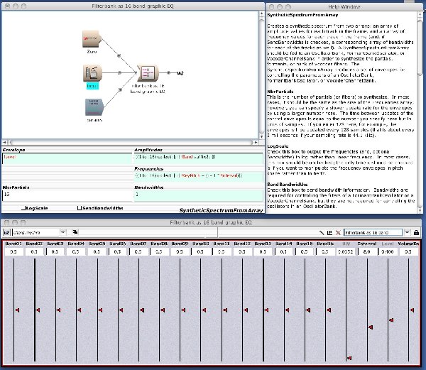

Well there is a lot to learn but I am not finding it hard going.
It makes more sense to me than the G2 does, much more than Reaktor and a huge amount more than MAX/MSP!
I think this is probably because it is more algorithmic in the way it works.
You can use SmallTalk scripts to set up sounds and parameters and even to create sounds, SmallTalk cannot run on the Pacarana.
CapyTalk is a way of having complex expressions that run on the Pacarana. This is used with "Hot" params that you can change via a gui or with midi. Hot params start with a !
SmallTalk and CapyTalk can be combined.
For instance the following could be used for an amplitudes parameter which expects an array, for example a 16 band EQ:
{(1 to: 16) collect: [:i | !Band suffix2: i]}
What this does in create 16 hot parameters, !Band01, !Band02, !Band03 .. !Band16 and place them in an array.
So the gui would have 16 controls (faders by default) which we can change via the mouse or midi to affect the values in the array on the Pacarana.
Staying with the 16 band EQ example we could set the frequency of each band as follows:
{(1 to: 16) collect: [:i | !FreqLow hz nn + (i * 4 nn)]}
!FreqLow is the start frequency and is a hot parameter that can be controlled via midi or a gui.
16 pitch values are generated from this, each one 4 half steps higher than the previous.
Or if we wanted to have each band of the eq seperated by a user defined interval with the base freq being defined via a midi keyboard note we could do this:
{(1 to: 16) collect: [:i | !KeyPitch + (i - 1 * !Interval)]}
!KeyPitch is set from midi and is a combination of the last note played and pitchbend.
!Interval is a hot param that can be set via a midi message or using a gui.
Now this sort of thing makes sense to me, but I come from a Software background, others may find it confusing.
So this 16 band Eq, with user defined intervals which can be "played" from a keyboard took a couple of minutes to knock together, image included.

wow, this is some heavy duty stuff! The gui almost seems like a guide, rather than where the action really takes place. It seems like more is happening below the surface than just the gui. This seems like it'd be a bit slower than other tools, but I can understand the relation of this to DSP code (I think similarly having been designing embedded systems for too long.)
Hmmmm, lots to think about. But I guess your right, the book is the next step.

Well, yes and no. The gui isn't based on dragging virtual wires around like say Nord or Reaktor. There is drag and drop for many elements, particular as it relates to the wiring modules together, however, it all can also largely be driven by copy and paste or key input which one you learn can be a very fast way to work.
In each module there are fields related to the parameters of that module (which is really just a snippet of DSP code under the hood). In those fields you can enter fixed values, more snips of code, links to other modules, and / or values that generates UI controllers (like Andy demonstrated).
Andy, you kids nowadays, I remember back when you had to enter each of those !hot values by hand. In the snow. Up hill. Both ways.
