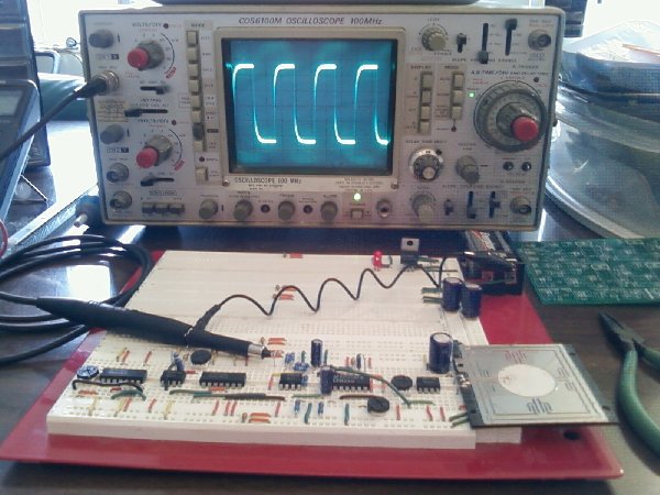

I made some progress today on the BSG's Karplus-Strong Circuit. It doesn't work yet but most of the subcircuits do work properly. I think I just need to get the biasing and lop gain correct. Below is a photo of the test circuit.
Also for your review, from Thomas Peter (wmonk) here are two links to Karplus-Strong circuits created wit modular synthesizers:
http://vimeo.com/2651547
http://vimeo.com/1952077
The fact that these modulars do the job so well is encouraging for this little DIY project.
The first test circuit
 Filesize:  330.2 KB
 Viewed:  1161 Time(s)

if you like miniaturization better, then you may very well prefer a digital implementation. For that I'd choose the dsPIC chips although there are several alternatives. I can help you get started with dsPICs if you are not familiar, but I'm no expert.
I'm not using the clock driver IC because I don't have one. I just have two MN3209 chips. I made the clock driver from a 555 circuit with frequency control input of 2 octaves and a D Flip Flop to create a 50% duty cycle plus inverted output. It works great.
The main problem at this time is that I totally ignored the bias and gain setup of the feedback loop and that part needs to be redesigned. More updates later and good luck with your choice of implementation.
Les

Ah, so it works then! Cool! From what I've read, the spacey sounds occur when the frequency is too low (ie. below 40Hz), and percussion sounds when the gain is too low. But of course, there are lots of other factors influencing the output. Now I'm even more excited about getting this up and running myself!

Are those chopsticks in that pic, top right?

I believe that is a light brown protoboard laying flat and seen from the edge. Jan noticed the overdue calibration sticker in the chatroom. What is this, an inspection of my lab? Very Happy
Les

I've realized some things about the circuit that i need to correct, notes as follows.
1. The speaker is a high impedance speaker, so it doesn't make sense to drive it with an LM386. I'll just drive it with an opamp.
2. The counter will be a CD4040, not a CD4017. What is needed here is a binary counter not a decoded counter.
3. Lots of little details that I keep darting between in my thoughts, making notes of them. As I understand it all more I'll report.
