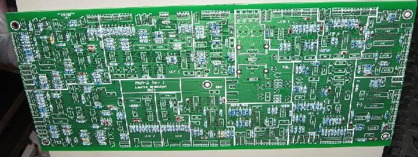

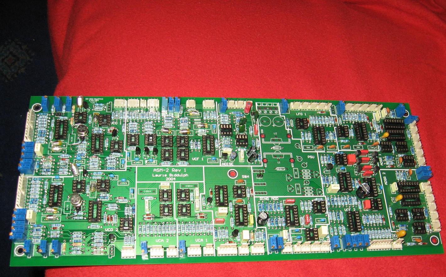

PostPosted: Thu Aug 27, 2009 1:02 pm    Post subject: ASM-2
Subject description: construction time again........
nearly there with the resistors & diodes, i've bought connectors for wiring properly instead of my usual crows nest of wires Smile , decided to go banana for patching with a few converters to 1/4 inch, i also got yusynth saw animator pcb from Bride Chamber to add to the final design, not sure whether to add ken stones sub osc pcb as well .
very good quality pcb from elby & Bride Chamber, good stuff.

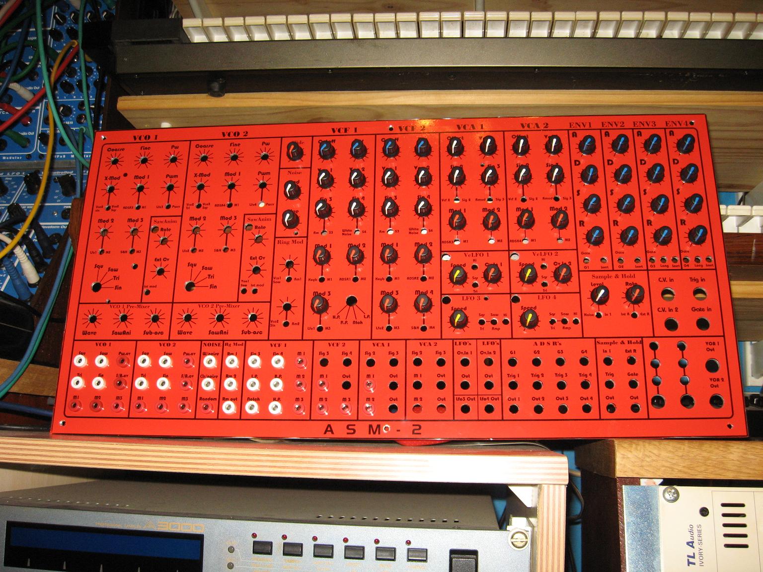

PostPosted: Sun Oct 04, 2009 9:20 am    Post subject: Reply with quote  Mark this post and the followings unread

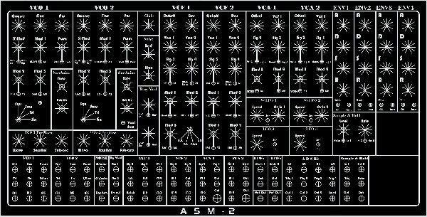

Almost finished the front panel design for my ASM-2, a few things still to add, gonna start on some vero board lfo's some time & the 2 extra adsr's & the 2 saw animator board, i think i've got it all covered with this semi-modular design & bannana jacks, i hope Smile

PostPosted: Sun Oct 04, 2009 10:39 am    Post subject: Reply with quote  Mark this post and the followings unread
huge project and nice layout. i am curious to see more pictures soon.

PostPosted: Sun Oct 04, 2009 3:19 pm    Post subject: Reply with quote  Mark this post and the followings unread
What are your front panel dimensions? I've got mine drafted out to fit 14u of standard rack space, yours looks much smaller than that. Nice work!
I'll post pics to this thread once I get the metal cut, the PCB itself is 97% stuffed. I've been nibbling away at this project for about a year now Embarassed

PostPosted: Mon Oct 05, 2009 10:23 am    Post subject: Reply with quote  Mark this post and the followings unread
Thanks Matthias, took a few weekends to plan this one, i'm building a seperate power board to supply the asm & extras, i have made the box with iec fused socket to house it and have a torroidal Xfrmr ready to go in.
I'll add more pics as i go.

PostPosted: Mon Oct 05, 2009 10:33 am    Post subject: Reply with quote  Mark this post and the followings unread
Hi crochambeau, 3mm alum panel is 590mm X 300mm, a guilloteened off cut from my local engineers workshop with clean cut edges from using hydraulic cutter machine.
The design above will be lasered to vinyl sticker when finished, i thought i may have had room to fit a few lunetta circuits but i'm out of space already.

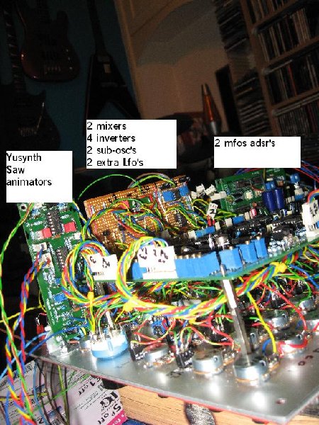

PostPosted: Wed Oct 28, 2009 10:36 am    Post subject: Reply with quote  Mark this post and the followings unread
had some spare time recently to do a little more to the ASM 2, hoping to get finished before Xmas holidays, i'd better get a complimentary hamper from Rapid electronics for christmas for all the orders put in over the last few months Smile Smile he he he.
 Filesize:  303.2 KB
 Viewed:  589 Time(s)
 Filesize:  314.67 KB
 Viewed:  629 Time(s)

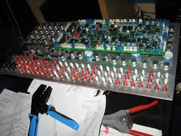

 Viewed:  464 Time(s)
Posts: 1194
Audio files: 155

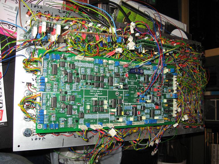

PostPosted: Mon Nov 23, 2009 11:36 am    Post subject: Reply with quote  Mark this post and the followings unread
Nearly finished the wiring, then it's time for test & calibration and hopefully celebration , error dependant of course.
I've been getting home from work and resisting the lure of the couch to wire it up, probably annoying neighbors using a cordless drill to twist wire looms at nights , Smile .
must tidy those wires with some zip ties.

Posts: 1194
Audio files: 155

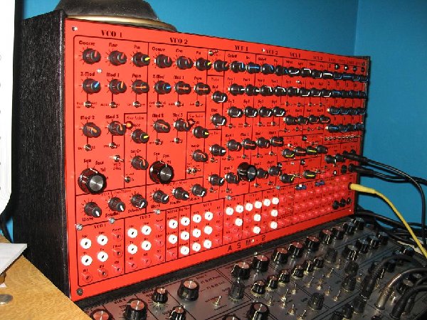

PostPosted: Sun Nov 29, 2009 9:10 am    Post subject: ASM..2 "it's very, very musical"
Subject description: ASM-2 is making sounds
Worth the wait to get this synth up and running, i'm really impressed with the sounds and tones available on the ASM-2, adding 2 saw animators (thanks Yves & Bridechamber !) has ehanced the sound even further.
I have allready had some new ideas for new tracks for ORCHARD & EPICYCLUS within an hour of trying it out after finishing building, fantastic.
When building the asm, i found it best to refer to the genie / wizard / asm manual & various wiring options pdf doc's, to get a more rounded instruction on the build , referencing between all these doc's helped me with a few hiccups and stumbles when constructing.
Here below is a selection of sounds from my ASM-2 finished build all sounds are free of FX , just the synth apart from "major force" it has a little verb on it, a little bit of the 1979 album influence to it, ha ha ha .
please don't fall off your chair when you hear it Laughing
 Filesize:  149.82 KB
 Viewed:  479 Time(s)

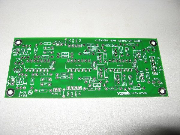

Seems a few folks hearing the very rough "Tangerine dream - force majeure "melody + sequence mp3 , it was the first thing that was in my head when testing the synth , ha ha, fun on the keyboard.
Next project to appear in the Klee forum area..........
Deep thought as to how the panel layout will end up with these sequencer boards....Hmmm.......
 Filesize:  72.45 KB
 Viewed:  26008 Time(s)
