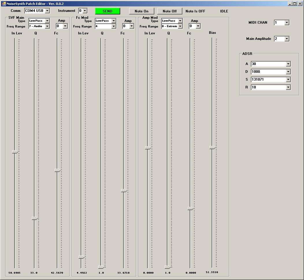

PostPosted: Tue Feb 16, 2010 4:29 pm    Post subject: Reply with quote  Mark this post and the followings unread
Here's a screen shot of the patch editor for the NoiseSynth. It shows a fictitious patch.
I wrote this in VB.NET Express Edition (which is free from Microsoft). The program communicates with the synth hardware over a USB connection to the board. The messages are formatted exactly like system exclusive messages and could be transmit over MIDI. This is more convenient because I don't need to figure out how to interface with a MIDI connection that also supports performance data.
NoiseSynth Patch Editor screen shot.
 Filesize:  114.76 KB
 Viewed:  537 Time(s)
