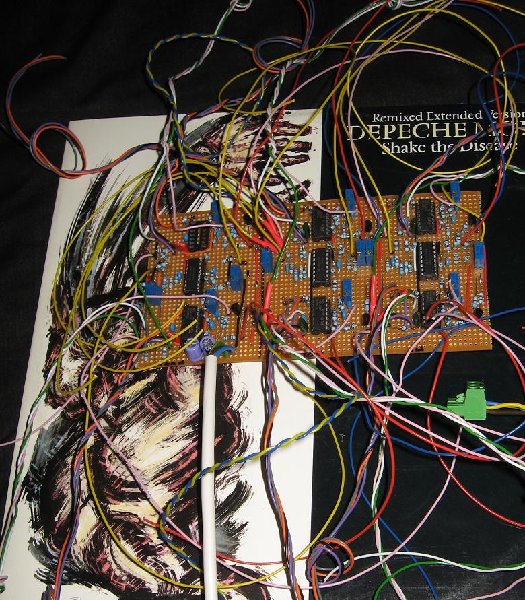

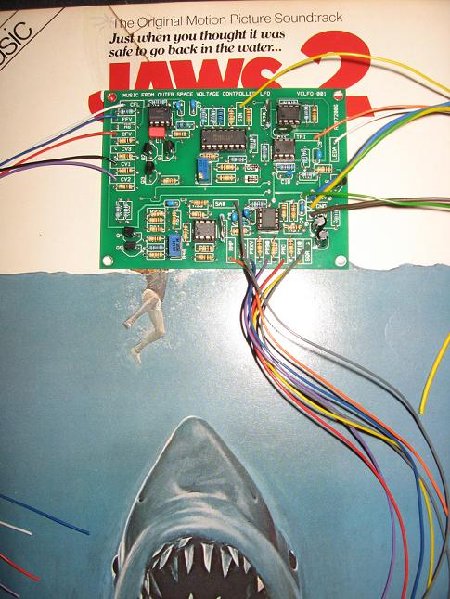

Damn, I ran out of lfo's on a patch , need to make space for more lfo's Very Happy.
i need to condense 3 older designed panels to free up space for a new 6 lfo panel i've templated in corel draw.
Panel design for 2 dual vc-lfo's done below and a new module panel design for 6 of Ray's http://www.musicfromouterspace.com/analogsynth/coolnewlfo.html
versatile multi waveform lfo , to be constructed on vero-board & panels drilled in the garden shed Smile .
more pics as i progress Smile .
3 older style single vc-lfo's i built in 2005 plus a 4th board will squeeze into 2 dual vc-lfos

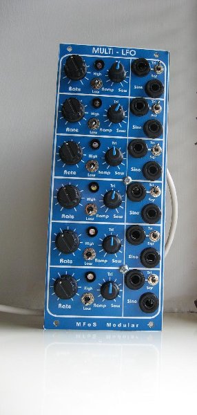

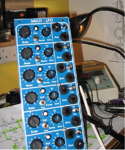

Thanks for the comments guys Smile , i'm probably going to have to review my current capacity on the "windscale" diy power plant for the modular after adding all these upgrades Very Happy.
6 multi LFO module complete , all working after some head scratching faults / mistakes Smile ......3 stripboard isolator drilled pads had micro slivers of copper shorting (classic 'non concentration'), drill more out , fixed.
forgot 2 wire links , fixed .
Sine wave trimmers all set, & all 6 tested with oscilliscope
as i was wiring i tested some different sizes of caps for the lfo rates i used 100N mylar for the high rate and a Wima 2.2uF box polyester instead of the 2- 10uF electrolytics back to back in the diagram.
I also used Log 100K pots for the rate controls , for me , they give a bit of fine adjustment at the lower speeds.
Dave.

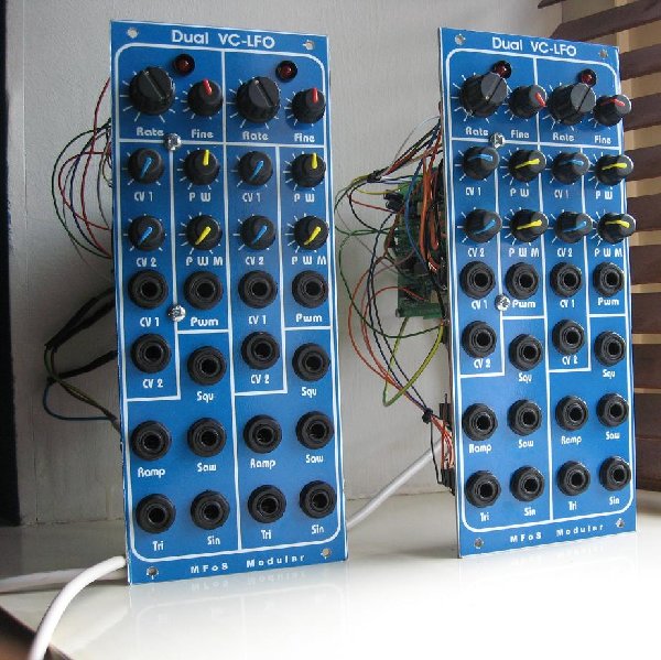

Pots arrived in the post today to finish the VC-LFO's All calibrated & tested , cool .
I found some 10uF non polar caps & have put them in the bottom 2 lfo's low speed switches on the 6 multi lfo module , great for very slow filter sweeps (windy landscape Smile ) .
sounds of 10 lfo modulation to follow Smile ...

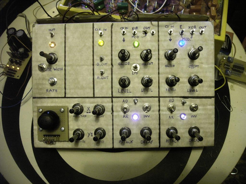

FACEPLATE........
Since your sound design DIY synth is probably going to evolve in concept and design why not get a cutting of 3mm MDF or ply sheet from a construction waste dump , get the experimenter working and then add small easy extras like wave folders , freq dividers , more lfo's , then when you think no more can be added , finalise a nice bit of aluminium to the final size
Thick cardboard is also useful for a temporary faceplate, and if you use a box you have also something to encase the PCB's. here's an example:
Using a temporary faceplate is very useful with bigger projects, because it let's you play around with it before it's finished and this
can be helpful to find out how to place the controls in a practical way and what to add or maybe discard.
I use photoshop to design fronts myself, and made my own library with parts. Whenever I have something new I just design it
and add it to the library for future use. Cool

Phobos , great idea for checking panel layouts , cool , i also like the joythumb at the lower left , is that from a usb game pad ? Smile

it's a similar one, but I didn't get it from a game pad, just bought it like that. Wink

Since your sound design DIY synth is probably going to evolve in concept and design why not get a cutting of 3mm MDF or ply sheet from a construction waste dump , get the experimenter working and then add small easy extras like wave folders , freq dividers , more lfo's , then when you think no more can be added , finalise a nice bit of aluminium to the final size (2 years later Very Happy Very Happy )
That is a GREAT idea! In fact taking it one step further, I could use corruplast as a testing panel. Corruplast is corrugated plastic that can be cut by a knife and also holed can be drilled into it. There is a place by me that makes signs and I can get a hold of the stuff pretty cheap. I could cut the material in 5U panels and then make up layouts on Corel Draw. Once I have something, I can print out the paper and stick it to the corruplast and then drill out the holes. I could work with that for a while and it would be easy to add new items, shift things around until finally I have everything into place. Once that is done, then I could make up a permanent aluminium panel for it.
Granted working with cardboard is faster, but Corruplast came to mind (above) as it is much sturdier and it can be cut with a knife too.
Yes, there were things I wanted to change around on the experimenter once I completed building the circuit. One thing I do want to have is a half normalized system in which the VCOs / noise generator go through a mixer through one of the VCFs, and in turn through one of the VCAs. Since there are two AR's and two LFO's. The VCA would have a normaled connection to one AR and one LFO and likewise with the VCA. So that would give me a fully functional synth right from the get go. Then I can come with my cables and play around with patching.
