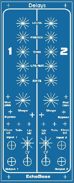

Hi Smile
Just finished designing the panel for my 2 ECHO BASE pcb's.
I've got 1 board populated and have added the clean kill / lfo kill / lfo wave shape pot / run away feedback / cv input .
for the cv input i was experimenting where & how and got a good result with an attenuated cv connected to the wiper of the lfo shape pot mod .
My feedback pot is very tame at maximum , i'll try to get a bit more soon.
initial tests were overloading the fx when connected to my modular ...so... i built a vero board CGS stopbox adapter... works a treat now , one more to build up & get the panel done (lazer printed vinyl sticker) , should have it all running during the Xmas holidays Smile
The wide space on the main controls is allow mounting the pots on the reverse side of the pcb to get the vertical layout i wanted Smile
Dave.

PostPosted: Mon Dec 20, 2010 2:06 pm    Post subject: Reply with quote  Mark this post and the followings unread
Very cool, look forward to seeing the real thing.
Out of interest what voltage are you running it off?

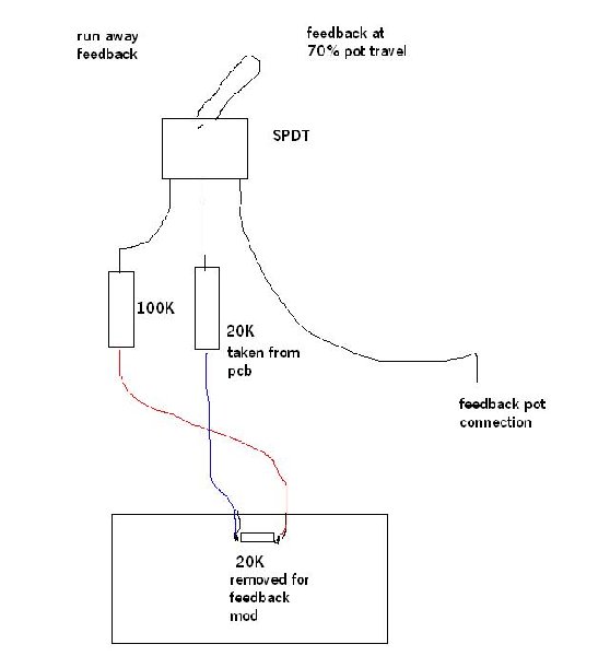

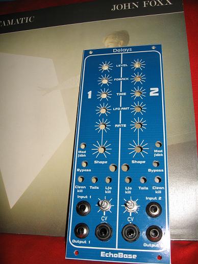

Hi Slacker Smile
i made a small vero board circuit with 12v +/- incomer to supply the CGS stompbox adaptor then through a +9v reg to supply the echobase Smile.
alu panel drilled & stickered , slight colour banding on the blue print on the panel but i'm glad just to get them done Smile .
i've been trying some things for my weak feed back and realised the run away F/B mod i done cuts the 20K out the circuit till i switch the run away on , so.... tracing the connections i've used a SPDT switch with the other pole connected via a 100K res. to the old 20K board thru hole , see diagram below , now i get either controlled feedback at 70% pot travel or max feedback , fab Very Happy Very Happy Very Happy, all will be built up over the next few days.

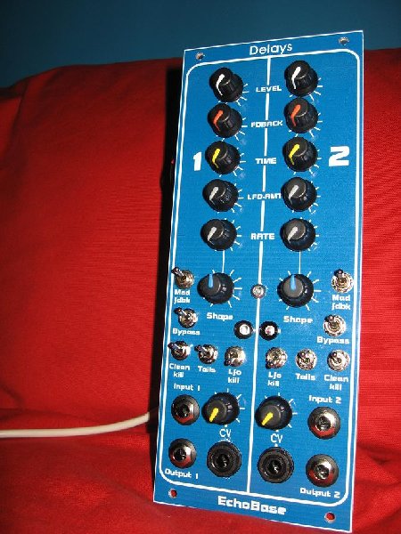

Finished ....Smile Smile....
i'm really happy with these delays , they work great with the usual sequency stuff i do for my music.
Also great for FX whooshes & zaps with a high pitch S&H controlled VCO run through them Smile.
My bypass led's were dim with a 50K load res , better with a 10K but with a 2K the internal Lfo stopped working so back to 10K .
I had breadboarded another type of PT2399 delay design a few years ago with not very good results , these , however , hooked up with Ken Stones stompbox adapter circuit work well with my diy modular ( and free up my 19" rack delays for the Juno's Smile ).
after reading previously about pots wired back to front i double checked with a continuity meter the minimum or ground legs of the pot connections and yes the pots get soldered to the track (back) side of the pcb .
listen to Epicyclus on the New Years Eve electro-music concert , Friday 19:30 GMT to hear them , i'll post some short sounds here after the weekend , thanks for having a look.
