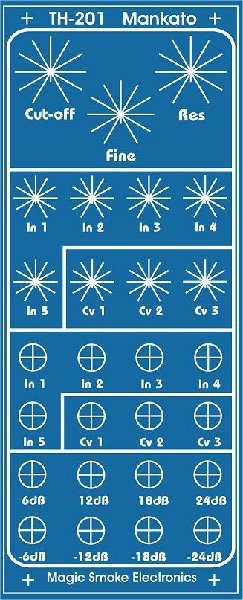

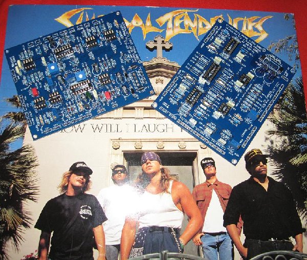

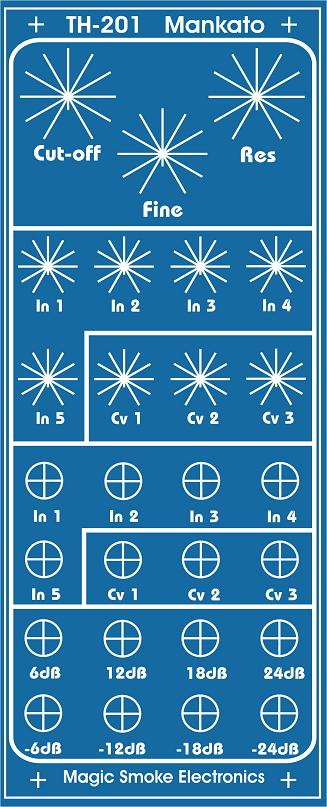

Hi
finished the design for the panels and i've got about 90% of the boards populated , hope to get the modules done over the xmas holidays Smile .
Looking forward to getting these running Smile
Dave.

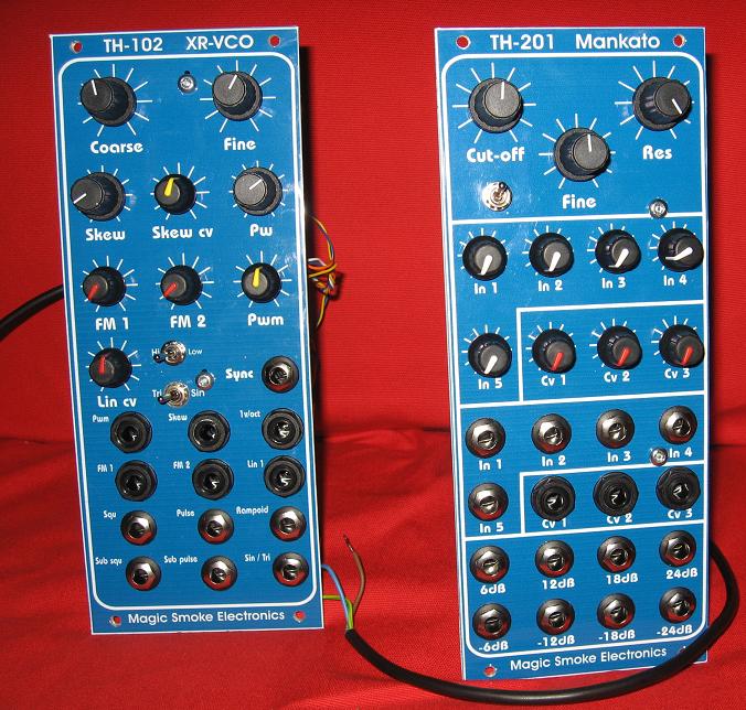

Thanks for the documents Tim , Smile , all wired and assembled into the modular now Very Happy.
both boards powered up fine with no problems Smile , easy to callibrate the Mankato , The XR-vco took a little longer till i read Scott's "Birth of a synth" page suggesting starting at 60Hz.
my results were (musical & very usable Smile , sounds spot on to my ears )
0V - 30.03Hz
1V - 60Hz
2V - 119.99Hz
3V - 239.99Hz
4V - 480.08Hz
5V - 960.10Hz
6V - 1.923KHz
and decided not to upset it by finishing tuning there Very Happy
The Mankato sounds great as well as a standard filter (8 outs - Great Smile ) and as a sine wave monster Very Happy
The unmarked switch on the Mankato is a 3 pole double throw for inputs 1 - 3 dc/ac caps.
These are a great addition to my modular.
i've cobbled together a couple of sounds from them both together below...

Sounds and looks great Dave!
Which outputs of the Mankato did you use in the samples?
Woody
Weblog!
Posts: 1226
Audio files: 161
PostPosted: Sun Jan 09, 2011 4:08 pm    Post subject: Reply with quote  Mark this post and the followings unread
Hi Woody , i had -18 & 24 , into the vca + 2 lfo's into the Mankato cv in's
thanks for listening Smile
Dave.
