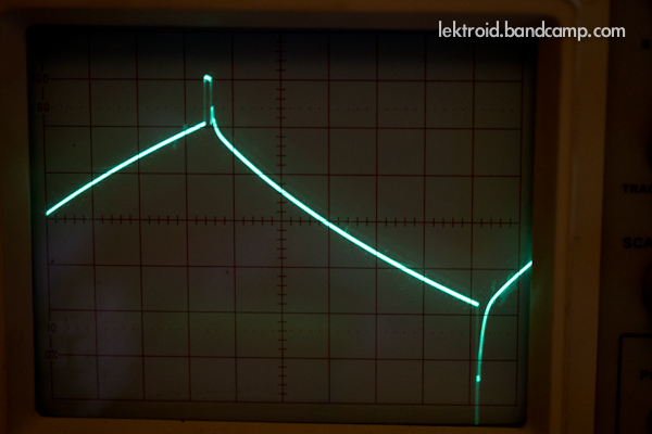

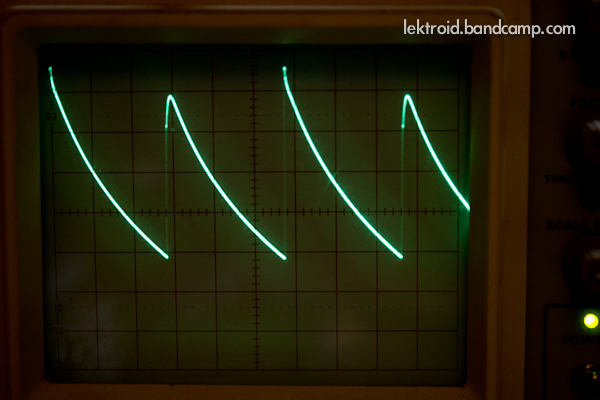

Anyway, I couldn't manage to true the waveform of any of my oscillators. I'll post the photos to see if what I have is normal, or maybe this is an underlying problem that also needs to be sorted. I guess because the square is not a real square, that's why they sound thin compared to my other synths / oscillators?
Sawtooth... This is the best I could get it...

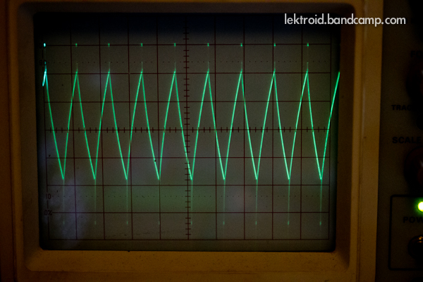

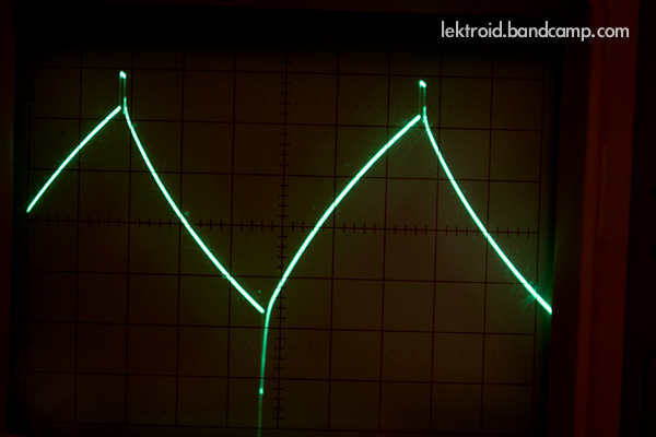

Triangle: After hours of perseverance, this is the best outcome
 Filesize:  161.29 KB
 Viewed:  37761 Time(s)
 Filesize:  160.02 KB
 Filesize:  208.03 KB

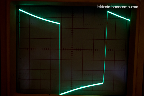

Square, apparently...
 Filesize:  166.64 KB
 Viewed:  37762 Time(s)

PostPosted: Fri Oct 19, 2012 8:07 pm    Post subject: Reply with quote  Mark this post and the followings unread
It looks to me like you've got some kind of extra capacitance on the line, dragging you back to ground. All the waveforms are exhibiting it.
These waveforms are exactly the same whether I use the bench supply or the PSU in the synth (I recently switched over to a dedicated PSU, solely to drive the oscillators; still the same output). I thought it was normal, since all oscillators are exhibiting the same...
So what would be the cure?
