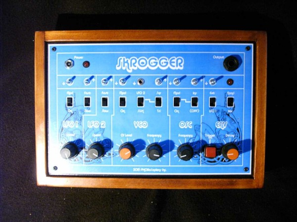

So I'm using them to make a simple (lunetta) synth. I thought about using the 555 for an envelope generator
and the 4069 for a filter but that's not what I did. Instead I'm using the 555 for a VCO and the 4069 (together
with some gates of the 4025) for some (LF-)oscillators. The 4066 + LF351 immmedialy seemed useful for a S&H
but I wasn't sure what to do with the other 3 switches. Eventually I used one for a VCA, which works pretty
much the same as the diode version, and the other 2 as inverters. The 4011 NAND gates are combined
for an XOR-ringmod.
I will post the schematic after it's all hooked up and tested but here's a photo of the frontpanel.

PostPosted: Tue May 12, 2015 7:01 pm    Post subject: Reply with quote  Mark this post and the followings unread
Nice Skrog inspired blue Smile

PostPosted: Wed May 13, 2015 2:10 am    Post subject: Reply with quote  Mark this post and the followings unread
I used the exact same shade of blue as the Super Sequencer panel layout he posted here.
Of course it's not done with the same printer so it might be slightly of but it's the idea that counts.

PostPosted: Wed May 13, 2015 10:58 am    Post subject: Reply with quote  Mark this post and the followings unread
WoW , Amazing Smile Smile , fantastic panel , I like the 2 celtic pipers Very Happy and what a lovely shade of blue, good choice Very Happy Very Happy .
Looking forward to hearing it when it's all wired up .
Excellent work & great use for the chips & slide switches too, Phobos .

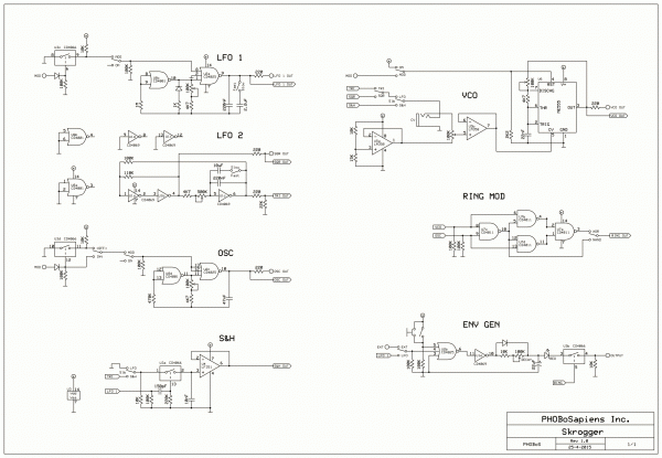

I wired it up about 2 weeks ago,. but I have problem. Apparently making an oscillator out of a 4069 inverter
followed by a 4025 NOR doesn't work Sad. However when I touch the input of the inverter it does. I experimented
a bit on a breadboard to see if I could get it working but whatever worked on the breadboard didn't work when used
in the actual circuit. So I'm a bit stuck, easiest way is probably to just add another NOR chip and replace the 4069 inverters.
(and I need a 3.5 mm socket with a switch contact and some wood for a case)

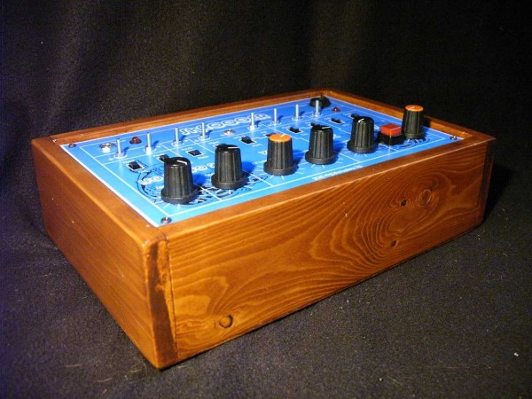

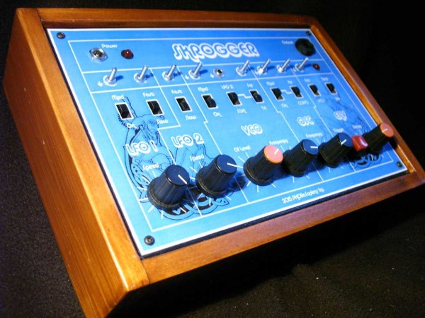

... easiest way is probably to just add another NOR chip and replace the 4069 inverters.
So that's what I did. It feels a bit like cheating since dave didn't send me that one, but I already added an extra opamp too anyway.
(and I fried the original 555, but don't tell Dave)
I used some stained wood for the case this time instead of the usual MDF. And I wanted to record a demo but when I started playing
around with it yesterday I also added some other stuff (as usual). You can find some excerpts of that Skrogging session posted here. Razz
And you can also here it at the beginning (and throughout) Phytoplankton.
Skrogger schematic

Posts: 1194
Audio files: 155
PostPosted: Mon Jul 20, 2015 12:09 pm    Post subject: Reply with quote  Mark this post and the followings unread
Looks & Sounds Fantastic Smile
compress cool salut
I see the red square push for env , just like I use for my adsrs , cool Smile
Does the Skrogger have it's own power supply or is it run from your Raw DC supply ?
The wood case completes the build Smile Excellent construction Phobos , would it be ok to upload you some yellow drum synth patterns I will programme up , for you to multi track / jam some skrogger sounds along with ? .
Smile Dave Smile

PostPosted: Tue Jul 21, 2015 11:57 am    Post subject: Reply with quote  Mark this post and the followings unread
Thanks Dave Very Happy,
Since it's just a simple lunetta synth it works on a DC wallwart and yes I had one of those push buttons I see you using al the time
so I had to put it in the skrogger. It's actually an on/off switch not a momentary but I noticed you can use it as such. So I can
use it as a trigger or just turn it on which basically disables the envelope generator.
