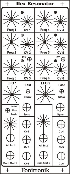

I have finished a test panel design for my 2 triple resonator pcb's that Matthias posted over to me .
In order to get the 2 resonators squeezed onto a single skrog panel ( 100mm x 250mm) I have decided to leave off the individual audio in's & out's and just keep the single in & out sockets for each resonator pcb , a switch on the left near the bottom will switch the audio routing from 2 resonators in series ( input to in1 / output at out2) / 2 separate resonators / 2 resonators in parallel (1 audio to both in's & outputs at both out sockets) .
I have populated both pcb's and now ready to wire the connections , I think I will print off the simple black & white layout and glue to a test panel before ordering the final blue sticker .
more pics as the build goes on Smile .

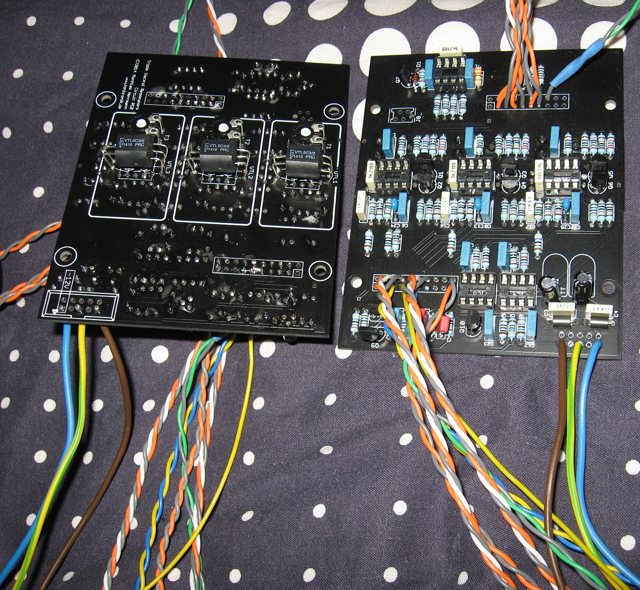

Finally got the wires attached to the 2 pcbs , one thing im not sure about is the J8 terminals on the pcb, the boards are going on a big format panel (250mm X 100mm) , should I leave the J8 as is in the pic ? .
I have a couple of other panels in the design stages , once I get the stickers for all panels im working on , this should come together quite quick Smile
Dave.

Sorry for the late reply. i must have missed the notifications for the latest posts here!
anyays, J8_ is a header for e micromatch connector, which carries the three single outputs and the LFO. it was meant to internaly connect the resonator module to a forthcoming x-pan/fader. so just leave it off (or install a micromatchright away, hehe)

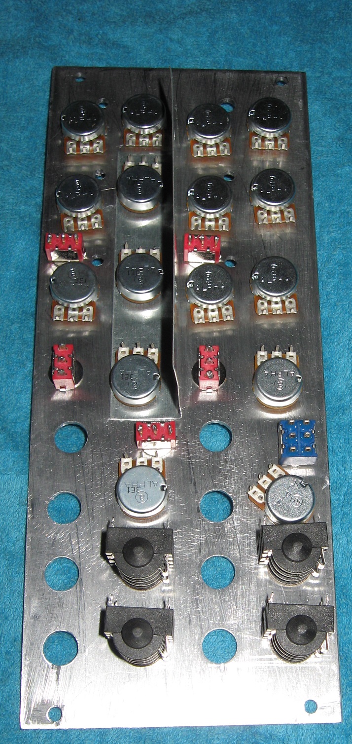

Now got the front good sticker on the panel and the hardware fitted to the 250mm X 100mm X 3mm panel , more sockets due in the post soon to finish the panel , then it's wiring up time Very Happy .
Dave.

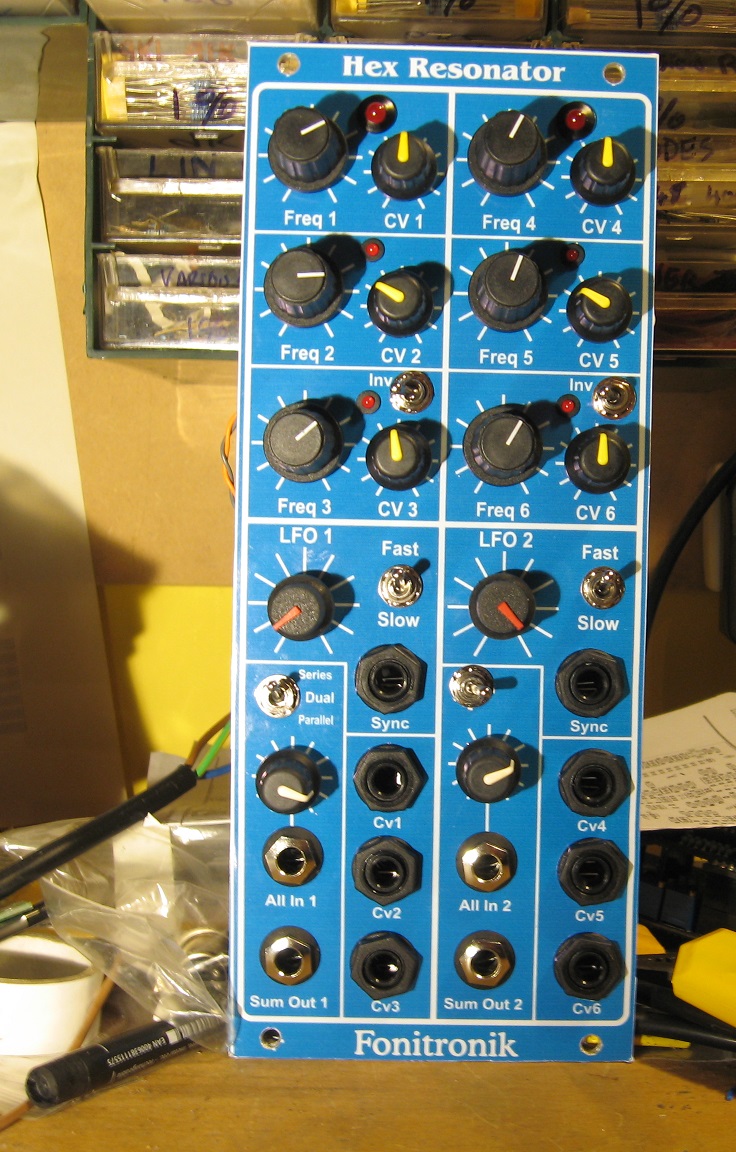

Finished , and it's working perfectly, fantastic Smile
To save a couple of patch leads I installed a on/off/on toggle switch for different modes .
Parallel = filter 1 & 2 both fed from audio input 1 ( a veroboard non-inverting buffer was used to copy 1's input to 2 input) .
Dual = 2 separate filters.
Series = audio into filter 1 input , audio output from filter 2 output.
The un marked switch on the lower mid right is an after thought , switched to the left = all cv inputs receive LFO 1 , switched to the right is separate lfo's.
Why are there 5mm leds on the top 2 and the rest are 3mm leds ???
Someone accidentally used a 6mm bit on the top row before double checking the cross hairs (oooops Wink )
a pic of the front end......
