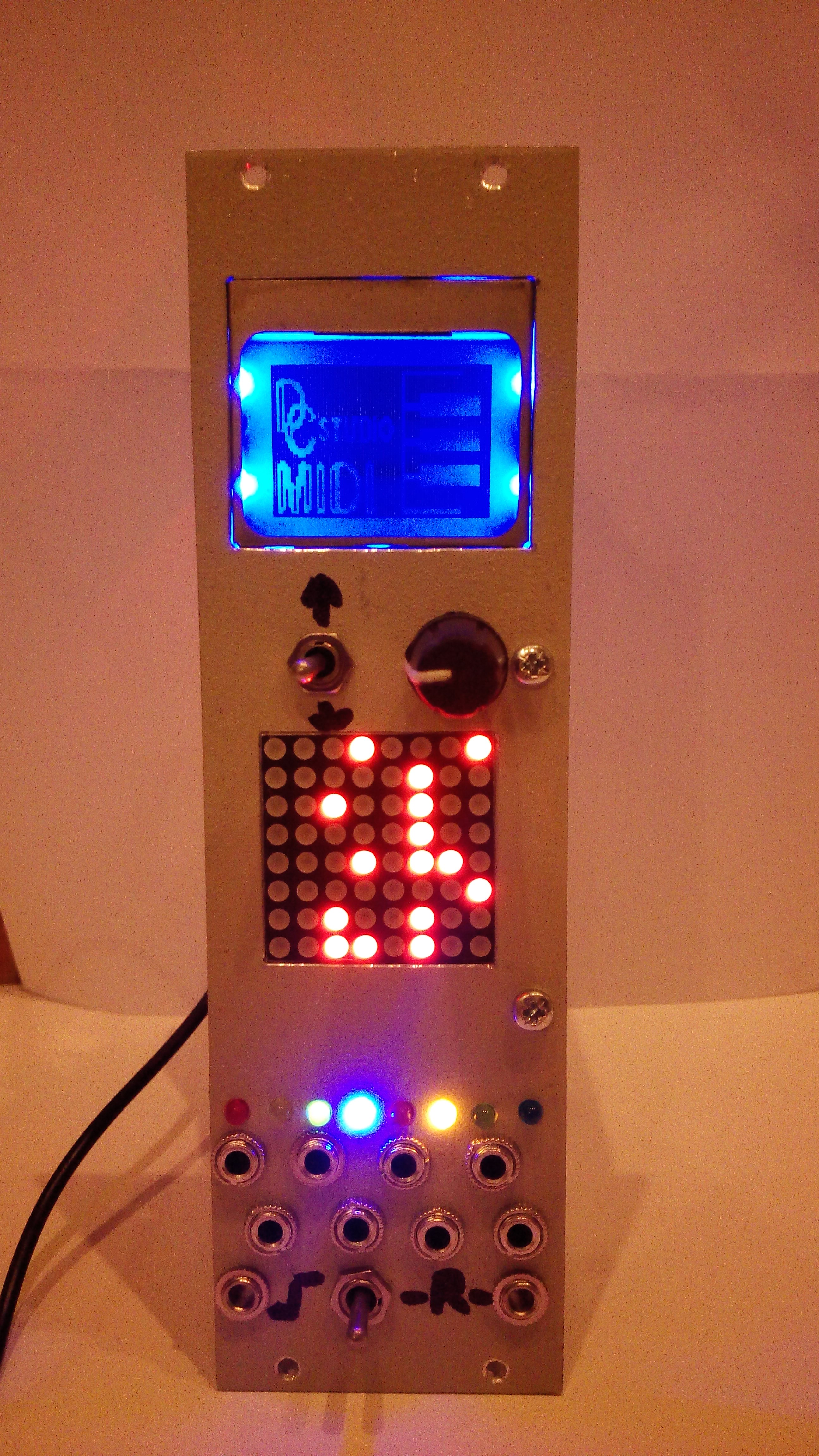

After the keyboard is done, I've made a midi in/out module.
This module also has a trigger/gate section with a repetition time going from 1/64 sec up to 4 seconds, using a knob or voltage controlled.
The output of the trigger out pulse is about 7mS wide (thats half of the minimum repetition time) and the output of the gate out is always 50% of the repetition time.
The midi in/out secion has a opto couppler at the input and a trigger out and a gate out.
The trigger out is short, going high when note-on is received and going low when the velocity of the note-on is received.
The gate goes high when a note-on is received and goed low when a note-off is received.
Also there is a serial signal representing the pressed note and this signal is used thru out the synth as a substitute for a control voltage. (MIDINUM)
And last but not least there is a midi out for future use with a sequencer.

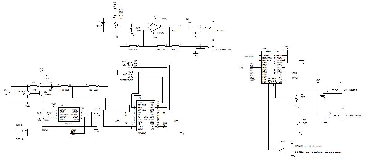

The next board finished is a noiseboard.
It has an (almost) standard transistor noise generator, a clock generator built from a AD9833 DDS chip which is clocked with 16MhZ, then the signal is amplified and fed thru a MAX261 programmable universal filter.
This makes it possible to choose with a three step rotary switch between a low pass, band pass and high pass filter.
Both the center frequency and the Q-factor of this filter are controllable by a potmeter and/or a control voltage (0 - 5V)
The advantage of using this filter is the reaction speed (about 1.5 mS) and it can be set to self-oscillating, which makes it a nice signal source.
The filter is followed by an amplifier to give the signal an amplitude of 0 - 5V and to lower the output impedance of the noise board.
Additionally there is a decoupling capacitor to have the noise swing around 0 V.
The DDS and Filter are controlled by an Improved Arduino Pro Mini.
A switch on the front panel lets you choose between a fixed base frequency, in a way that when the frequency knob is in center position the center frequency will be 440Hz, when the switch is in down position, and the frequency knob is in center position, the base frequency follows the midi signal.
There is one downside by using this filter and that is the bleed thru of the clock frequency when the filter is programmed for a low center frequency.
This filter is built using switching around capacitors and since the max division of the clock frequency is about 200x you start hearing a signal when the center frequency reaches about 40 or so Herz.
Link to the AD9833
Link to MAX261
Link to Arduino Pro Mini
edit: semantics and error in diagram
 Filesize:  68.23 KB
 Viewed:  1452 Time(s)

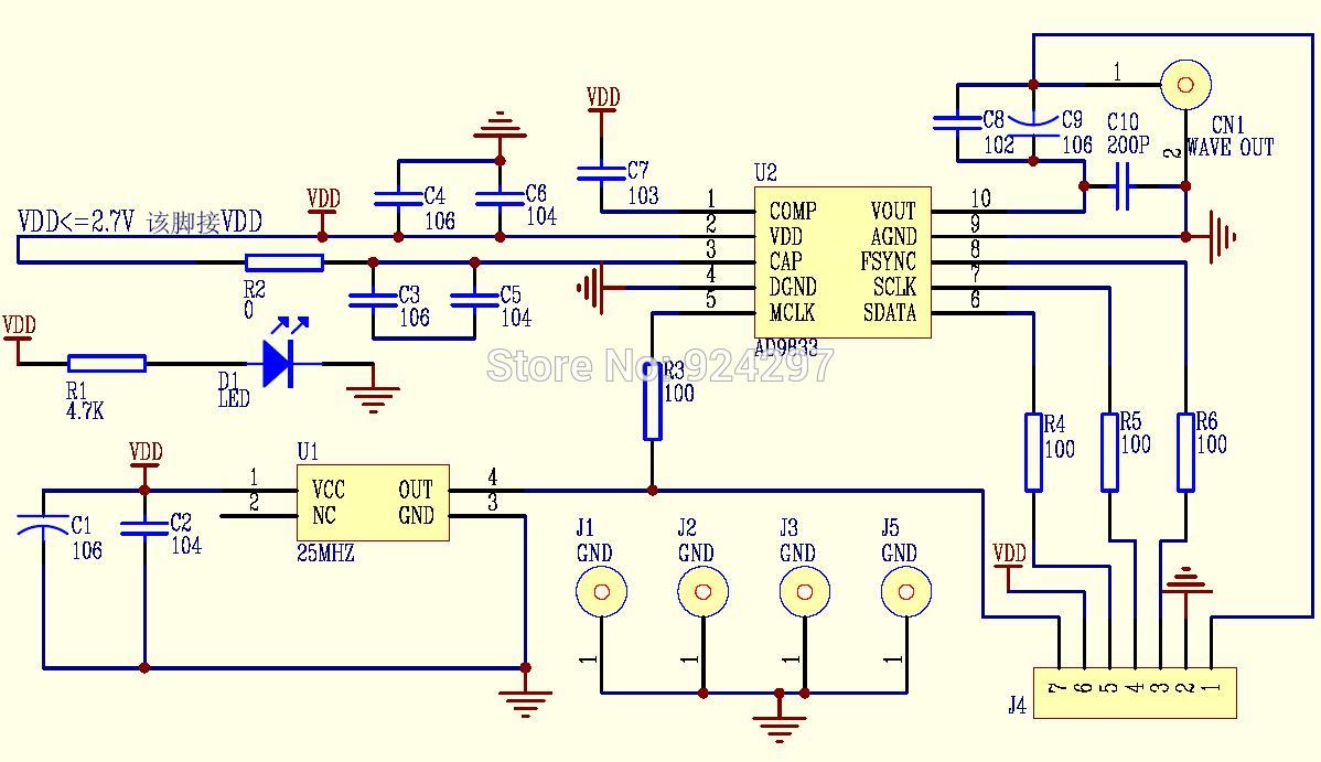

You will see more of the AD9833 DDS chip because I'm also using it on a signal generator board on which I use 4 of these.
They are capable of putting out a sine- triangle- and square wave signal (not at the same time).

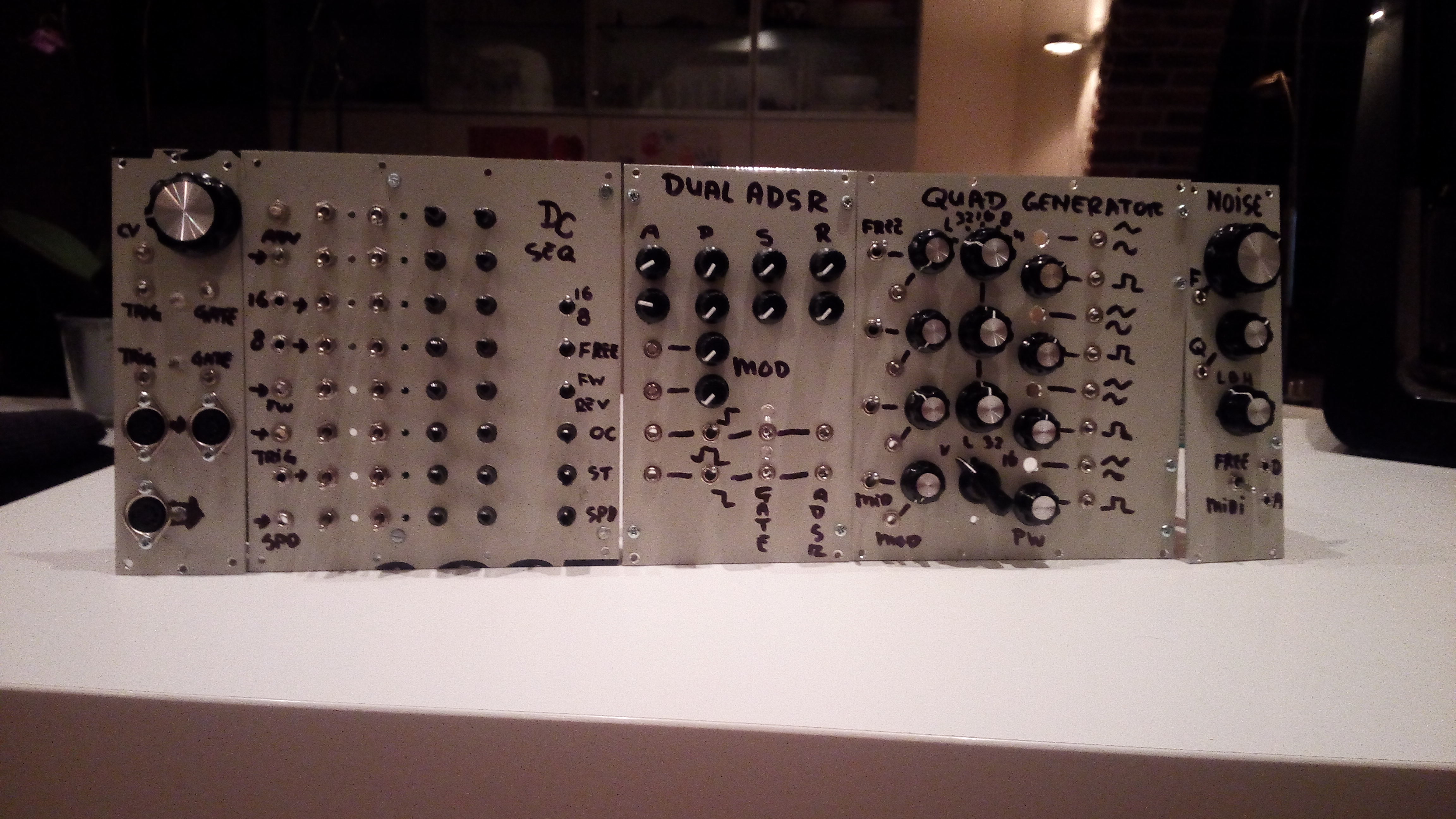

PostPosted: Thu Feb 25, 2016 3:47 pm    Post subject: Reply with quote  Mark this post and the followings unread
Work in progress
Left to right:
1 Midi interface with trigger generator.
2 Sequencer with midi out and/or audio capabilities.
3 Dual ADSR, triggers at leading edge, trailing edge or both. With modulation.
4 Quad audio generator all with LFO, bottom generator will go very low, 0.05Hz. Sine or Triangle and Square with variable (pot) pulswidth 10 - 90%
5 Noise generator with filter LP, HP and BP (self oscillating capabilities), AC and DC output.
 Filesize:  1.52 MB
 Viewed:  1164 Time(s)

Posts: 1310
PostPosted: Fri Feb 26, 2016 6:32 am    Post subject: Reply with quote  Mark this post and the followings unread
Thank you!
My first synth was a non modular synth (see the avatar) but if I knew then what I know now it would have been a modular. It's so much fun!
From the picture above this post only the midi module and the noise generator are finished, the rest is half built or complete pm Wink
First I want to have finished a complete usable synth before starting to build more "unusual" modules like sound processors, drum modules and the like.
So after the modules of this picture are finished I still need a (dual) vcf and a mixer with gain/offset possibilities.

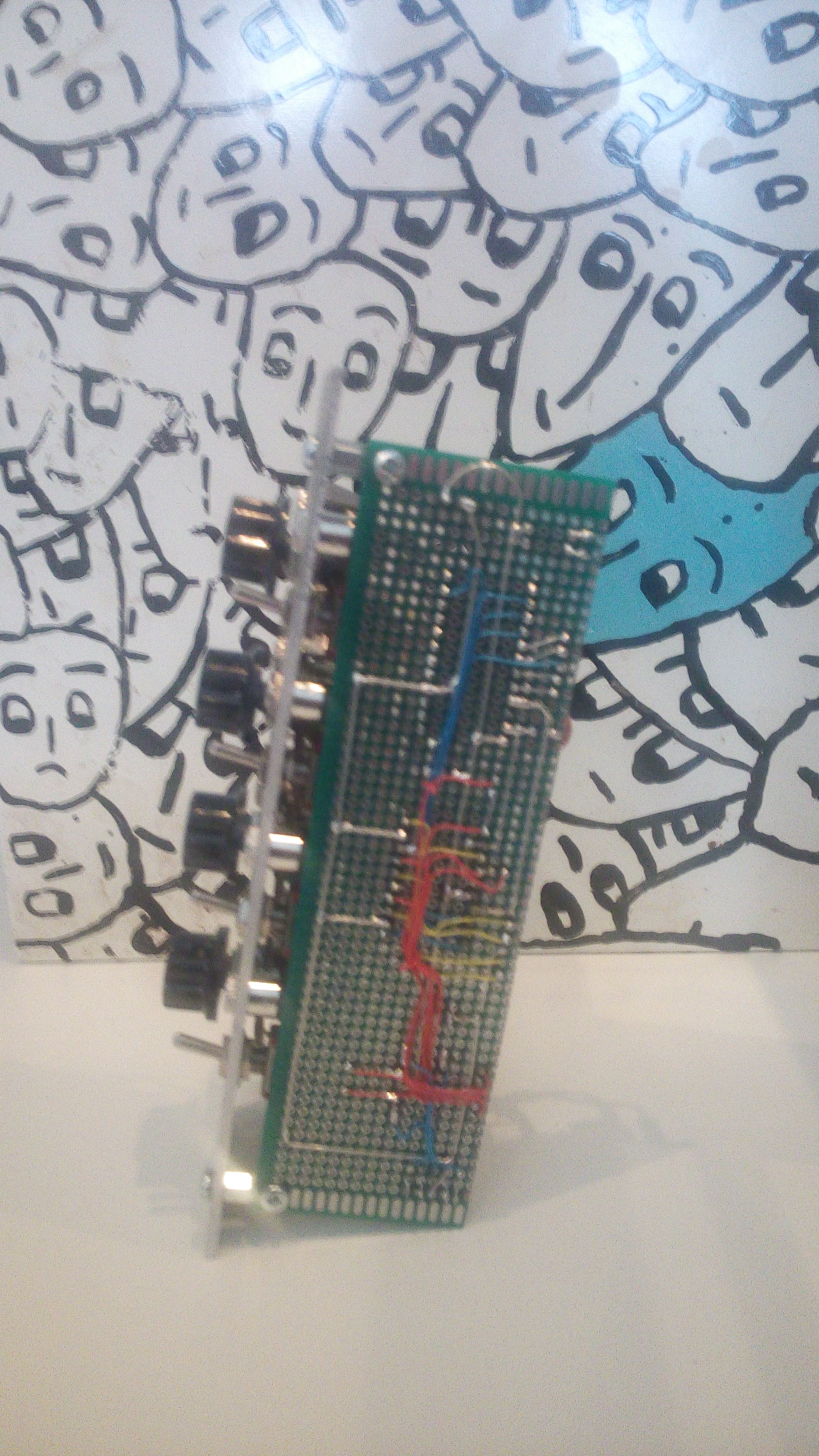

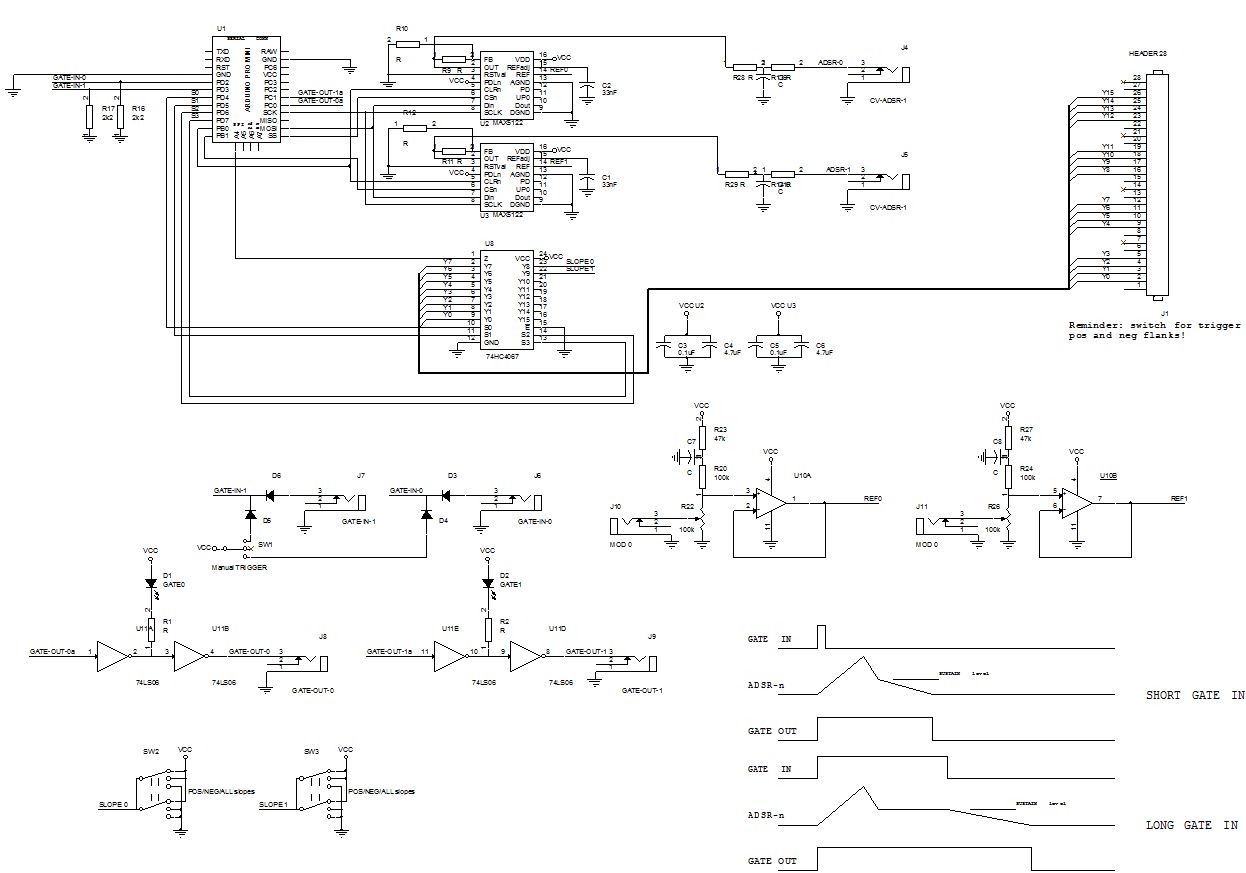

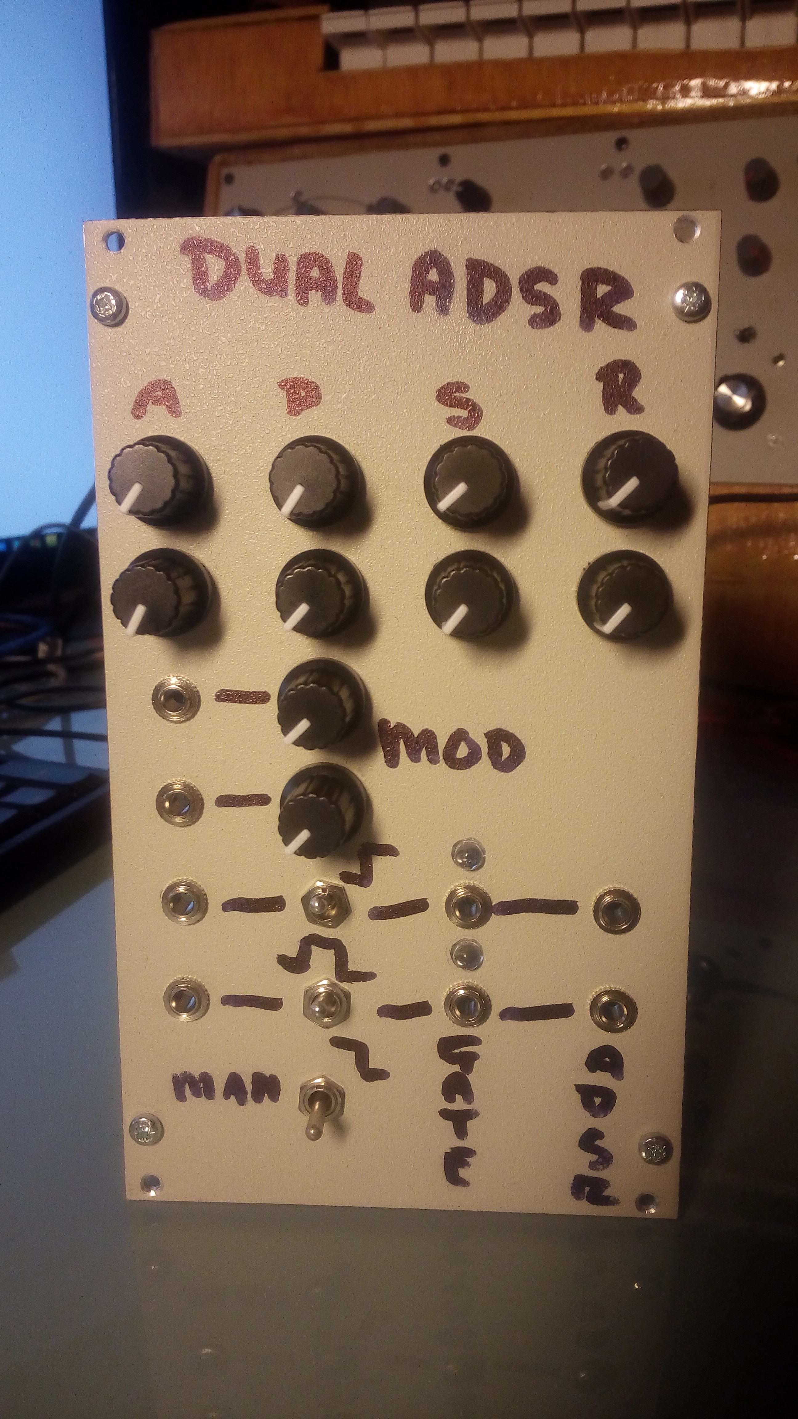

Next unit finished: Dual ADSR.
Each channel trigger able with leading- trailing- or both edges.
Trigger sources are:
1. A short pulse, in this case the signal will go with an (Attack) slope to maximal, then with a (Decay)slope to Sustain voltage and then with a (Release)slope to 0 Volt.
2. A Gate signal, the signal will go with an (Attack) slope to maximal, then with a (Decay)slope to Sustain voltage and will stay there until the Gate signal goes low, then the signal will go with a (Release)slope to 0 Volt.
3. Manual, here the ADSR signal will act as triggered with a Gate signal.
Each channel gives out a gate signal for as long as the ADSR signal is active.
The ADSR can also be modulated e.g. with an LFO.
And it's already a lot of fun, fiddling around with the Gate/Trigger generator on my Midi module, the dual ADSR and the Noiseboard module.
 Filesize:  1.76 MB
 Viewed:  828 Time(s)
 Filesize:  125.31 KB
 Viewed:  1151 Time(s)

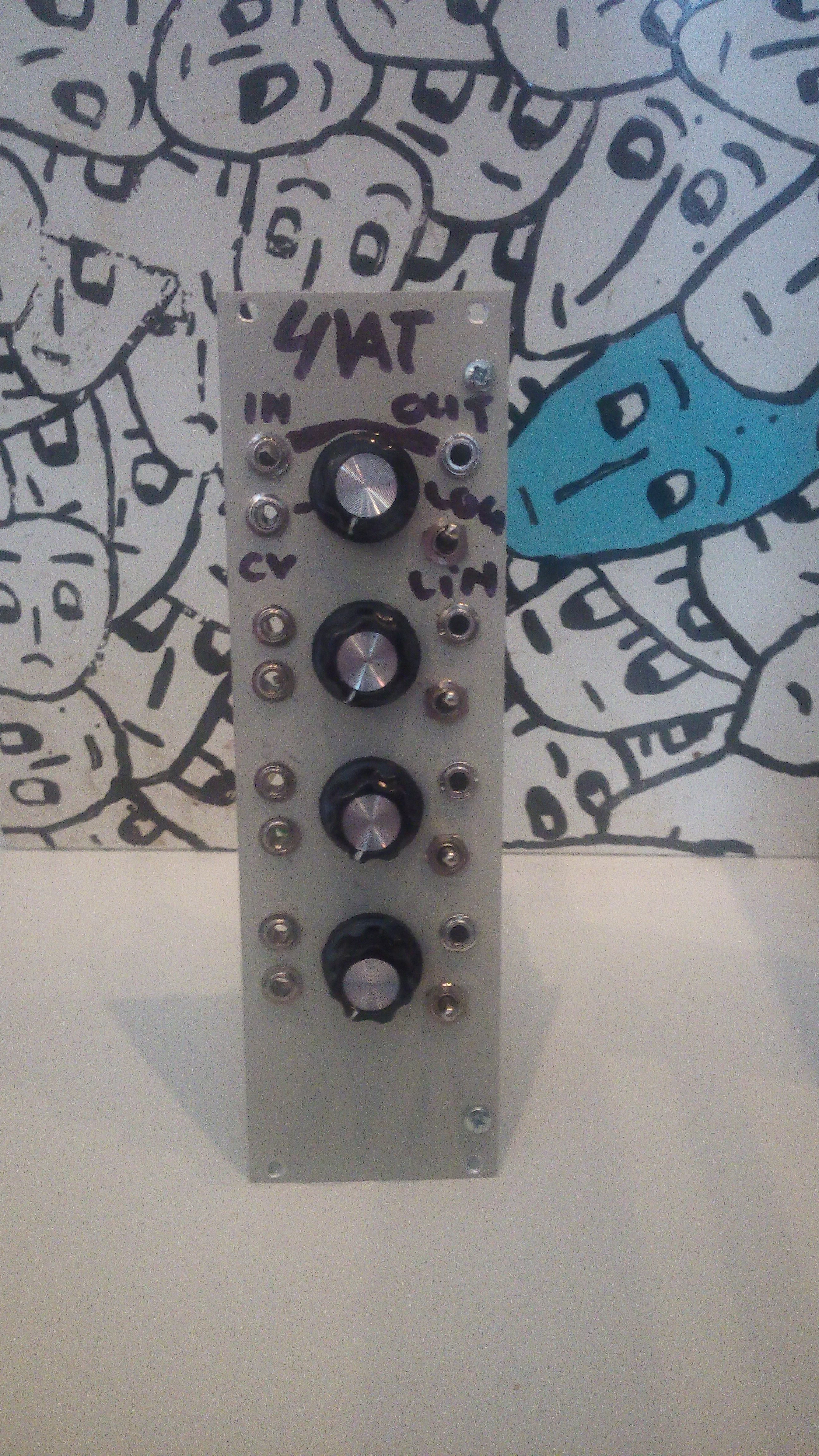

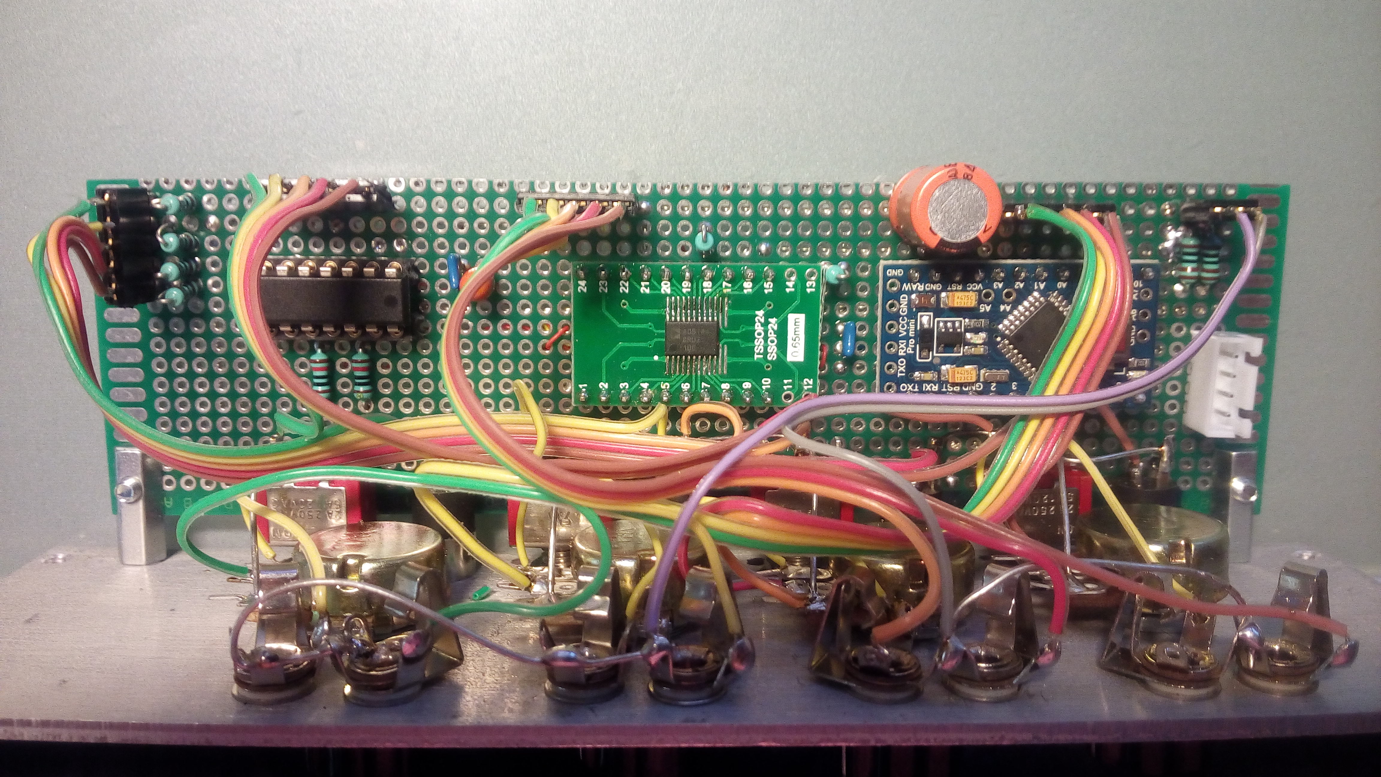

A link about my quad vca is HERE
 Filesize:  2.14 MB
 Viewed:  709 Time(s)
 Filesize:  2.31 MB
 Viewed:  671 Time(s)
 Filesize:  2.46 MB
 Viewed:  661 Time(s)

The AD9833 is a DDS, what stands for Direct Digital Synthesis, Analog Devices has a large number of these type of devices but I like this one the most because it's ease of programming and the low pin-count.
There is one downside though: It's freaking small, so the hard part is not the programming, but the soldering of this chip to convert it to a more diy friendly format.
In order to do this I bought THESE pcb converters.
To get an idea how small the AD9833 really is:
For programming I use C++ on Atmel Studio which can be free downloaded HERE.
(see code)
in the line: ad9833_send(AD_TRI);// set waveform shape the shape is chosen, in this case a triangle shape, but also a sine or square is possible (not simultaneous) and for the square the output will be VCC, but the sine and triangle will be typ. 650mV so they need some amplification and maybe level shifting.
The frequency is set here: ad9833_set_frequency(1500); 1500Hz in this example, but 1500.1Hz is also possible...
The lowest frequency when using the 16MHz from the Arduino as a master clock, will be 0.0596Hz which is also the accuracy for setting the frequency.
The maximum frequency is well in the MHz range, not suitable for audio but definitely very practical for clock frequency generation.
To use the clock frequency of the Arduino a fuse has to be set: in Atmel Studio this one is called LOW.CKOUT if this fuse is set, the 16MHz clock is output to port PB0
edit: since the code keeps getting f*cked up, I added the code as an attachement
The fuses on the Atmega328P as set with Atmel Studio
This is the basic diagram as used in this article
main__basic_628[2].cpp
The code that goes with this article
 Filename:  main__basic_628[2].cpp
 Filesize:  2.94 KB
 Downloaded:  496 Time(s)

Thx Grumble for all this info. It is very inspiring.
I am working on my synth using AD9833 but I'm rather using whole AD9833 modules from China as they are cheaper than chip alone from some suppliers.
I've attached the schematic of such module. Notice that this module version (there are two) has 200pF capacitor from output to ground what kills the signal on higher frequencies so I always desolder them. Nice feature is the 25 MHz clock separate output that can be used to synchronize other AD9833 modules (needs cutting the clock path on the "slave" modules).
 Filesize:  89.6 KB
 Viewed:  477 Time(s)
