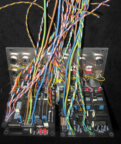

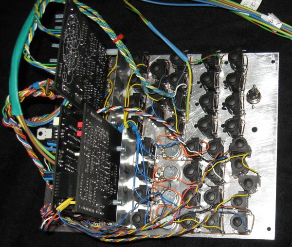

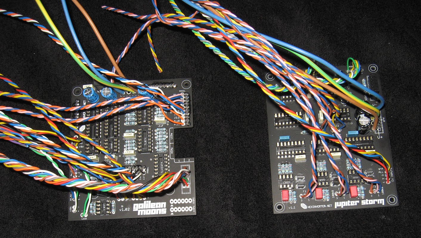

Hi there.
I have been working on the panel layout for these 2 diy pcbs, that I ordered from Hex a while ago. Rather than have two separate single modules I have decided on a double size panel (200m wide by 250mm high).
When I finished the controls layout on corel draw, there was a space free under the Jupiter Storm sockets, I have wanted to use the midi to 8 triggers Elby pcb that came out the old version 1 yellow drum synth (new drum synth has a midi to 24 triggers pcb) and it fitted the space perfect Smile .
Some build pics of the project so far ......
Dave.
 Filesize:  599.05 KB
 Viewed:  379 Time(s)
 Filesize:  439.08 KB
 Viewed:  386 Time(s)
 Filesize:  531.79 KB
 Viewed:  383 Time(s)

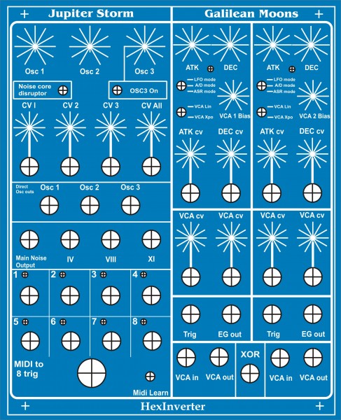

Panel layout for Hexinverter Jupiter Storm & Galilean Moons & Elby midi to 8 triggers.
 Filesize:  1.11 MB
 Viewed:  396 Time(s)

Moons Vca's ....
I wanted an extra cv input for each vca amplitude control, there is 1 input on the pcb for each Vca, so I got the multimeter out , set to continuity beep and I traced vca numbers 1 and 2 cv inputs through inter connects & via holes back to a respective 100K resistor for each input , then simply hook n solder another 100K on the opposite leg from the traced continuity path leg.
Soon be ready to test / calibrate the Jp Storm & moons section , the elby midi to 8 triggers is still to transplant onto the panel after I have the main two going.
Dave Smile
 Filesize:  422.66 KB
 Viewed:  384 Time(s)

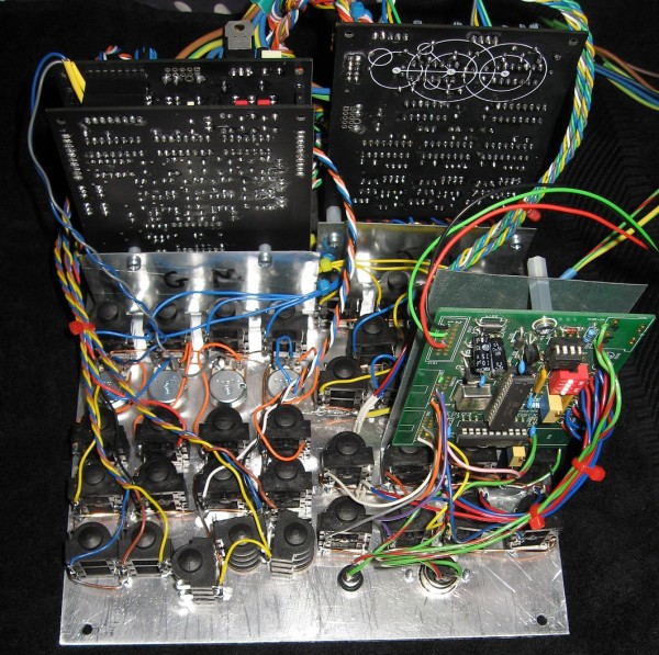

Hi again Smile .
Been soldering yesterday & today , got the Elby midi to SdS 8 trigger pcb mounted & wired in , tested & set up .
Last back end pic before finish & calibration.
 Filesize:  592.9 KB
 Viewed:  397 Time(s)
