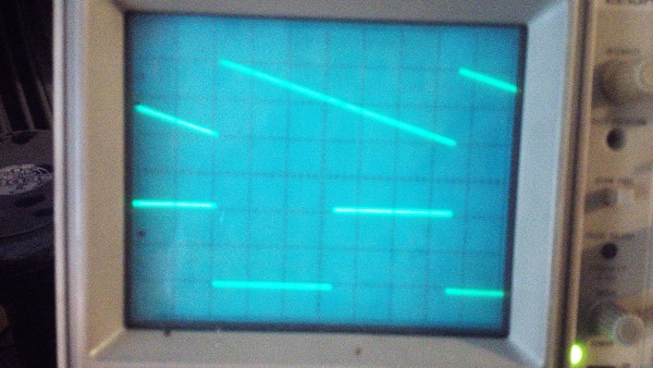

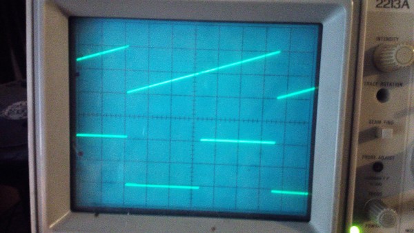

I start to feel the need for a Sawtooth waveform generator because it has a distinct sound, very different from sine, triangle and square waveforms.
I could make one with my sequencer in audio mode, but this will only give about 8 levels of voltage maximal.

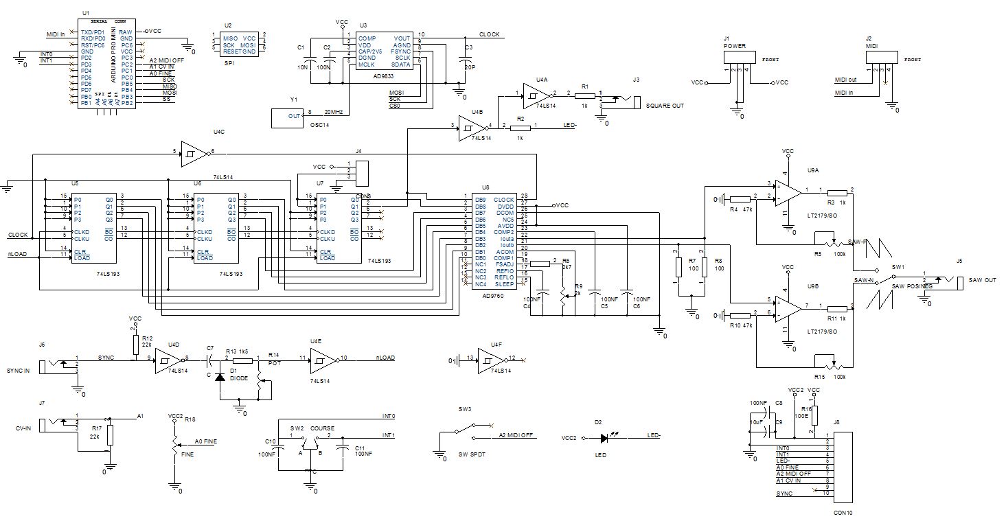

So, in the line of my other builds it will be a module with an Arduino, an AD9833 DDS in square mode to provide the clockpulses for 3x 4 bit up/down counters (74LS193) and a 10 bit DAC AD9760 from Analog Devices.
It wil have a midi(ish) input, a CV (and pot) for frequency shift and a sawtooth and squarewave out.
Question: I have noticed looking at the signals from the sawtooth wave of a Moog that at the steep edge of the waveform there is a very short negative goint glitch.
Is that important soundwise? Will it be audible? Because if it is I will add this glitch to the near perfect sawtooth constructed by the counters and DAC

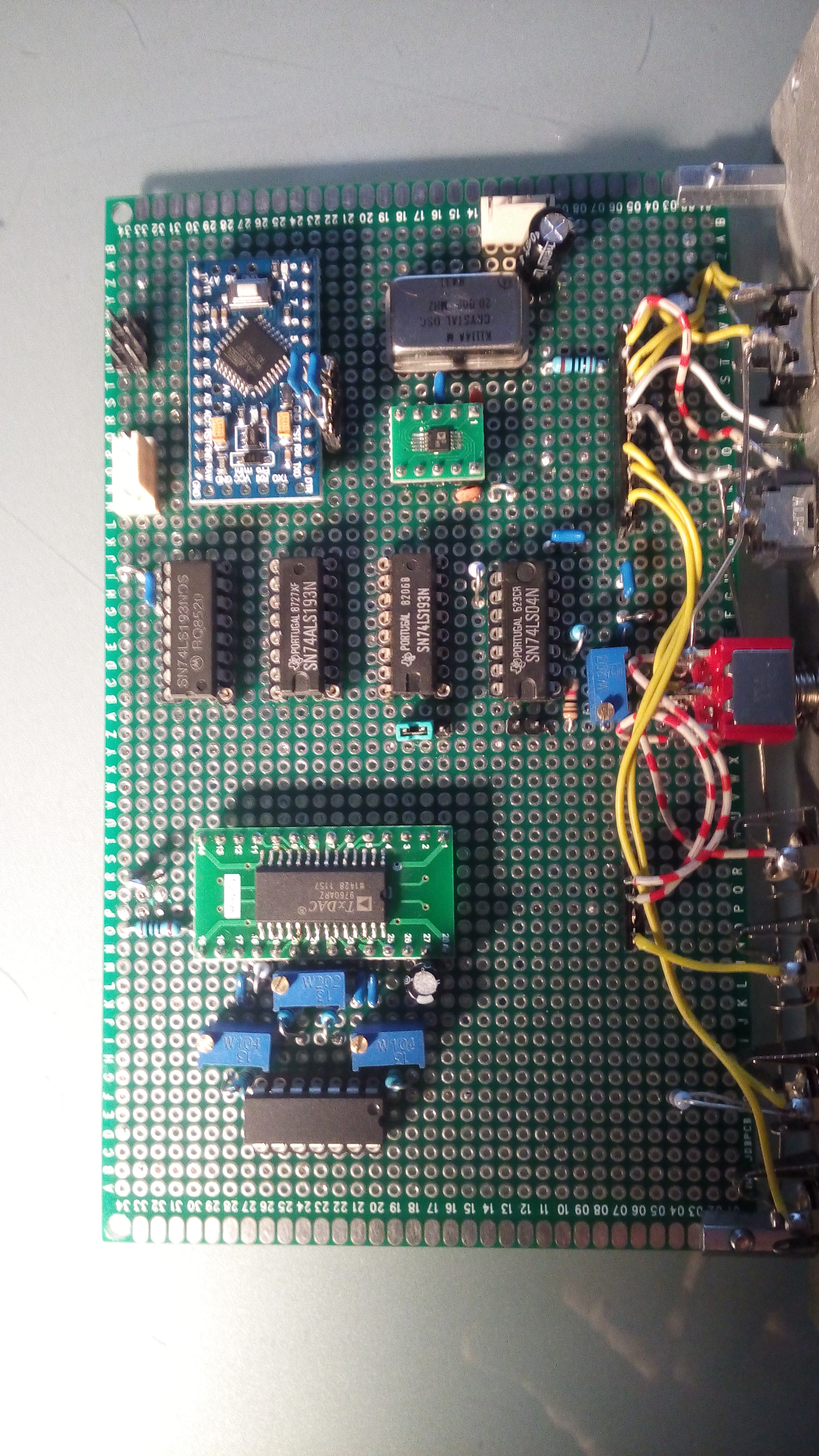

The SAW module is finished.
Sorry, have to go, later more...

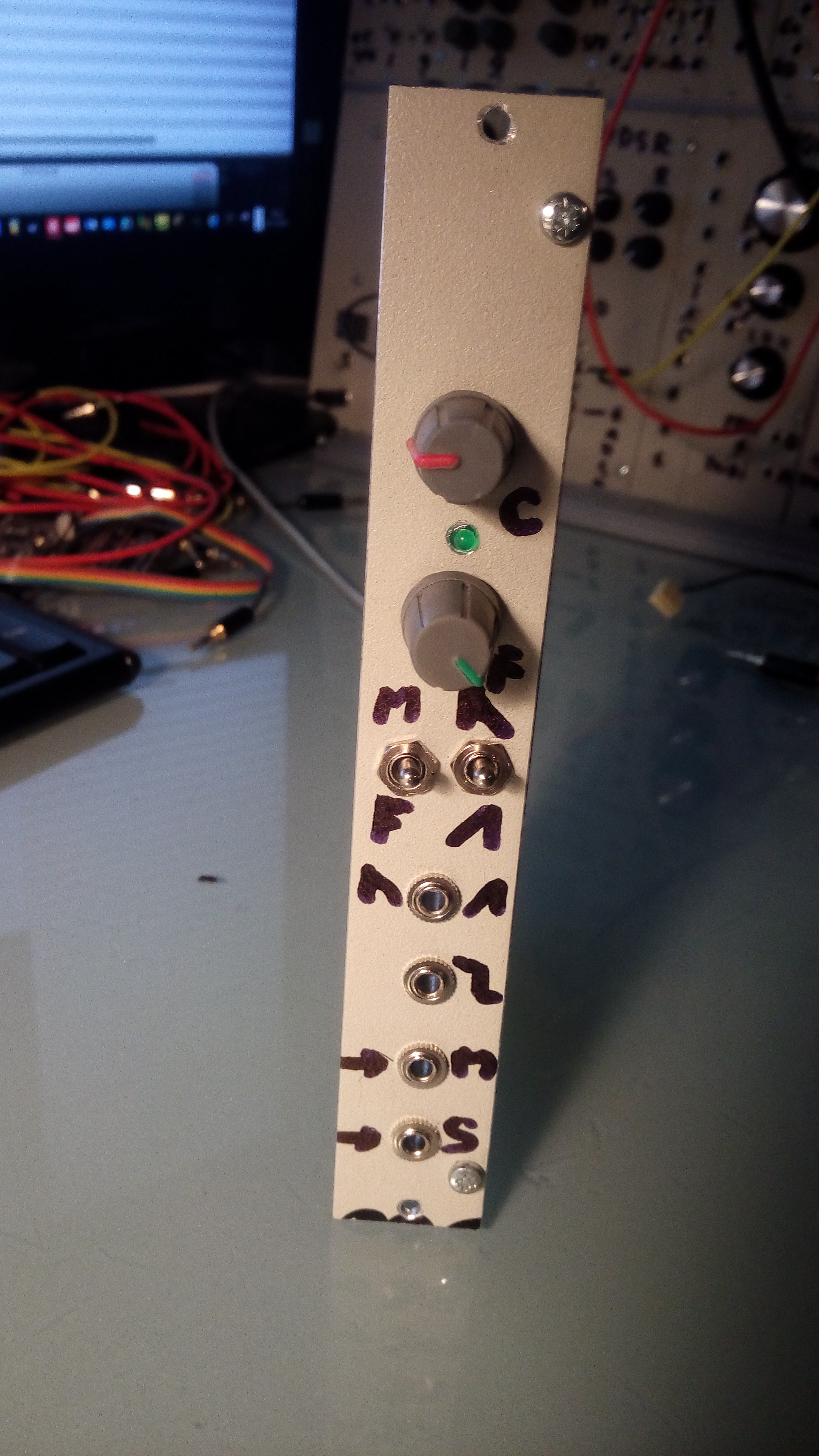

This saw-tooth module basically consists of a counter that is clocked with a DDS. Lowest frequency is about 0.4Hz and max. frequency is about 10kHz.
The top knob holds a rotary encoder, and with every step the frequency is up or down one full note.
The second knob from the top holds a potmeter for fine tuning and will shift the frequency one octave up and one octave down, the same as the CV.
Than the two switches: the left switch will turn Midi-in on and off, the right switch is to choose between a positive or a negative saw-tooth signal.
Below the switches are 4 3.5mm jacks, from top to bottom:
- Saw-tooth output, 0 - 5 volt.
- Square output, 0 - 5 volt, this square wave voltage has the same frequency as the saw-tooth wave and is 50% duty cycle.
- CV input, may be used as CV or as an FM input , input frequency 0 - 500Hz.
-(hard) SYNC input, a negative transition will reset the counter to zero to 766.

PostPosted: Sat Nov 19, 2016 3:29 pm    Post subject: Reply with quote  Mark this post and the followings unread
Yes, it is possible, one way is to use the counter outputs as an address for an eeprom which data is fed to the dac.
In the eeprom you could store the wave table.
But its not a very user friendly type of generator that way.
The DVCO you are mentioning does sounds real good, considering its only 8 bits....

In fact, it's just the way the DDS from Analog Devices work!
Check out the datasheet of the AD983, I use a lot in my synth.
