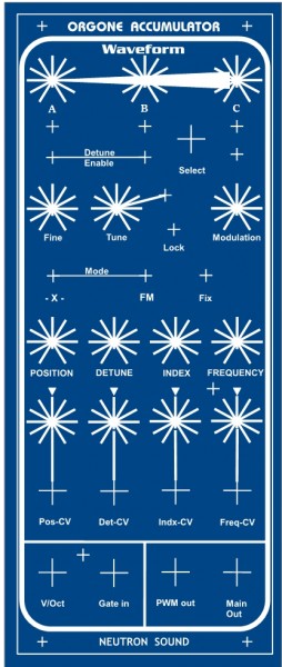

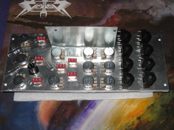

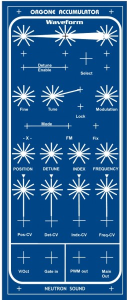

Panel hardware set up on test panel & L plate for pcb in place also i made a few changes to the panel crosses and checked for space around control knobs.
Dave.

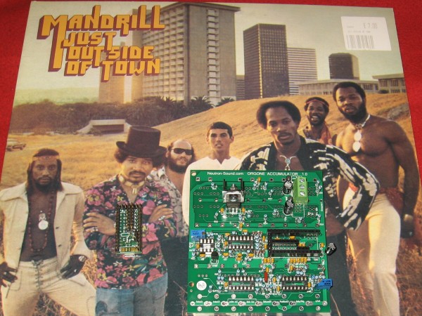

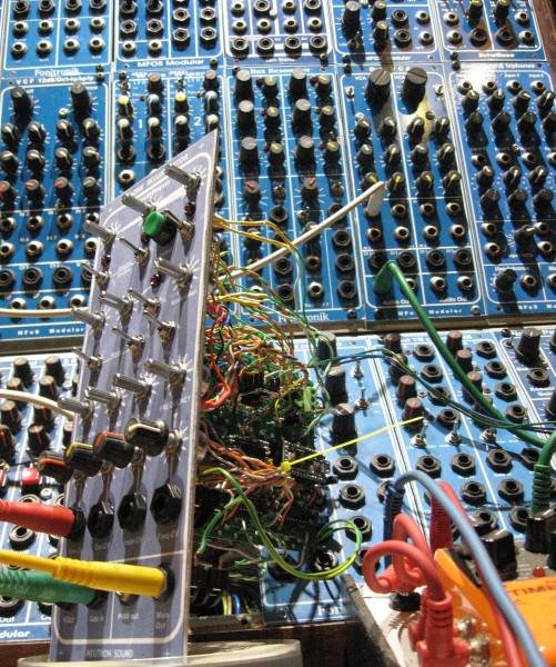

Hi all

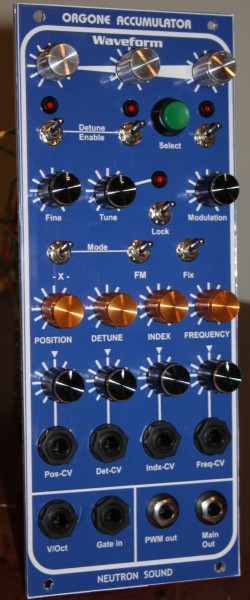

Had a good burst of building over the weekend and got the V1 pcb all wired up and connected to the switches & pots & sockets , done a no-chip power test ... good , popped in the 3v ref chip and checked there was a nice +3v & -3v good again , then went for the op-amps & the teensy board , powered up and no led's , hmmmm, tried turning them around to the opposite of the pcb legend and intrepidly switched on, all good , i done a quick and dirty tune up on the first couple of octaves just for testing purposes and i was feeling myself sliding into a TD tangram / exit album sound zone fantastic my fave
then i checked all the pots & switch operations , i have not fully explored the effects sets , i was having great fun just in normal mode, also i was getting some nice 90's warp records type clicks & drone type sounds .
Once the good panel sticker comes in a month or two i will finish off the sound demo testing of the different effect modes.
Loving this module
Dave.

Hi colorbars , panels ... i go to my local engineering firm to get 3mm thick aluminium sign sheet ( aluminium sheet with a protective sticker on the non scratched side) cut to my module sizes (100mm X 250mm) on their big hydraulic guillotine machine , i then print off a drill template on my home pc printer and glue on to the module plate and center punch all the crosses , i then use a press drill in my shed to work up the drill sizes start with 4mm for all crosses and build up to the biggest needed (12mm for my jacks) , i give the front a light rub with P1000 automotive body emery paper and wipe clean ready to apply the proper final vinyl sticker by de-activating the adhesive with warm soapy (washing up liquid) water, that allows me to move the sticker about to line up with the holes and i just scalpel vinyl crosses out before putting on the pots & sockets.
