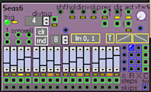

hello, I'm seeking explanation of some of the labels on the Seq16 that the help doesn't seem to cover. I've attached a scaled up image of the module for reference.

I'm wondering about:
* shf input -- shift? what does it do?
* are the outputs below res, dir, and act meant to trigger when their corresponding input triggers?
* How is the 'act' input different from the trigger? Does it make the module inactive?
* what are the '1', 'some', 'all' inputs?
* what are the R and X outputs? Is 'R" reverse? Is that different from inverse?
Thanks in advance!
* Shf is short for shuffle .. it shuffles the values in the sequencer .. swapping them in a random manner.
* yes, those ouputs are copies of the inputs above them .. I forgot why I did that :shock:
* act is the active input, when low the sequencer sequences not, when not connected it is seen as high
* the 1 some and all inputs .. to the left of the clr button they clear 1, some or all steps to zero .. and to the left of rnd button they randomize 1, some or all steps. I use those for a self modifying sequences, often by connecting a step gate output (one of the lower row of lime colored outputs) to one of those inputs, sometimes combined with one of the blue outputs connected to the dir input (which tends to make ping-pong patterns).
* The R outputs are Raw, that is they step unsmoothed (not listening to the xfade controls) .. the X outputs are cross faded from step to step, as controlled by the xfade controls (the knob, and the modulation input for it below it) .. when xfaded those outputs try to do a smoothing from one step to the next .. which works properly only when the sequencer is clocked at a constant rate .. as it does speed prediction from the clock input.
I will add an example patch, but I'm not sure it will work in the currently published version of Wren .. as I'm a bit ahead of that ... but here is a screen dump too (notice the coonections to the 'rnd some' inputs):
