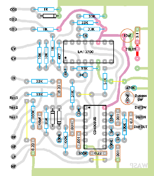

Will an LM13700 work to replace the two CA3080's in the Wasp filter? I don't know. I seem to recall guys using them in their DS-7 clones.

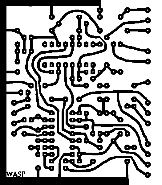

Anyway, I made a layout to try. I feel funny posting this among the pro looking PCB's you all fashion, but what the heck. Maybe the electrons wont mind.
This is the Juergen Haible version. Check his site and pick up the schematic here (you'll need it):
http://jhaible.heim.at/tonline_stuff/hj_wasp.html
The PCB will need to be flipped for PNP. Resize to 600dpi or 6 X 6.84 cm or 2.362 X 2.693 inches. No resampling.
Sorry for not testing this.

Should work. I remember seeing something in electronotes about the 13x00 being a drop in replacement for the 3080, as long as you overlooked the new features (diodes at the inputs, output buffer).
Posts: 3944
PostPosted: Thu Nov 26, 2009 2:05 am    Post subject: Reply with quote  Mark this post and the followings unread
IIRC it is partly even the same IC layout, just with some add-ons (diodes, buffers).

I didn't make this PCB, but I made two Wasp filters following the schematic and replaced the 3080's with LM13700. It works fine. Apparently it is the exact same IC on the inside, but a few extra features in the LM13700.

Only a few years late, I can confirm that the layout works Embarassed
The board was etched and populated about five years ago. This weekend I went into a troubleshooting spree and finally discovered that I had installed a wrong regulator. After fixing this and a bad trace to the resonance pot (courtesy to my etching skills) the filter rocks! Thanks for the layout ickystay Cool
