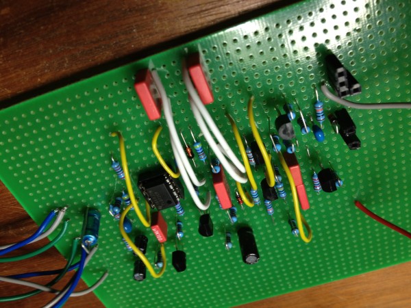

Hey All,
The last couple of weeks I've tried to get this strip board up and running but I'm afraid I'm stuck.. I was wondering if somebody who has finished this board successfully can give me some voltage values at some points on the board so I can track down the problem.
First, my setup:
- I've build a +/- 12V power supply and connected it to the stripboard with an extra +12V going into the accent
- the trigger is connected to a Highly Liquid MD24 board output (which gives +5V pulses, i've checked that)
- I've plugged in the output into my mixer
I've measured the voltages on the TL072, and they read + and -12 on pin 4 & 8, so that is getting power. However, I don't see anything coming out of T3. There is +12V on the collector but the base isn't getting anything from the trigger (I think.. Smile )
Anyway, I was wondering, in this thread I've read something about supplying voltages to some points to manually trigger this circuit, but what points should that be?
Thanks in advance!

PostPosted: Wed Mar 06, 2013 7:12 pm    Post subject: Reply with quote  Mark this post and the followings unread
Hey Gerbster
You need a momentary switch between +V and the normal trigger input point

PostPosted: Thu Mar 07, 2013 6:44 am    Post subject: I'm an idiot Reply with quote  Mark this post and the followings unread
Well, it turned out i'm an idiot. After building a complete new 808 BD pcb from scratch that DID work i found that... I connected the output wire to the wrong pin of my output socket.
so now i have 2 fully working 808 BD's Wink But thanks for your replies.

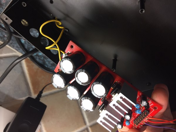

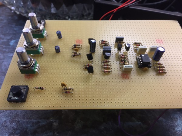

Hello all.
My first post too.
I just wanted to say, what a brilliant thread. Well done for all the hard work put in by everyone. Thank you LektroiD. Thank you to -minus- for the layouts. elmegil thanks for the helpful tips and comments too.
You have given me the confidence to try my first project ever. I'm have begun with the Kick module only, and move on to the other modules later. I have attempted the Kick module on perfboard as per Eric Archer's layout.
http://www.ericarcher.net/wp-content/uploads/2014/07/tr-808-bass-drum-diy-project.pdf
I make music by sequencing in Logic and at the moment I am content with making a few boxes, that spit out a drum noise at the push of a button, then I can sample them and work into a track.
Therefore I have added a momentary push switch to ‘trigger’.
I have read through this post and the specific kick drum thread. But I have completed my wiring and have no sound. I’ve double checked all components and wiring and all seems correct.
Now for my (probably very stupid) questions:
1. Is the problem my momentary push switch not creating the correct kind of trigger?
2. Should I be connecting ‘out’ and ‘gnd’ to the output jack? Does polarity matter?
3. Sadly out of stupidity I wired this circuit up with AC 14V. I now have wired it up with 12V DC. But I’m so confused. A friend who knows more than me said, a simple 12V DC won’t work it has to be Dual +/- DC. I now am so confused as to power supply. Please advise.
Thanks for any help in advance.

PostPosted: Wed Oct 18, 2017 12:24 pm    Post subject: Reply with quote  Mark this post and the followings unread
You definitly need a transformer + dual power supply, you can't achieve that with the one you have. You need a transformer that outputs 2*15v AC or 12v. Then a simple power supply converts it to symetric +15V/-15V DC
Google "dual power supply" you'll find a lot of schems.
To test the triggering tie the accent to +V, then you could trig with any kind of voltage from around 3V to 15V.

PostPosted: Wed Oct 18, 2017 1:09 pm    Post subject: Reply with quote  Mark this post and the followings unread
Thank you lysergist. Thanks for the speedy reply, I had been scratching my head on this for ages. I have a undergraduates physics degree but had never heard of a dual power supply.
So the best option is to DIY the power supply too?

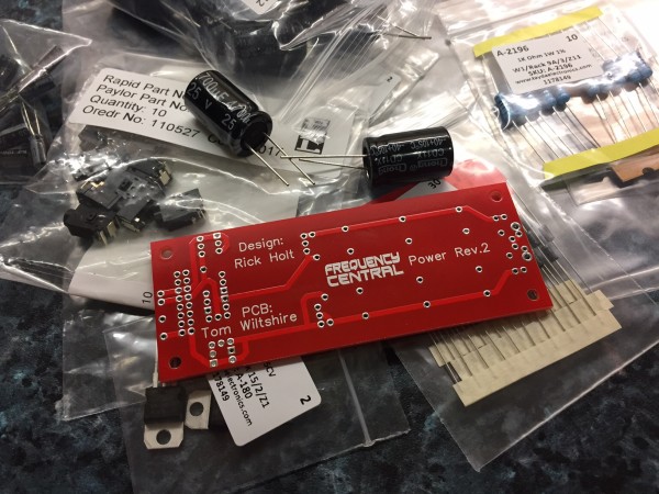

PostPosted: Thu Oct 19, 2017 2:32 am    Post subject: Reply with quote  Mark this post and the followings unread
An easy way to make a dual supply would be to use an AC wallwart (not DC) of 15...18V. Some excellent information on
how to use it to create a dual supply can be found on the MFOS site here. (use LM7815/LM7915 instead of LM7812/LM7912).

Excellent thanks for the advice. I have found similar info on DIY powers supply here.
http://www.frequencycentral.co.uk/?page_id=894
I guess these are pretty much the same?

Got my DIY power supply last night... made it, hooked it up to my 808 BD, all excited, and...
NOTHING
I had to change all the transistors as I possibly damaged them when I hooked it up to an AC supply like an idiot, before it was pointed out to me what a bipolar supply was.
BOOOOOOOOOM! it worked.
However, I noticed in my replacing the transistors a ground jumper had come loose. When I Resoldered it... Nothing again.
Disconnect it and it works again. The Ground is connecting C1, R20, R25 in the schematic below. Are they necessary? It works without them.
I will say it does seem a little noisy... Is it affecting the gain some how? So I have a high signal to noise ratio?
On a different note; is there a good mod to get more drive/distorsion?
Something like a pot between +15 and the op amp?
I think C1 is used as a filter capacitor to filter out any high frequency noise, so the circuit works without it but might
produce a bit more noise and maybe it also prevents some unwanted oscilllations.
R20 biases the base of the transistor to GND. If the circuit isn't producing sound and R20 isn't attached then the base
of the transistor is basically floating because of C9. In practise a capacitor does not have an infinite resistance and the
base of the transistor isn't completely isolated from the emitter so it isn't really floating (which would also amplify noise).
I think if you look at the signal on a scope you will clearly see a difference in the output signal with or without R20 though.
R25 biases the output to GND but this is also done by anything you connect it too unlesss it has a really high impedance.
It should elimate any pops when plugging something into the output but for the rest the circuit should work just as well.
