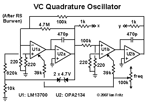

Hello --
Many years ago I "invented" a "new" VC quadrature oscillator. A quite simple circuit, it was just a pair of cross-coupled VC integrators, with positive feedback around one of them to build up the oscillations, which reached a maximum when clipped by the power supply rails. This was written up for EN, but not pursued. A couple of years ago while developing my chaos circuitry, I noticed that a nice quadrature oscillator could be built using some of my nonlinear chaos circuits. This I put up on my website and mentioned it on s-diy. Immediately I was contacted by Jim Patchell, who pointed out that he had published the same circuit in Polyphony, 25 years previously. Embarassed Shocked Embarassed
Jim's circuit was based on an original design by RS Burwen, published in the AD Nonlinear Handbook (page 80 in the 1974 edition, but several years older than that).
A current incarnation is shown below. This core requires only two chips: a dual OTA and a dual opamp. No slicing, dicing, pasting, filtering, or any of that. The positive feedback path is provided by the 4.7M resistor and negative-feedback limiting is provided by the back-to-back zeners. I was surprised tonight when I measured the spectral response of a 400 Hz tone. The second harmonic is 60 dB down from the fundamental and the third is down 55 dB. I didn't even look for more. The amplitude is very flat from 8 kHz down to about .3 Hz. Below that the amplitude falls off by about 20% at 0.1 Hz. With larger caps I got good flat response from 800 Hz to .02 Hz, where I got bored with watching the scope.
So why hasn't this beautiful circuit been widely adapted? Who knows. Confused
One EN author criticized it for being unstable. Based on my experience, I don't think this is warranted. Perhaps it got confused with the crank-up-your-filter-Q type oscillator, which can be a bit touchy. But is it stable? You bet!
[extrreeme geekjabber]
The system solves the following nonlinear differential equations:
x' = a y + b x - c x^3 ; y' = -a x.
A quick stability analysis shows that this system undergoes a supercritical Hopf bifurcation as "b" changes from negative to positive. With the cubic term stabilizing the orbits, the system exhibits a stable limit-cycle attractor.
[/extrreeme geekjabber]
Well, maybe I'm just missing something. Perhaps one of you whiteboard wizards would like to give it a try?

Hi Ian
It seems that this schemo is bugged, I reckon that the two 220 ohm resistors shown in parallel at the inverting input of the second OTA (U1b) should be separated, one being connected to the non-inverting input U1b (voltage divider with the 100K resistor...)
Yves

yusson wrote:
Hi Ian
Arrrrghhhhh. I'll get it fixed. Thanks.
Edit -- error fixed.

Well, we don't need the fancy math theorems to understand how it works. If you have just the cross-coupled integrators, then each signal is (+) or (-) the integral of the other, so the signals are sine and cosine functions. Ideally they could have any amplitude. But in a real world system there will be damping, offsets, etc., so the system will damp out to zero or else fly off to the rails.
To stabilize the amplitudes, two feedback signals are added. Positive feedback (the 4.7M resistor) ensures that small oscillations will grow in amplitude. Eventually they will be limited by the rails.
The second feedback is provided by the two Zener diodes. When the signal amplitude gets above ~5 V, the diodes break down and the resulting negative feedback prevents the oscillations from growing any further. At some amplitude these "push" and pull" signals balance out to give a stable, fixed amplitude signal. As long as the feedback signals are weak, the oscillations are very nearly sinusoidal.

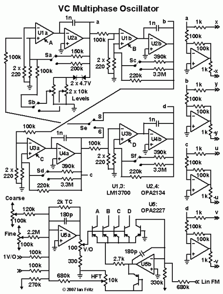

The full-blown, switchable six/eight phase generator is now breadboarded, tested and tracked. Both go down to below .02 Hz and up to 3-4kHz at the top end. This is a better than 5-decade response, which is about as far as I like to push an OTA. A full range unit could easily be done using a cap switch.
Again, just three chips for the basic quad unit, or five for the complete 3/4/6/8 phase unit. Very Happy
I'll try to get the full circuit drawn up in a couple of days.

PostPosted: Tue Aug 14, 2007 6:40 pm    Post subject: Full circuit, 3/4/6/8 phase generator. Reply with quote  Mark this post and the followings unread
Here is the full circuit as it now stands.
Just a word about operation, since this kind of system seems to be widely misunderstood and is rarely used the EM world.
At first glance this looks like a four-pole filter with feedback. But look again -- it is really quite different and more subtle than that. The difference? This circuit has negative feedback around each individual stage. The feedback resistors are carefully -- painstakingly actually -- chosen so that the linear part of the system (small signals) oscillates, but just barely. On startup the oscillations build up slowly over dozens of cycles.
At large signal amplitudes the zener diodes begin to conduct, adding additional negative feedback that prevents further growth in amplitude. In other words, large amplitude signals decay over time. The subtle and delicate balance between these opposing gentle forces cause the system to perform stable, high-purity sinusoidal oscillations at a finite amplitude. The amplitudes are adjusted by the two "Level" trimmers, which vary the strength of the nonlinear feedback.
Contrast this operation with that of the four-pole filter with feedback. In that case the positive feedback is highly regenerative and the first stage is clipped by the hard limiting of the power supply rails. The subsequent stages filter this signal somewhat, so the second and fourth stages can be used for a crude quadrature oscillator, but distortion is still quite high.
In the current system, all four stages give sine waves that look the same on a scope trace. This means that all stages can be used, yielding an eight-phase oscillator, rather than the usual quadrature signals obtained from the regenerating four-pole filter.
The six-pole switch (Sa-Sf) allows a choice between six phase and eight phase operation. Using alternating outputs give three and four phase operation.
Next I will be working on soldering this circuit up so I can free up my whiteboard for the part of the project, the development of an eight stage dynamic wave scanner.
Stay tuned. Very Happy
Ian

andrewF
Joined: Dec 29, 2006
Posts: 1176
Location: australia
PostPosted: Mon Aug 20, 2007 6:48 pm    Post subject: Reply with quote  Mark this post and the followings unread
Thanks Ian
i was going to try the basic version, but am very happy to put together the extended version.
i don't see 6 pole switches very often, would it work to use SPDT cmos analog switches(....and then drive them with a gate input)?
cheers
frijitz
Joined: May 04, 2007
Posts: 1734
Location: NM USA
Audio files: 54
PostPosted: Mon Aug 20, 2007 8:23 pm    Post subject: Reply with quote  Mark this post and the followings unread
andrewF wrote:
Thanks Ian
Great! I'm having a lot of fun with the 6-phase right now. There is no end to what you can do with wave mixing, and it sounds pretty good, at least to me. I'll get some clips up soon.
CMOS switches should work OK, I think. But Mouser has the inexpensive Alpha rotary units:
105-SR2511F-62RN
Good luck!
Ian

PostPosted: Fri Aug 24, 2007 9:57 am    Post subject: some 6-phase demos Reply with quote  Mark this post and the followings unread
Here are three audio clips of the 6-phase scanner in action.
The first clip demonstrates straightforward scanning among three slightly different waveforms.
The second involves varying the timber of four waves using four stages of the scanner..
For the final clip, the scanner is used to vary the amount of vibrato (FM) of three VCOs along with the modulation of two VCF's and a VCA.
Lots of interesting uses for this unit beyond just audio signal scanning.
Ian
