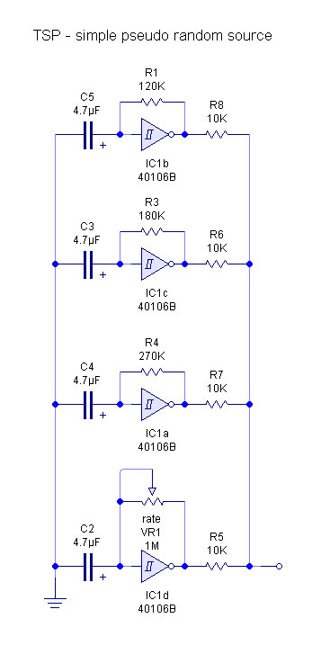

The core of any Lunetta system are the oscillators. Lunettas use only square wave oscillators, usually made by very simple logic. Typically, Lunetta oscillators have a relatively limited frequency range - just a couple of octaves - because the circuits are so simple. That is much less of a problem than it seems, because most of the frequency setting is done down stream though various other circuits. Thus, while a good Lunetta oscillator does in fact have a frequency knob, the are used more like clocks than a conventional VCO in an analog modular system.
Bugbrand already posted a nice appropriate Lunetta style oscillator which I'm reposting here to get things started off. (Click on the pic to see it full-sized).
This is a good one to start with, The main OSC uses a single inverter with an RC (Resistor Capacitor) network to set the frequency of the OSC. The sync out is a nice bonus with this circuit, but the sync feature is not necessary.
There are other variations of the inverter OSC which I hope people will post here. Also, this topic is a place to post questions and comments about oscillators built with simple logic.
Note, it is possible to use an analog VCO with a Lunetta, but this can present problems with interface circuits. For example, Digital logic likes input swings between 0 V and Vcc.
So, let's see some more oscillators here and questions and discussion.

mosc wrote:
For example, you make simple oscillators using digital inverters with RC networks. If you uses NAND gates instead of inverters, you get some sort of neat modulation when you hook up another oscillator to one of the free gate inputs.
Couldn't one use a NOR gate instead and let the extra input act as a mute? Confused That means you could use it as a some kind of VCA, right? turning on and off the OSC? Twisted Evil
Sure or NAND, or X[N]OR, just what you happen to have.

here are a few, common as they are
i know you said square but here is a 4049 tri / sine ( well close enough ) lfo i've used. its not perfect but very usable. using a smaller C1 will get it up into audio range, not sure how well the shape will stay put up there though
a simple as can be 4011 squarewave osc with a fairly good range.
and the all too common 40106 pseudo random square osc

you can sneak some triangleish waves from circuits similar to the first one in this thread
you take your audio signal out from the input of the inverter
usually works best if you use a resistor for this
this also works with other logic chips if square waves ever upset you
and of course these triangles dont always like running into other logic afterwards
wiring a cap between the signal and ground to make a passive low pass filter is also a simple way to "smooth out" the signal
and for oscillators derived from nand gates
i have a fondness for wiring the 4 nands in a ring ( so 1 gates 2 gates 3 gates 4 gates 1 ....) the way it slides and jumps frequencies is really something i have yet to hear from other synths oh and you need to wire voltage to one of them to "jump start" it or you can wire inputs to have the nand ring be influenced by other circuits
