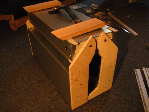

A little poke for this thread... my fake Buchla is coming along nicely. Panels are 4U high. Boats are steel, 433x178x60mm. Side panels were sketched out in Inkscape (free+open source alternative to Adobe Illustrator), a 2D program as there was no need to calculate depth. At this size, I could print each panel exactly on an A4!
Tip: a 45 degree angle for the side panels isn't quite enough to keep the thing from teetering on the edge of slamming shut, so I will be shaving a few degrees off them. When I get around to updating the Inkscape file, I can post either a PDF or an SVG file (which would be editable) of the project. As well as better pics.
To do:
1) Sharpen angle on wooden panels by a few degrees
2) New "kickstands" in the back to accommodate new angle
3) Purchase/mount power supply
4) Drill holes for + mount power bus boards
5) Drill + mount for XLR gooseneck lamp on top
6) Rivet boats (now only bolted)
7) Stain+finish wood
Cool Paint steel with black "hammerschlag" finish
Wish me luck!
D.

Second tip: if you want to leave your cables plugged in when you close the case, make sure you leave enough space at the point where the upper or lower boats swing over the edges of the middle boat. Looking at photos online, the real 200e doesn't look like you could leave the cables plugged when it closes. Can anybody confirm or deny that?

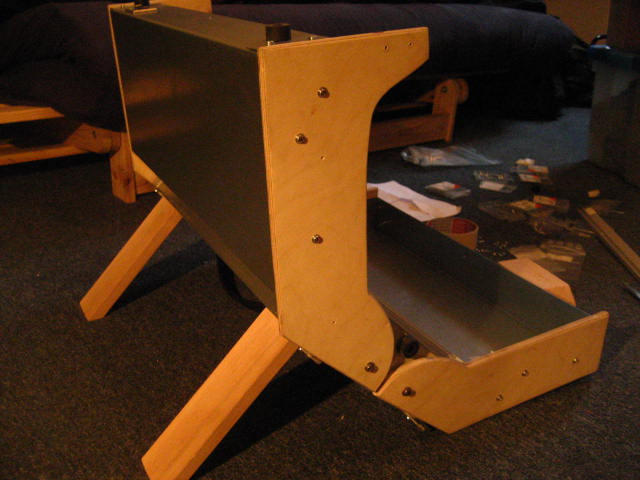

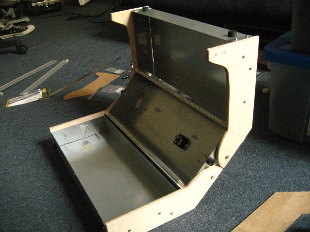

OK, I shaved a bit off the angle of the side pieces, but I'm still not happy. Initially I figured it would be ~45 degrees, but then the top boat still stands pretty much straight up, when it should lean back.
I guess any owners of a real 200e probably won't be reading this thread, but if they are, could you please measure the angle of the top and bottom boats respective to the middle one? This part is driving me crazy!
You can see in the pics that it stands very straight up. That has a couple drawbacks:
--the legs in the back have to be longer
--the middle boat isn't entirely stable. By pushing on it's lower edge it tilts...although I did finally see the flanges for the locking bolts on those little metal tabs at the rear of the middle boat: http://www.synthi.se/bcab/b4.jpg.
The wood I used it a bit thin for that, I had hoped proper balance would do the trick Wink Actually considering a rubber foot in the back to keep it from tilting when open...
Hmmmmmm........

No, the angle isn't "right" because I didn't think it through enough when I was drawing it up. I could have easily made it sharper. Of course, the case still functions just fine and I could easily use it just as it is. Perfect is the enemy of just-good-enough.

If I could request one more photo, it would be a close-up of the set screws on the back side, that you mentioned lock it into place (where I thought maybe gravity would do the job by itself).
