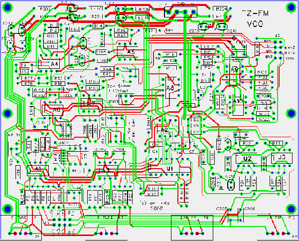

Time for another update.
I'm still beavering away at this. As soon as the PCBs came in I stuffed one, and everything worked right off. The problem I mentioned with a slight tendency for the VCO to try to sync with the modulation source was actually a bit worse with the PCB than it was on the whiteboard -- nothing like wires for low resistance. Laughing
How does this spurious syncing work? It happens when the system is near the point where a frequency reversal occurs very close to a Saw reset point. The system can either (1) reverse frequency or (2) switch, then reverse frequency, then switch back. It is very important to understand that ideally it makes no difference to the final output which path is taken! This is because to derive the final Saw from the raw Saw, the positive segments are shifted down and the negative segments are shifted up, so either path produces the same output waveform.
In practice, however, because of the finite reset time the two paths lead to slightly different frequencies (two extra switches for path (2) above). This means the system can adjust its frequency slightly by varying the ratio of how often it chooses one path over the other. Since the circuit deriving the final Saw waveform has a pair of comparitors that fire when the modulating signal induces a frequency reversal, the modulation signal ends up (indirectly) putting some spikes on the PS lines, which allows the syncing.
Don't worry if you don't follow all this -- it took me days to figure out. It is actually a very minor problem, but I wanted to clear it up. So most of my time lately has been spent figuring out this mechanism and working at cleaning up the PS noise. This has required making several changes, none of which worked by itself, but together have reduced the problem to a negligible level. Right now I've got it to where it is very difficult to tune the system to see the effect, and it now occurs only occassionally when the system has the conflict successively at the positive and negative crossover points. This would very rarely happen in normal operation, and in fact it takes me several minutes to dial in the problem area.
Right now I'm working on updating my "official" schematics, after which I am going to redo the board layout to incorporate the changes that had to be made and to further improve the decoupling between the circuit segments. I hope I can get the next prototype boards within a couple of weeks.
Thanks for all the interest in this project!

PostPosted: Thu Dec 11, 2008 1:50 pm    Post subject: Reply with quote  Mark this post and the followings unread
The new board layout is finished and in to get prototypes made. I had to make the board a bit bigger to put in the improved circuitry. Here's a lores look to give you the basic idea. I'm shooting for the end of next week to get the new build finished. Stay tuned!
Ian

10 ic's on this vco!
frijitz
Joined: May 04, 2007
Posts: 1734
Location: NM USA
Audio files: 54
PostPosted: Fri Dec 12, 2008 7:33 am    Post subject: Reply with quote  Mark this post and the followings unread
Sad 13, actually. Sad
About half the board is used for the variable sync and for the Tri and Sin waveshapers. Some of that could be left off.
Sad Even worse, there are quite a few special parts. Sad
Still, the core isn't larger than in other designs, that I'm aware of.
And you can always get a ZO instead. A great-looking design, and worth every penny, IMO.
Ian

I have been following this closely as a TZFM VCO is something that I just need to have a play with but I just can’t stretch my funds to the Cynthia ZO
Ian
I’m intrigued to know what the Special parts are
And keep up the fantastic work Ian

frijitz
Posts: 1734
Location: NM USA
Audio files: 54
PostPosted: Fri Dec 12, 2008 2:47 pm    Post subject: Reply with quote  Mark this post and the followings unread
That's a fair request.
1) CA3280 OTA. This is the heart of the VCO. I tried an LM13700 but it was quite a bit inferior. Bridechamber is stocking the 3280, and I have a large stash of my own, which I will let Scott have if he needs more.
2) VN0104 MOSFET. Two of these are used for the integrator discharge switches. The switches have to swing a large voltage, due to the bipolar signal, and the low capacitance of this device makes a big difference in the reset signal. They are not rare or expensive, really, probably just a bit unfamiliar to most builders. 42 cents at Mouser.
3) A pair of matched 4.3V zener diodes. Buy 10 or so, measure their breakdown voltages and pick the best pair.
4) One pair ea of LM336-5 for the subregulated 5V supplies.
5) One pair ea of 3.3V zeners and 5.1V zeners for comparator decoupling.
6) MAT03 matched super transistor pair for the expo current source. SSM2220 is probably OK and has the same footprint. I've been using 2SA798, and the board will also take that.
7) One OPA2227 precision opamp for the expo converter circuit. OPA2134 would be just about as good.
#eight) 2 ea OPA134 and 2 ea OPA2134. Where low leakage/high speed are needed.
9) 2 ea LM311 high-speed comparators. For the two ramp resets.
10) Other opamps: 1 ea TL072 (or similar); 2 ea TL071 (or similar); 2 ea LM741 (for spike reduction).
11) 2k 3300 or 3500 ppm tempco resistor.
12) 6 ea ferrite beads. The power supply is split into three separately decoupled branches.
13) +/- 12V power supply. That's all I can support right now. I'll try to eventually do a +/- 15V version, but I don't want to give suggested changes without trying them out. For sure, the 5.1 and 3.3 V zeners will need to be increased, probably to 8.2 and 6.4 V.
I hope this helps for a start.
Ian

PostPosted: Sun Jan 04, 2009 5:40 pm    Post subject: Reply with quote  Mark this post and the followings unread
Latest results:
As I mentioned before, there was a small tendency for the system to rattle and/or phase lock a bit when the modulation frequency was very close to the carrier frequency, and when the waveform reversal level was very close to the switching level, and when the modulation depth was in a certain small range. This would rarely occur in practice, but I wanted to get rid of the problem as much as possible.
When I got the second prototype board hooked up there was still sometimes a bit of jittering. I eventually figured out that the cause was a slight difference in the voltage range of the up and down ramps. Readjusting the special charge injector circuit for better compensation of the reset charge injection got rid of the problem. So I think the circuit is quite reliable now.
I also found that I could have problems when there was noise pickup on the CV input leads and when the two VCOs were on different power circuits. The user will have to deal with these effects on an individual basis. But I imagine that if you want the two VCO frequencies to be the same, you will use the sycn feature anyway.
Yesterday I started measuring the temperature stability. First I looked at just the core oscillator. Surprisingly, the core drift is very small -- something around -60 ppm/K. This will probably depend somewhat on the properties of the actual components used. Anyway, it looks like this is going to be a nice stable unit. Next I'm going to test the drift of the whole circuit. With an accurate tempco resistor it should be very good. The OTA modulation block shouldn't add any drift, since I have the linearizations diodes biased on. But we will see ...
I don't think there are any other issues to address. The schematic drawings and the board layout need some minor changes, but I'll check all that carefully so I don't have to do another prototype run. (This gets expensive!)
Hope everyone had a good Holiday season!
