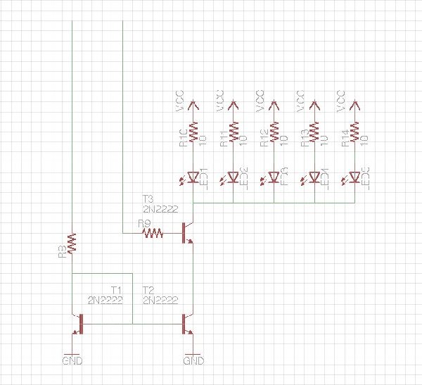

Mom wants me to make a circuit board that is a peace sign with white LEDs on it. I'm posting to Schmooze because it's not a music project and i feel very Schmoozy on this lazy Sunday afternoon.
She drew a 6" peace sign in the air with her finger and said to make it with white lights. Also to make it play hippie music if possible. She says with the new trend in 60's revival it will sell like hotcakes, but i'd just like for her to have one.
So I'm thinking of doing yet another project, a circuit board that's routed into a peace sign with dozens of LEDs on it. Maybe even with a solar cell behind it and a battery so it charges during the day and lights up all night.
I dunno, mom suggested it so I thought I would schmooze away. What do you think?

Hey Rych and all,
I'm feeling productive this morning (made a ChucK accelerometer tambourine and a ChucK lunetta simulation earlier) so I thought I would get started on the Eagle schematic for the peace sign. It just has the microphone and a dual inverting opamp stage using an LM324. What's next?
Les
Screenshot of the schematic for your convenience

Some more thoughts:
Routing out the four interior chambers would be OK, but then we have the problem of where to put the batteries, the circuitry, etc. Now I'm thinking that we would be better off leaving the whole thing unrouted except for the outer round routing cut. I mean, it's a peace sign, it should at least be round. Then the batteries can go, say, in the upper left panel and the circuitry in the upper right, with the microphone just right of center - or better put the mic at the juncition in the middle.
For filters I'm thinking that we should go with active filters perhaps. Simpler though would be an RC low pass, an RC high pass and an active band-pass or even LC band-pass. Then obviously we control the RGB intensities with those three signals.
Just doing that, however is not dazzling enough! It would just flash on and off when you talked, which is OK but I'd rather see the LEDs blink around somehow. I once worked on ring oscillator networks. You can make arbitrary networks with them, not just rings. Meshes and such. So maybe we have some delay element like a 555 or an RC followed by an invertor, then arrange them into a ring network of some sort.
We'd have to pay attention to details like making the number of LEDs in each branch a prime number or something, but we can do simulations in Spice and/or ChucK to make sure it will work before making boards.
Comments?

Latest thoughts:
o We can vary the brightness of the LEDs with voice using current mirrors. These can be switched so that they also pulse.
o It would be kewl if we could vary the frequency of the flashing with the voice somehow. I figure using a quad of relaxation oscillators with modulation inputs would do the job. That gives us four LED blinking rates to spread around the board.
o another option that sounds perhaps better than the relaxation oscillators is to derive the blinking rate from the voice itself. One LM324 opamp in comparator configuration squares up the amplified voice, then a clock divider chip divides it down. We might have to low-pass filter the signal first or whatever.
Just some thoughts...
Joined: Oct 13, 2007
Posts: 6221
Audio files: 267
PostPosted: Tue May 19, 2009 7:55 pm    Post subject: Reply with quote  Mark this post and the followings unread
Awake after some naps and a most excellent electro-music.com radio show by Bill (State Machine) and friends, I thought I would put a little time into the peace sign project. The circuit shown below is a current mirror with a separate on/off control.
I show five LEDs which could really be any reasonable number of them along with some current sharing resistors which I am not sure are necessary. You put an analog voltage into the current input and it generates a current which gets mirrored to the LEDs. Oops - I need to add a resistor at the emitter of the left transistor to accomplish current multiplication, I'll do that.
The idea here is that we could have several such circuits driven with rectified and low-pass filtered versions of the low-pass, band-pass, and high-pass components of the amplified microphone signal. These would drive the red, green, and blue LEDs respectively to match the audio frequencies with the optical spectrum frequencies.
Oh, one other feature might be to place the on-off switch at Vcc so that the switching can be all mixed up among the different colors to increase the dazzling effect. I'll make that change...
In other plans, I talked to mom and the three-inch board size is good because it keeps cost down and makes for a wearable jewelry pendant. It took us four or five decades, but now every hippie can have a blinky voice-responsive necklace pendant, lol!
I'll keep working on it tonight and post if I make any good progress...

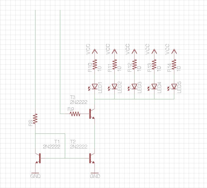

OK friends, I made a little bit more progress. In the image below you see three topside switches that will receive digital blinky signals, turning the LEDs on and off. Then there are three current mirrors each driving six LEDs, one for red segments of a six RGB LEDs and one for green and one for blue. The current multiplying resistors are in place.
The LEDs of each current mirror are alternately connected to the blinky switches so that they create a dazzling display. Not shown is the microphone with dual opamp amplifier circuit and the filters and oscillators. The way they will work is as follows:
First order passive low-pass and high pass filters get rectified and low-pass filtered so that a slowly changing pair of optical intensity signals get produced. then also the entire signal gets rectified and filtered, producing a total signal from which the other two are subtracted. If this works, it will remove the necessity of a band-pass filter and will produce a midrange intensity control as well.
OK, then we will have a set of three relaxation oscillators with their ground reference replaced by control signal inputs so that they become VCOs. When the low, mid, and high intensity signals are low, we get slow oscillation. When they are high we get fast oscillation. These outputs drive the blinky switches in the upper left of the illustration. That way when the voice is low, the LEDs blink slowly and when it is loud the LEDs blink quickly.
So the end result is that we get lights that get brighter and blink faster when you talk into the mic, plus the blinking and the colors are mixed such that things seem all scrambled and dazzling. I think it will work. Of course, someone else like Rych might have a totally different concept of how to do this and I'm certainly open to other approaches. I like this one though because it only requires three LM324 opamps and a few 2n2222 transistors, plus discretes and LEDs. Many of us will already have the parts on-hand.
I'm just recording my thoughts here for my own reference later and for your entertainment, lol. Enjoy!
Les

Yer cookin, Les! Good entertainment Wink I keep waiting for Rich to chime in with another track on this...
I think you need an envelope follower controlling the overall rate of LED flashing.
The louder the world is around you, the more the medallion around your neck demands attention ...the flashing building up faster and faster...brighter and brighter...to a fevered pitch until you reach a certain threshold where all the smoke leaks out and disperses the crowd.
Conversely, as your personal space quiets...and the world mellows out - You and those around are thinking only pure thoughts... Now the peace sign reverts to an almost cosmically pure state - at one with its surroundings - the LED's alternately pulsing and beating like the heart of mother earth calling fellow travelers to a unity of oneness with all creatures.

Thank you wmonk for drawing up that schematic for us! Maybe we can use it to make a smaller peace medallion in the corners of the big one or something? I don't know.
Folks, wmonk is a frequent visitor to the chatroom and a new ChucKist. I featured him as the ChucKist of the week because he said he was inspired by The ChucK Show, immediately learned the basics of ChucK, and made some kewl tunes within one hour of downloading ChucK.
