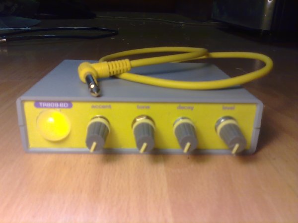

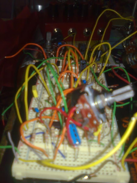

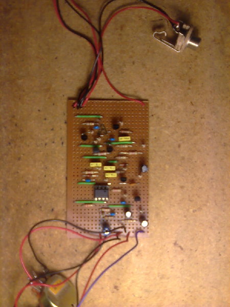

Here's some photos taken with a phone of the evolution of this project. Put it into a box this morning:

masterfader
Joined: Mar 11, 2010 Posts: 2 Location: chicago
Posted: Mon May 03, 2010 12:14 pm Post subject:
Nice pics(minus)!. Looks like a work of art. Anyways to answer your question. I'm feeding the (accent) input of my 808 bd circuit with trigger out from my 606. I leave the 808 bd trigger in circuit alone. hope this helps. |
